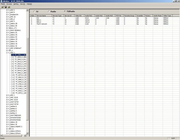

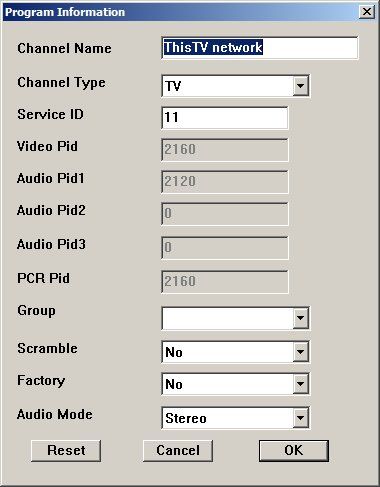

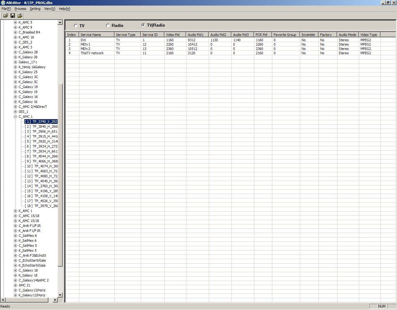

What are the correct values to enter in the openbox channel editor to get ThisTV on 103W / 3740V ? The values listed on lyngsat do not work for me.
I can get good signal and all the other channels on this transponder, but lost ThisTV a couple days ago. After reading the posts above, I played around with the PVR800 channel editor downloaded from this site, and got the video, but no audio, then messed about some more and lost the video again. As other have noted, blind scanning finds nothing.
ME 1
V 2260 A 2220Dolby D Pid 2260
Me 2
V 2360 A 2320DolbyD Pid 2360
This
V 2160 A 2120DolbyD Pid 2160
That's the best I can tell with the S9
Don't make sense to "hide" them as they've been here, like, forever.
If you used to have them and erase it , or if you have never scanned them, you will need to add it using the Editor. Make a HDS2_DUMP copy of your system on your pen drive (assuming you know how to do this). Open the Editor, FILE, OPEN, change the FYLE TYPE from *.udf to *.abs then look for the dump file in your computer address (HDS2_DUMP.abs), OPEN, PICK USER DATA BASE, under Use ALL SERVIVE, SATELLITE INFORMATION at left column look for C_AMC 1 (hit +) will list all TPs. Look for TP 3740 and hit over. It will list the available channels at right. Below the last one channel right click into the next available column. A pop up screen will appear click INSERT CHANNEL, ADD ThisTV PIDs info, make sure your pick AC3 on audio type 1 and STEREO in audio model, save each channel (THIS tv, ME TV 1 & METV 2)by hitting OK .
To finish, FILE, EXPORT change fyle type from *.ddf to *.abs. Hit SAVE, system will tell you that the file already exist and ask if you want to overwrite hit YES, and pick USER DATA BASE and you're DONE. Load back your HDS2_DUMP file to your box!!

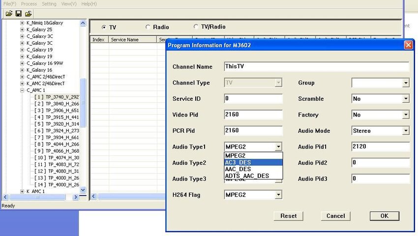

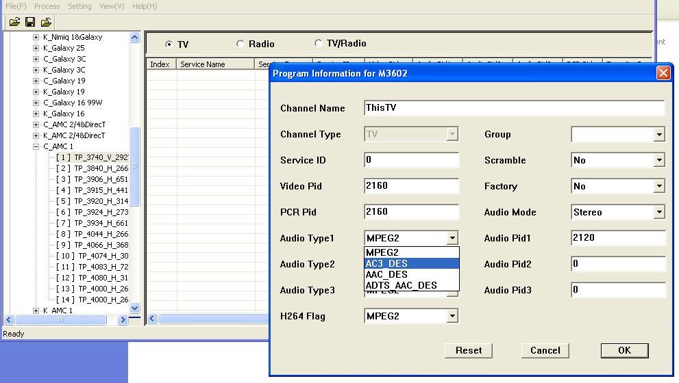

Thanks guys, I got the video back. Don't know what I did wrong, but deleted the channel and re-entered the same values I had and now it works. No sound though. I don't see anywhere to select AC3 as audio type in the editor I have.
Maybe I will try renaming and changing the PIDS on DW or MeTV2 which have AC3 sound also.
No luck renaming DW. I noticed that Metv and MeTV2 no longer show up in a transponder scan either, but mine still work with the saved channel info.
You need an update version of the editor. PM with your e-mail to send you a copy
