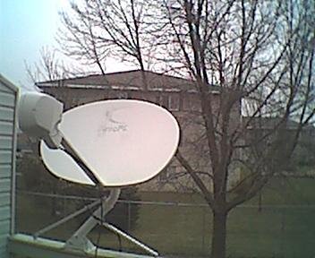

yes the LNB will be fine...just bypass the transmitter. On the LNB itself there should be a coax...lemme try and find a few pics of mine

I have one of those dway dishes, mine's the fiberglass/composite looking material, and tis very heavy. If you were to take off the transmitter, and the mount off the back you could probably make it work. I would take the dish off the mount and weigh it, leaving that azimuth-adjusting part on there, because it is handy for setting the proper 'skew' on the dish. A strong motor like the DG380 would most likely handle it ok, with a home-made bracket. Search the other threads here on "motorized primestar" and you'll see some examples of how people have built their own simple brackets to attach that type of dish, and primestar dishes, to an H-H motor with minimum total weight. And, mine did great on 97, and 123.
