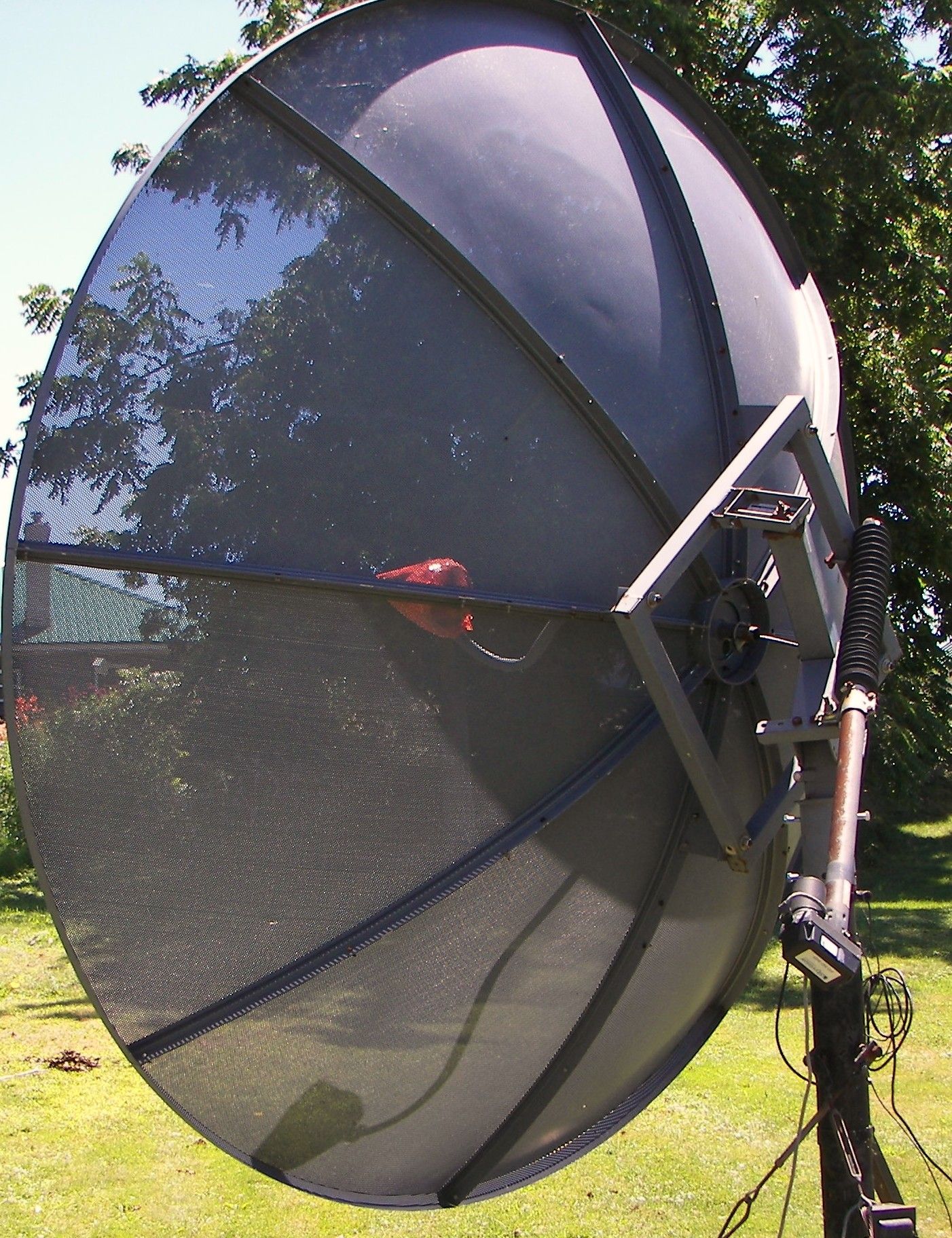

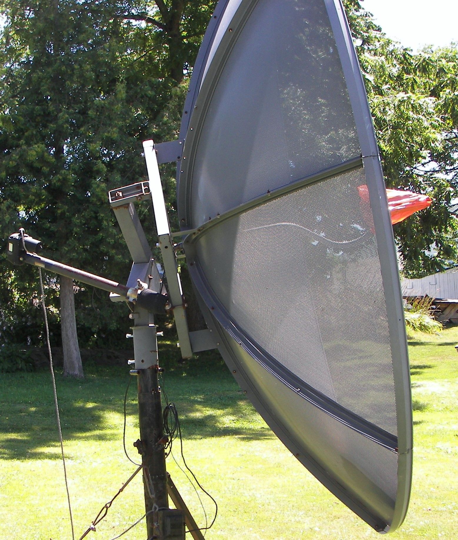

24" actuator is more than sufficient for a Pinnacle.As far as button hook vs quad,the button hook on a Pinnacle so short and stiff,sagging isn't really a problem.
