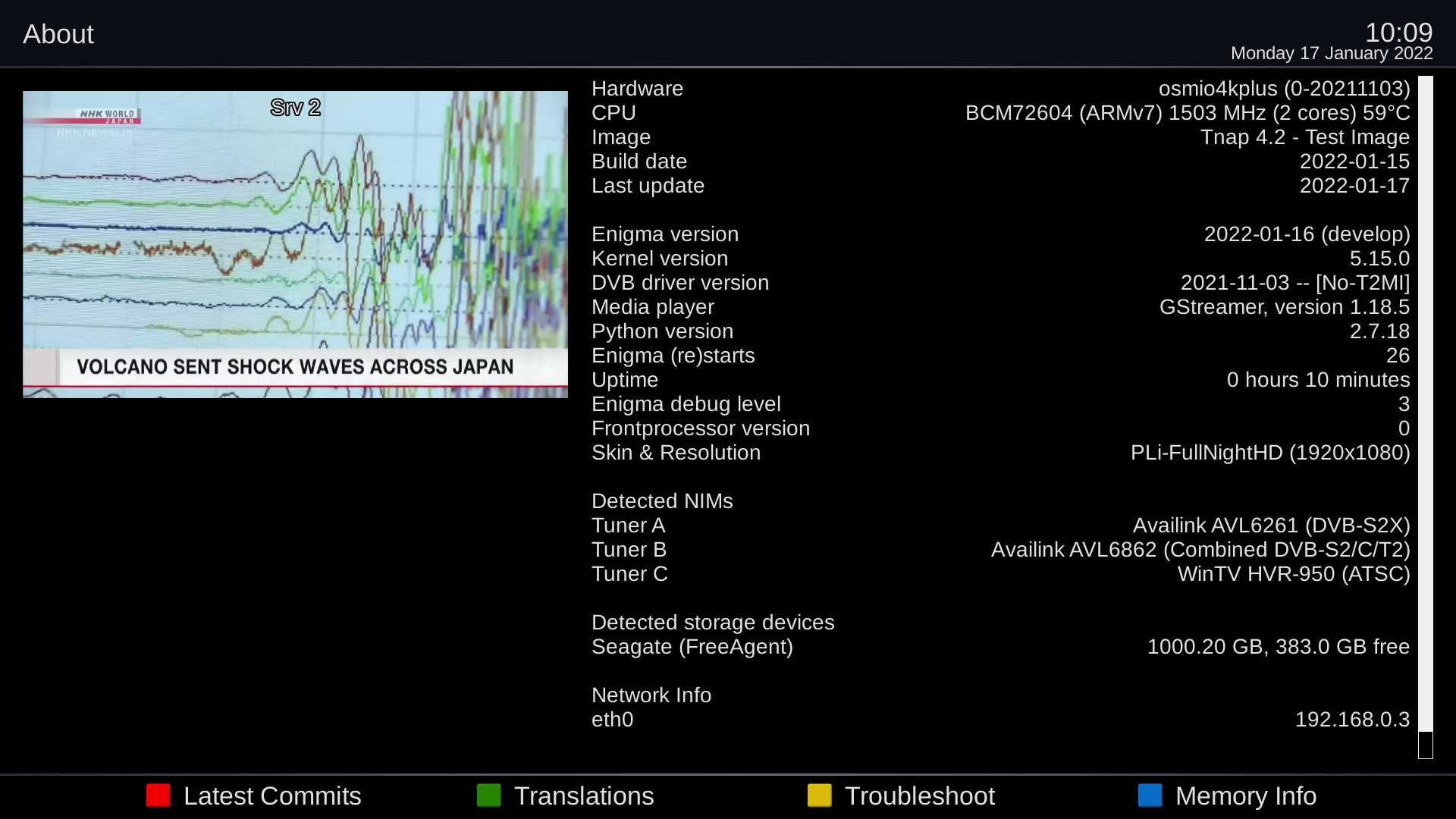

TNAP 4.2 -Test Image 2022-01-15 (updated 2022-01-17) is loaded and running. I did a clean installation without using my old database. Therefore I had to configure everything and re-scan all satellites. I like to install this way so as not to contaminate a new installation with anything from the past.
My very first impression is that the blind scan works very well. Maybe it was due to the strong Ku signals last night, but each blind scan picked up everything active on each satellite. I have already done an online update two times.
There is something new called "AutoBouquetsMaker". It seems to allow you to schedule scans and, presumably, update your bouquets without any intervention from you. We need to learn more.

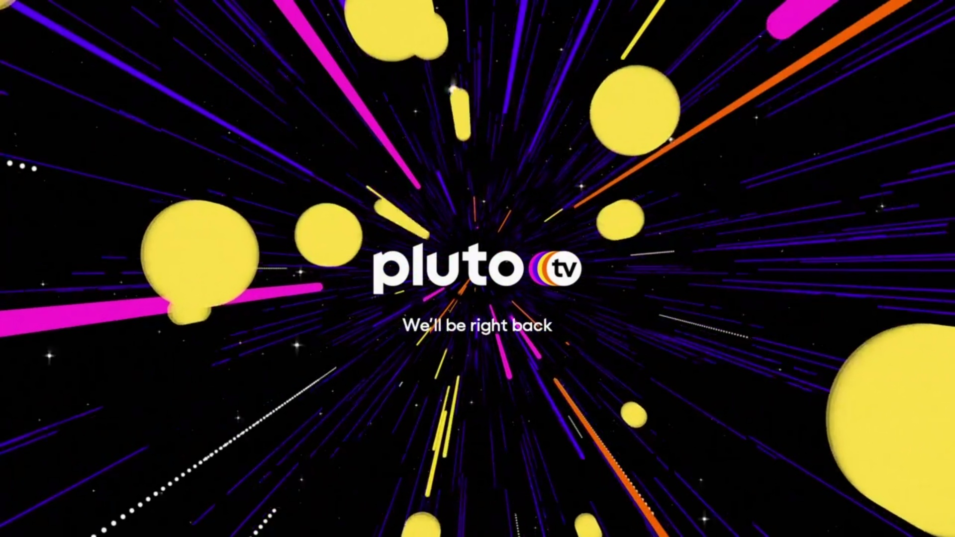

Pluto tv Plugin is now available on TNAP 4.2 in Download plugins + extensions. Thanks goes to el bandido.
Been testing it out for a few days on the Mio4k and VOD works great but the live channels do sometimes freeze and changing the channel then go back will fix it and also found press the Play/pause button a few times will fix when the video and audio get out sync that doesn't happen alot.
If you install the Pluto tv plugin the first thing to do after the install is do a restart. I did not do the restart and had a little issue and after the pluto tv bouquet-epg-picons download it hung and I had to issue init 4 command wait a few seconds then init 3 to restart. So make sure to restart the box after install of the Pluto plugin.

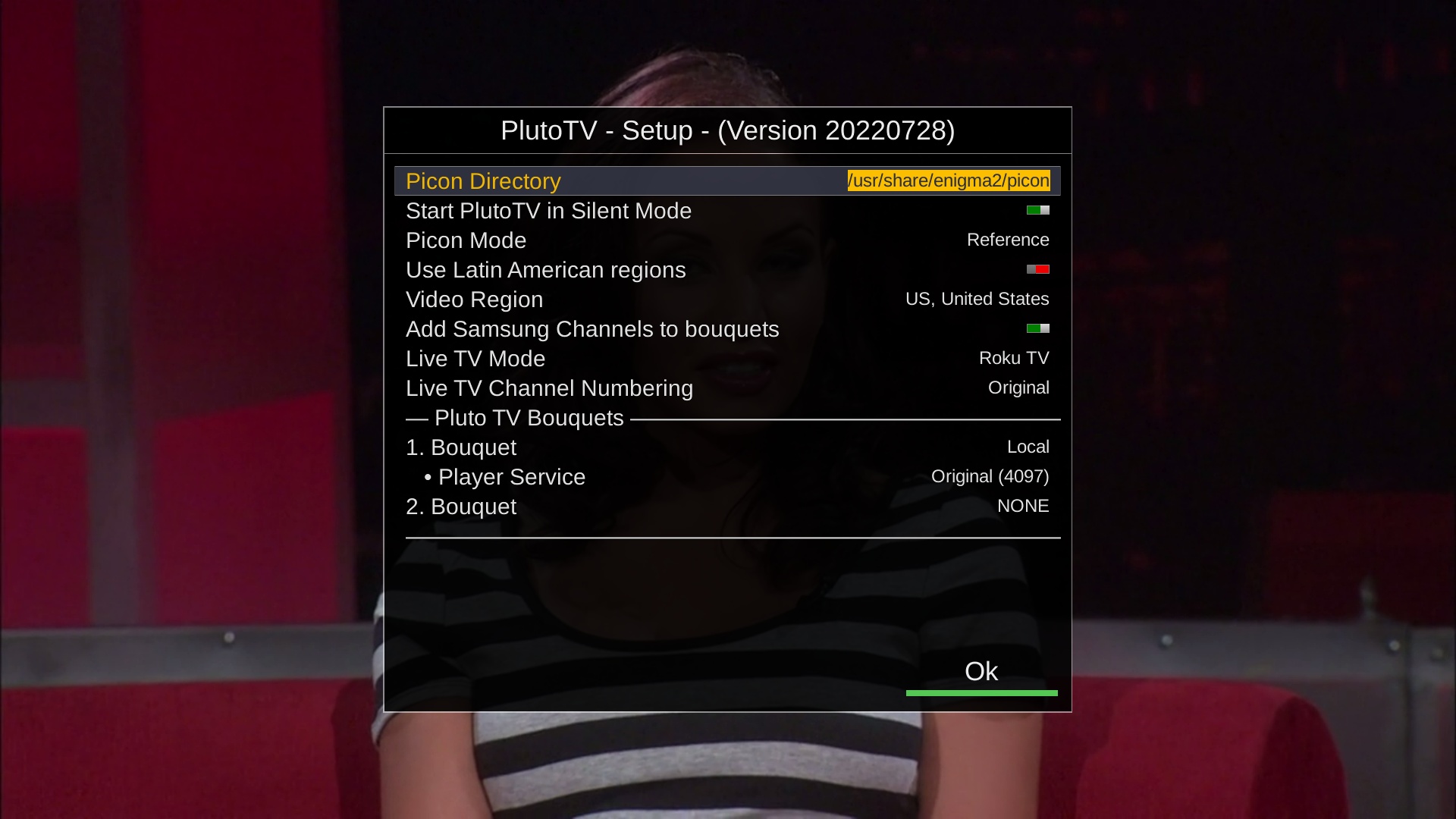

After the restart go to plugins and launch the Pluto tv plugin after the screen loads press the menu button on the remote the settings will show now change the video region to US, United states or what ever region you are in. You can also change Live tv mode if you want the default is Samsung TV but I am using Roku TV because the advertising ads seems to work better. But that is your choice. once the settings are set press the green button to save.

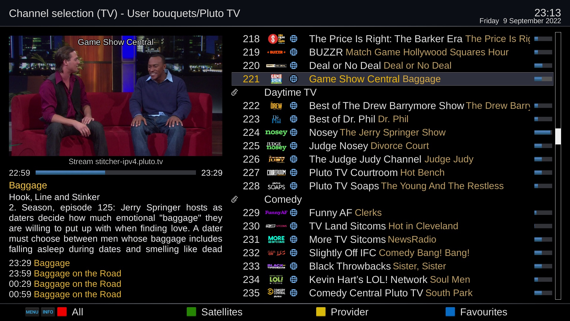

Then press the green button to start the download of the bouquet-epg-picons.
Channels will play like IPTV and you you find the channels in PLuto TV bouquet channel selection screen.
