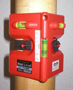

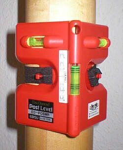

You need a pole with an od of 2". Some use muffler pipe, which is 2". Others use 2" fence post, which is actually slightly smaller. I used it and it works well, but you have to use some flashing to make the diameter large enough to properly tighten the mount. Make sure to dig to the frost line in your area and either flatten the end of the pole or run a bolt through it to keep it from spinning. Use at least two bags of cement, the quick setting type is easy to use. Check carefully to get the pole plumb. This is very important! I'll post a picture of a post level, which is the best tool to use to make sure it's plumb. After the cement sets simply transfer your dish from where it is to the new pole. Aligning it by eye for the azimuth will likely get it close enough to get a signal on 101. Then carefully move it left and right until the signal strengths on 99c and 103ca/cb are the best you can get them.
