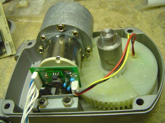

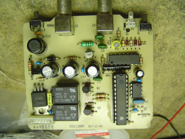

autopsy photos
not my motor but archive photos.
I have taken mine apart tho,the 2nd day I had it.
I had to disconnect the coloured wires to get it to work again.

My SG2100 was miserable in cold weather, the only way to make it move was to warm it with a propane torch then it would work fine till it cooled. I later replaced all the grease inside with lithium but never did hook it back up.
