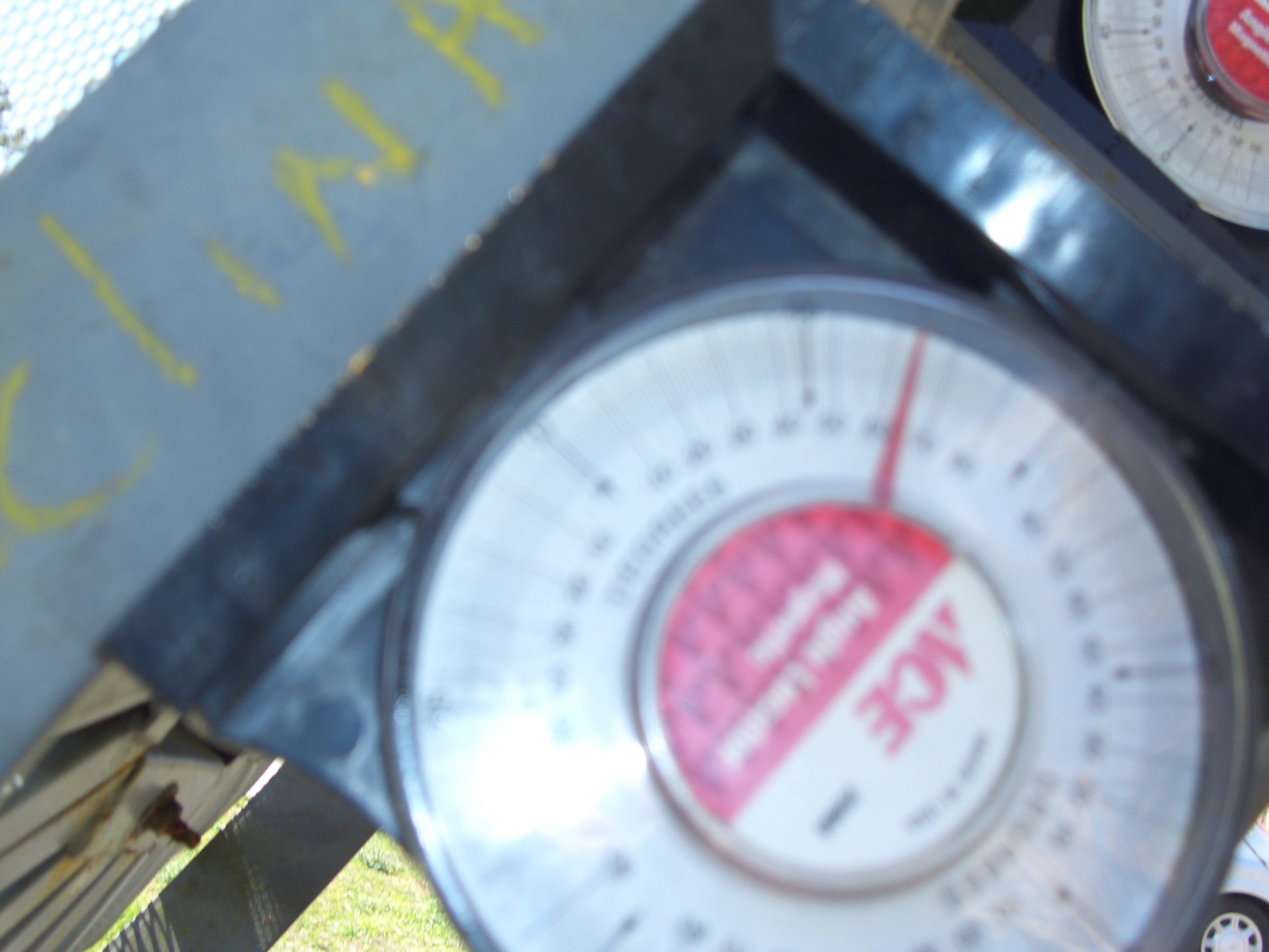

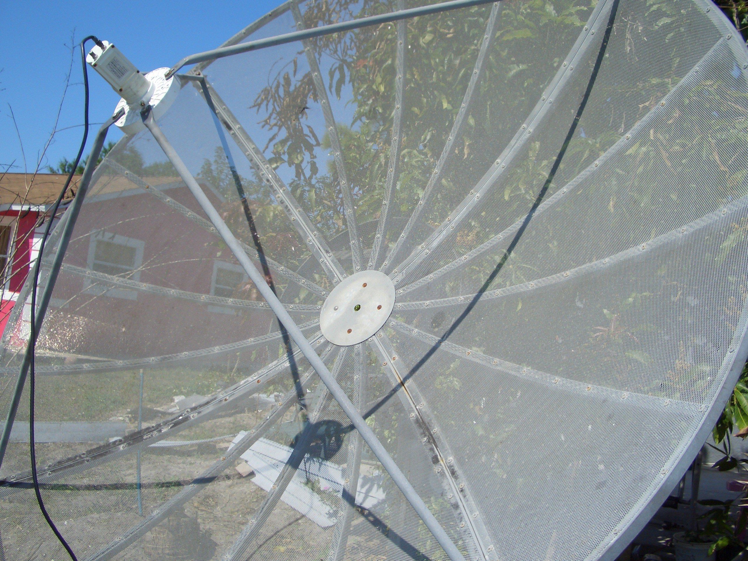

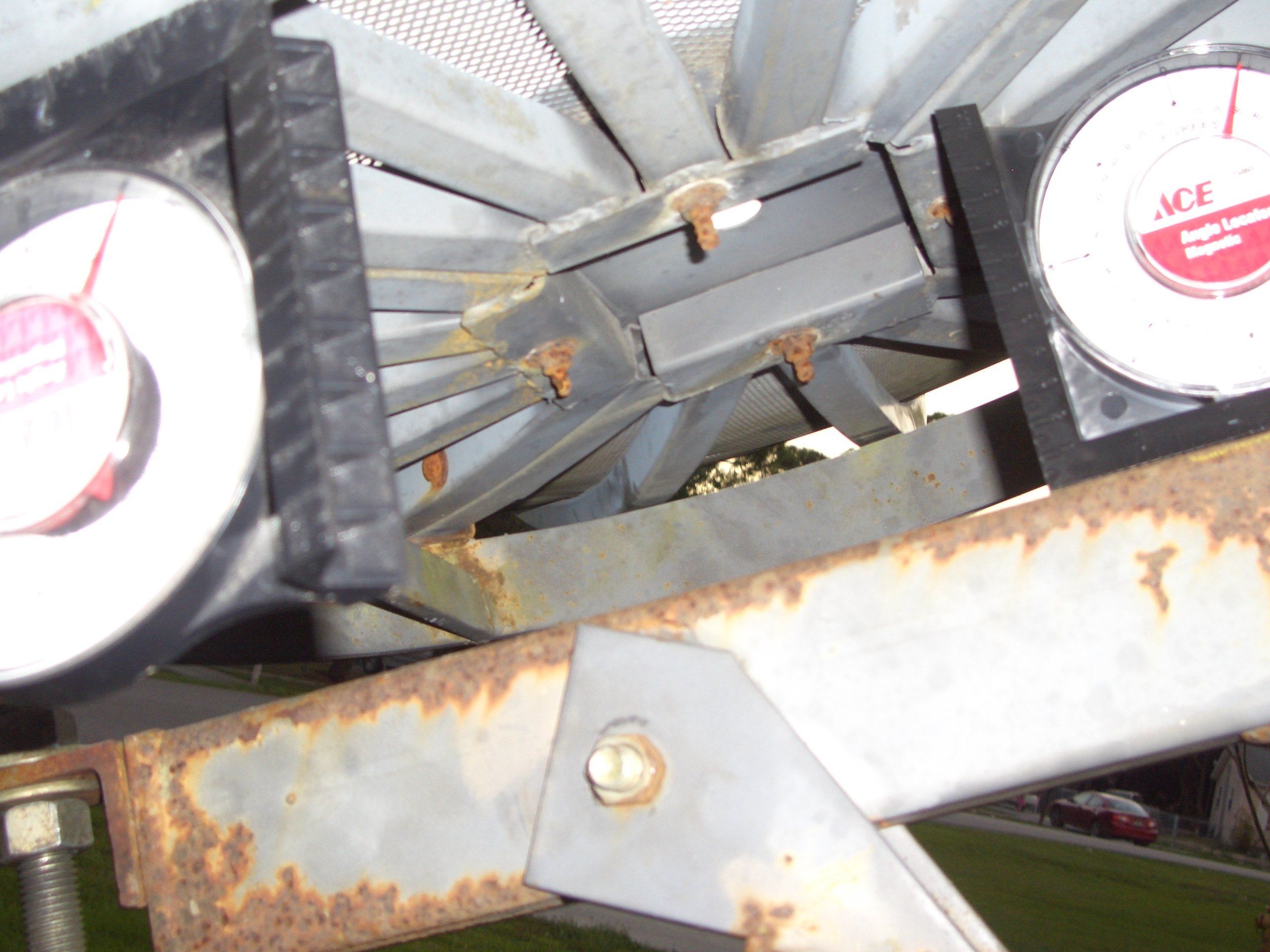

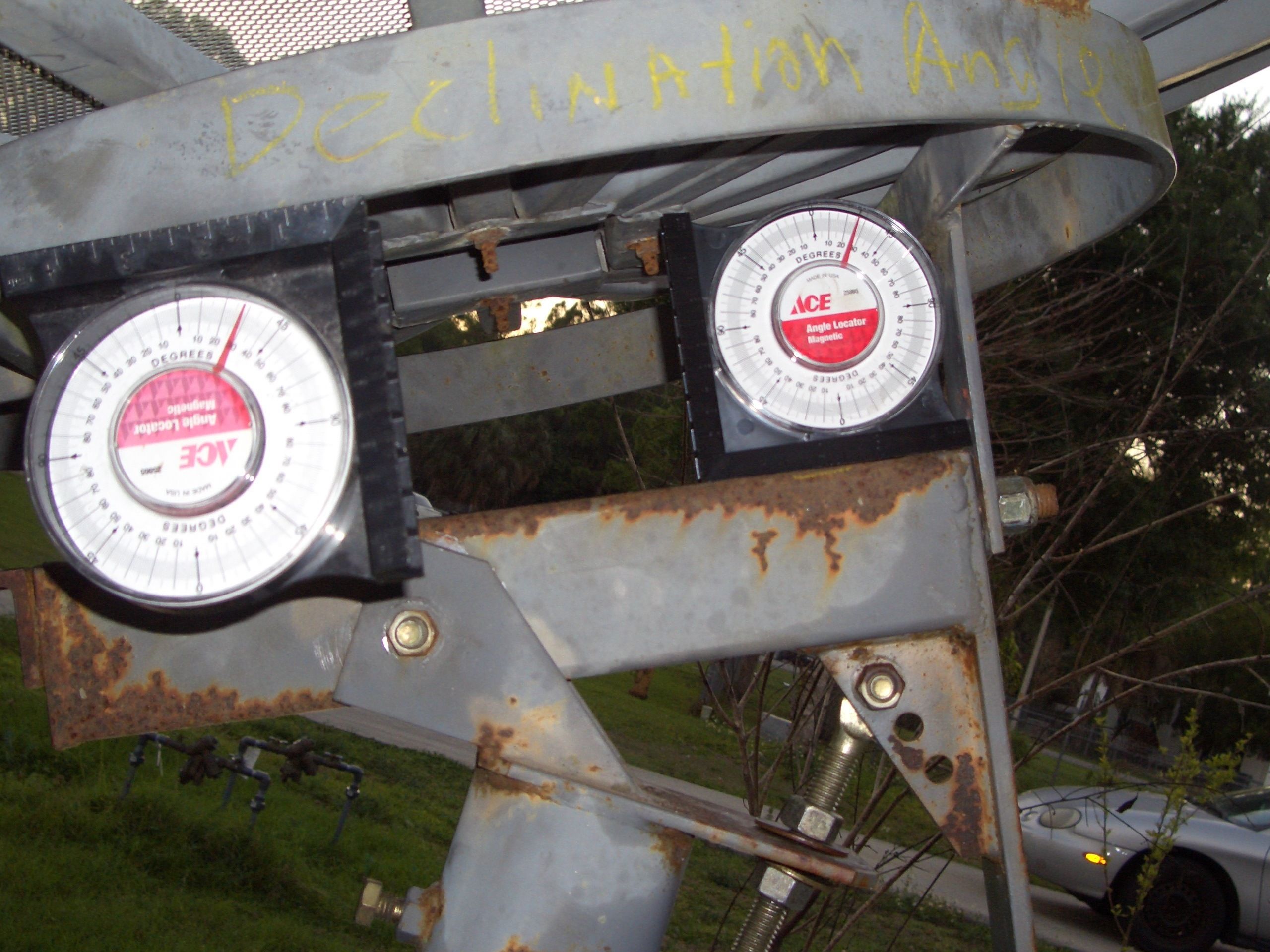

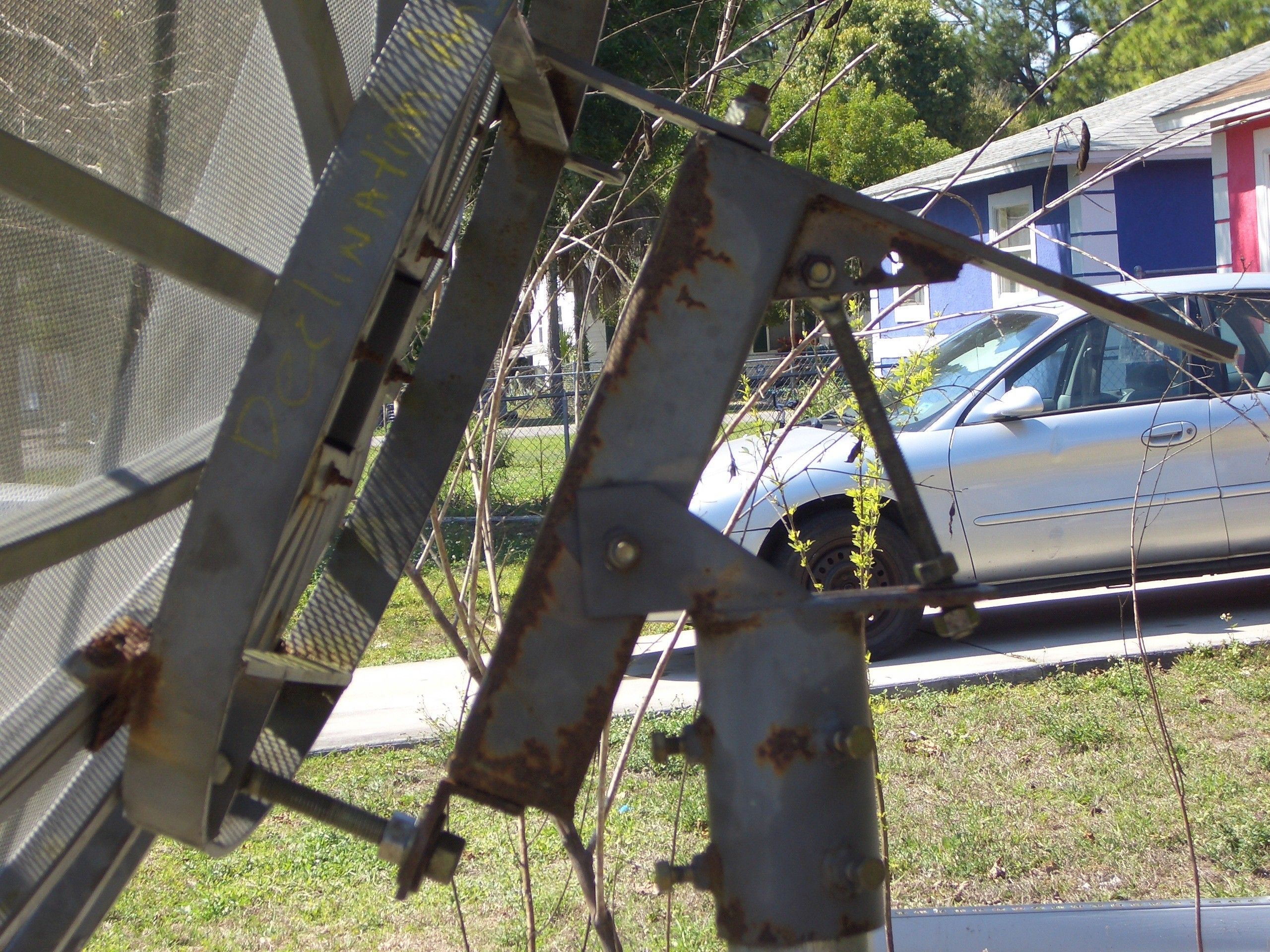

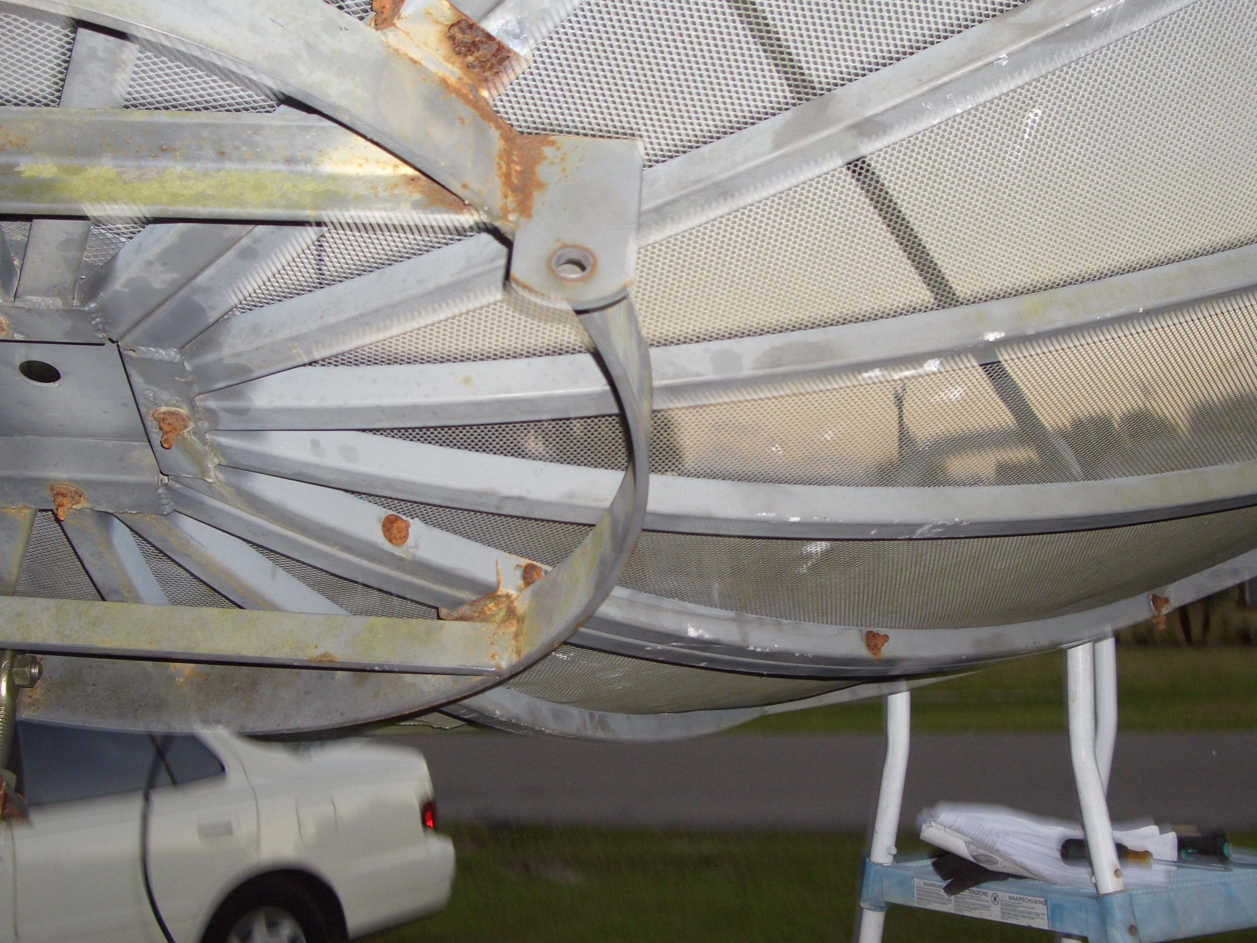

I have a 6 foot dish I got for free. I'm trying to lock on 99.0w Galaxy4R/c. My latitude is 26.4N,Longitude 81.4 The 6 Foot dish won't be motorized for now. I used the Latitude/

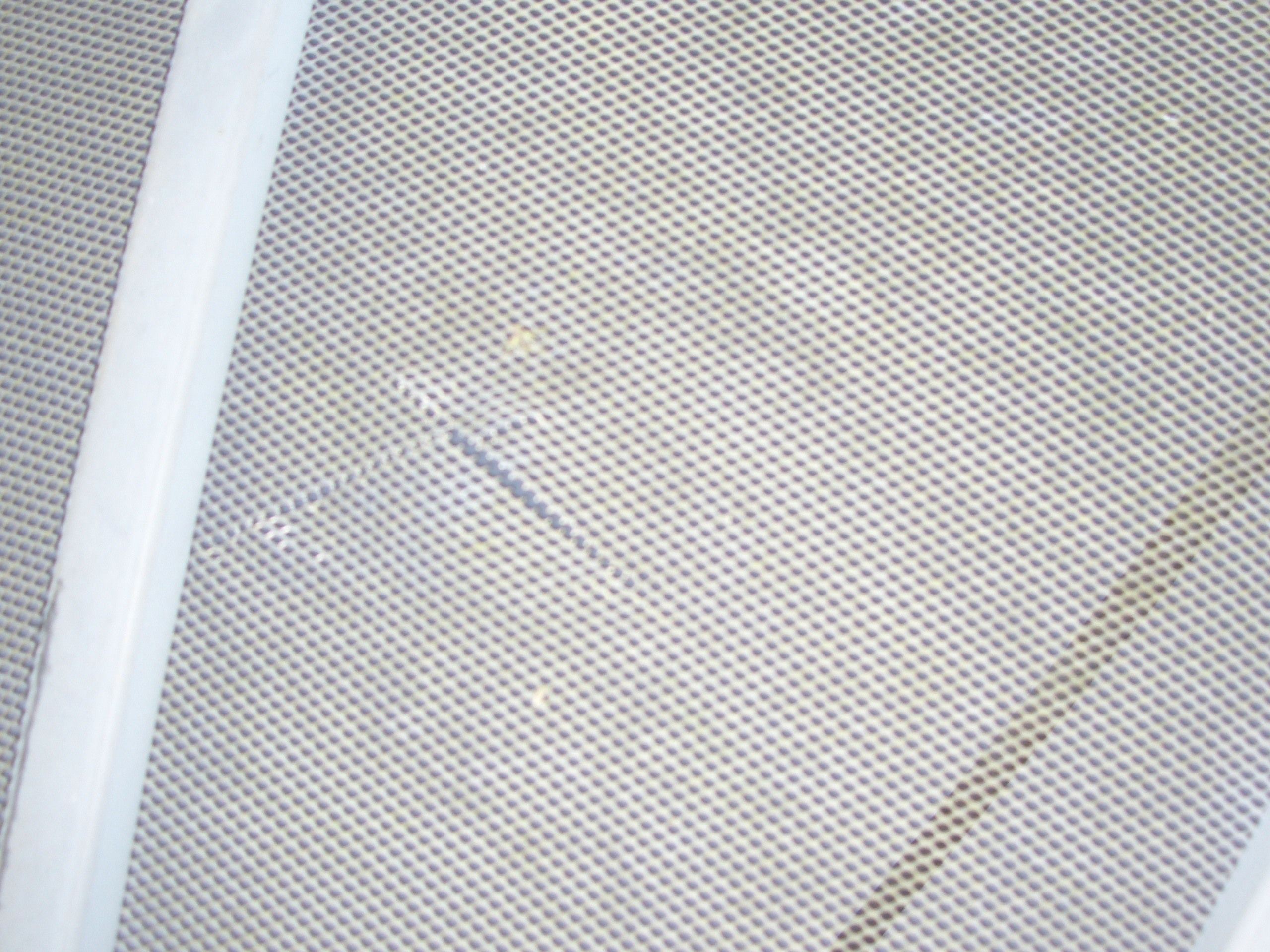

Declinatin chart form www.Geo orbit.org the second page that shows the modified polar mount.I put the elevation at 26.56, using the chart I added 26.56 with 3.81(Declination offset angle) to get the declination angle. To make a long story short. I couldn't get 99c. On the 6 Foot dish,some of the panel a little tear. Do you guys think that the dish is still good? Am I doing something wrong?

your elevation is way off. Since its a fixed dish I dont think those numbers you use. When I plug in your location to thelist's aiming chart I get
99.0°W Galaxy 16 C/Ku
53.5° elevation
221.4° azimuth
31.4°L skew
Your elevation needs to be way higher. I'm in Minnesota and that elevation is 38 for 99W. That little tear wont hurt most signals.

I'll use the information that you've given to me to repoint that dish.I'm Confused about the Declination adjustment, I'll try to play around with that too.
The declination and elevation angles refers to aiming at your zenith, only if you're setting the polar mount to allow the dish to track the arc while pivoting on the polar axis. If you are only aiming at a single sat, (With the polar pivot locked to center) the only angle that's important* is the dish elevation. This would be measured on the back, on the dish mount ring, or on a straight edge spanning the front of the dish, top to bottom. * skew must be adjusted by manually rotating the feed in the scalar. Then rotate the mount on the pole to acquire signal (Q).
Thanks, guys for the info. I've installed fixed and motorized ku band dishes. This is my first time setting up a C band dish. After a couple of months, I'll try motorizing the 6 foot dish.

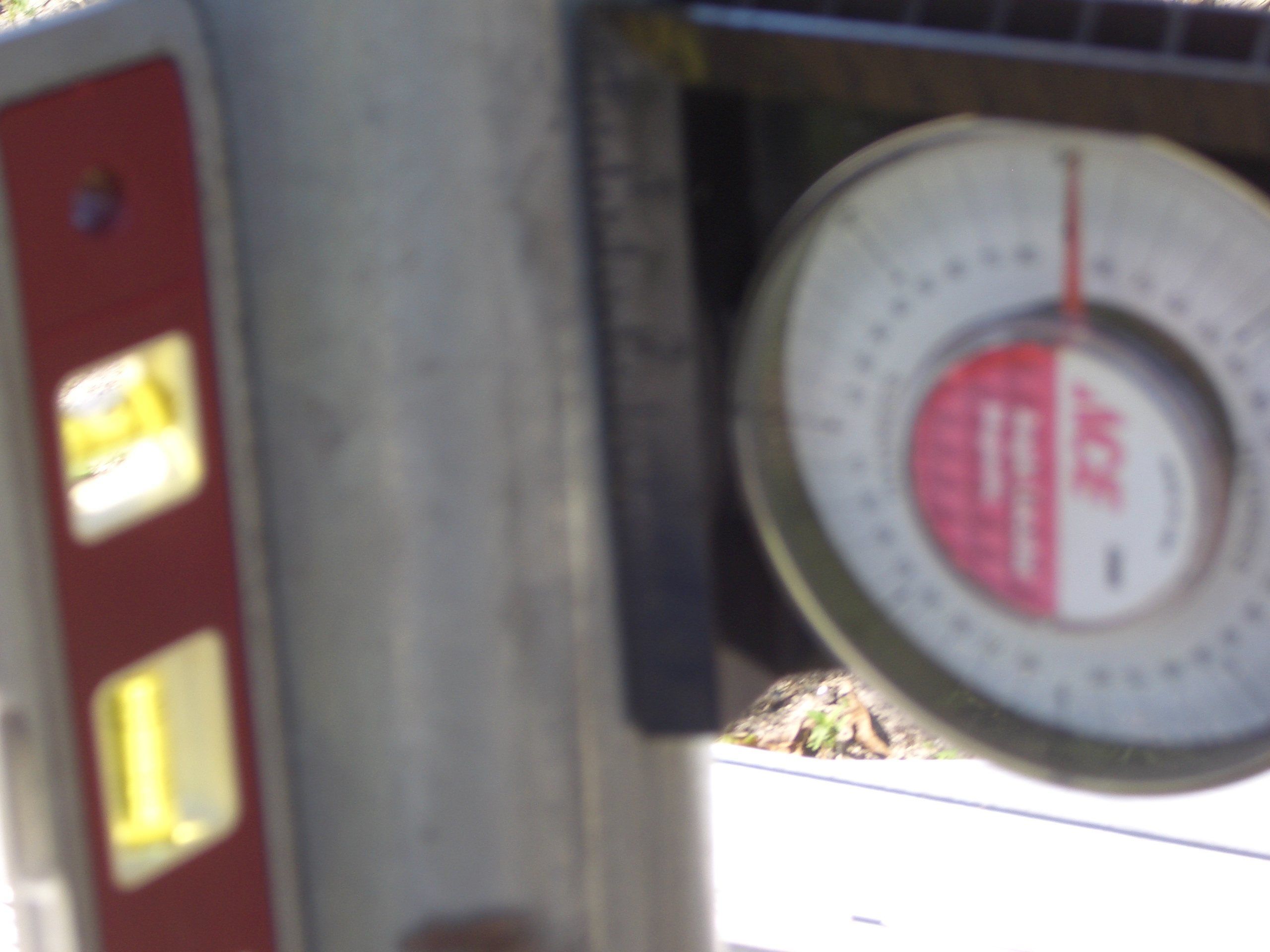

Yep, Pic #6 shows a DMX242, or similar, LNBF with an adjustable scalar(I think). My ADL also requires rotating the whole button hook. but my Chapparel and BSC421 is adjustable.
