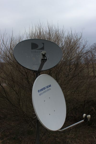

i am trying to get 117w down here in southern mexico but not having any luck.anyone know is it`s possible?
Appears it may be possible from footprint below.
Are you using an actual Orby dish or another FTA dish?
another fta dish by sky tv looks exactly like the orby dish ,linear lnb ,skew the dish not the lnb
it looks like orby uses tp`s 12 and 14
Yes, that is what's list on Lyngsat, specifically 11940 V 30000 and 11980 V 30000 DBV-S2 2/3 8PSK. I am tuning these in Pennsylvania on a modded DirecTV Slimline with linear lnbf. I used a meter to set up my dish and got signal really quickly. It does need to be spot on though, no room for error. Also, I skewed the lnbf instead of the dish. Should work either way but skewing the lnbf got me a solid signal.
