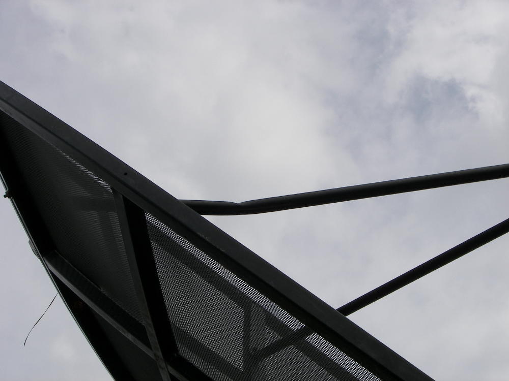

ok i got a lot of reading to do .... not sure how to tune both c & ku .... i only had a lnbf in the past...........just finished putting up my 7 1/2 mesh after welding a adaptor into place ....it picks up C band G10 great get the bluegrass music channel at 89% and shows the scrambled channels at 94% & 97 % these are with my coolsat not the 4dtv (not hooked up yet). now i switch the cable to KU and i get something ..... ok can see a promo channel for Super Dish promo at 60% SQ ..... well we did drop the dish when we were setting it up i rechecked everything and my only problem is a bent feedhorn brace 1 of 4 so i will probably have to remove and straighten.... but at least the dish is working......

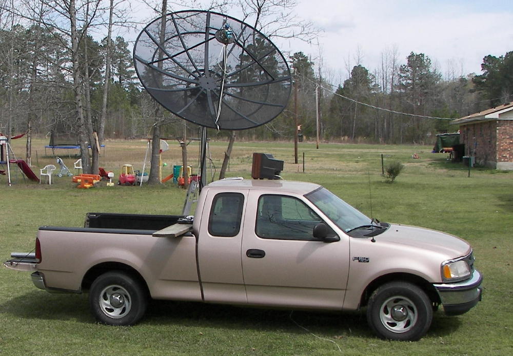

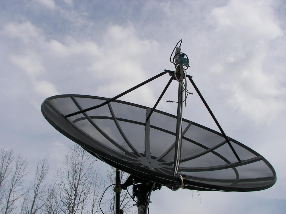

here's some photos

Hey George,
If you have the scaler/feed-horn pointed precisely at the center of the dish, have the focal distance set properly, and the f/d ratio set properly, you should be able to tune in on a Ku transponder on your TS satellite, and start peaking from there. Then swing out to a far satellite, and peak a Ku transponder there. Repeat for the center, then swing to the other side. Repeat until you have the best you can get across the arc.
When I tuned in the old Winegard, that's how I did it. If you get it peaked properly for Ku, generally the C-Band will be fine.
