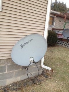

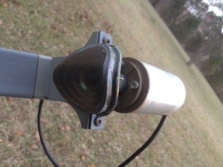

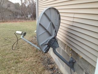

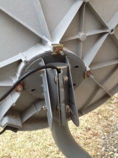

A photo is worth a thousand words... Possible to post a few photos showing the dish, rear mount, scale and LNBF?
The skew setting is critical. Is the 34.5 skew positive or negative?
You would only rotate one or the other, not both. I would set the LNBF skew to zero and rotate the dish skew rather than the LNBF.
Depending on how the scale is marked on the back of the dish, the scale may be at 90 or 0 degrees when no skew. If the scale has 90 degrees at the top, subtract the 34.5 from 90 and rotate counter clockwise for negative skew (standing behind dish) or clockwise if positive skew.
What's the LNBF model? Anything on a label on it??

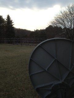

Do you remember where it was pointing before for BVN? I was wondering if you still had it marked, try moving it back and see if you can get the Pentagon Channel and tell us what the frequency readouts are. Like Titanium, I'm wondering if the L.O. setting has been altered.
Had to move the satelite from the roof because didn't have good line of sight for the satmex satelite will try to tune to this satelite and see if I get signal.

Could also be a single polarity NJR LNB. (it's really an 'unknown' now) On 101 i'm pretty sure it was vertical (ok, Northgeorgia confirmed that.) On SatMex it is horizontal. So may have to twist the LNB 90°.

Seems that your dish is not pointed to Satmex 113 W.
Members' advice to catch program (Pentagon, 101 W) is a good one.
From your co-ordinates can be concluded that you are in Shamokin or Mount Carmel area.
Raise your dish elevation to 36.6, turn to azimuth 214.8 (true) or, magnetic 226.4, skew 25.6 and tune to Pentagon.
After maxing S/Q, mark a short vertical line on your mast (J-pipe) and dish's bracket, this will be your reference point.
Next, turn the dish West, until the distance between markings will be exactly 5 mm - now, you are on Satmex azimuth.
Lower dish elevation to 30 degree, and now the dish should be pointed exactly to Satmex. Turn LNB skew to 35 degree.
Good luck in "differential" pointing. Cheers, polgyver
Since you skew all dish, keep LNB at 0

Echo 11 @ 110W is a very strong DBS satellite. I would be surprised if you didn't see it. As strong as that satellite is, SatMex is that much weaker :( . It is very possible the Globecast Dish you are using is not good enough for BVN reception. That dish was used on 97W, a strong signal. Try a different transponder on SatMex. Go for "Hope Channel" 11994 V 4340 This should be easier to find, but not much. And when all else fails, I suggest you start at the beginning and make sure that mast is plumb, perfectly vertical. This is crucial when working with weak signals.
