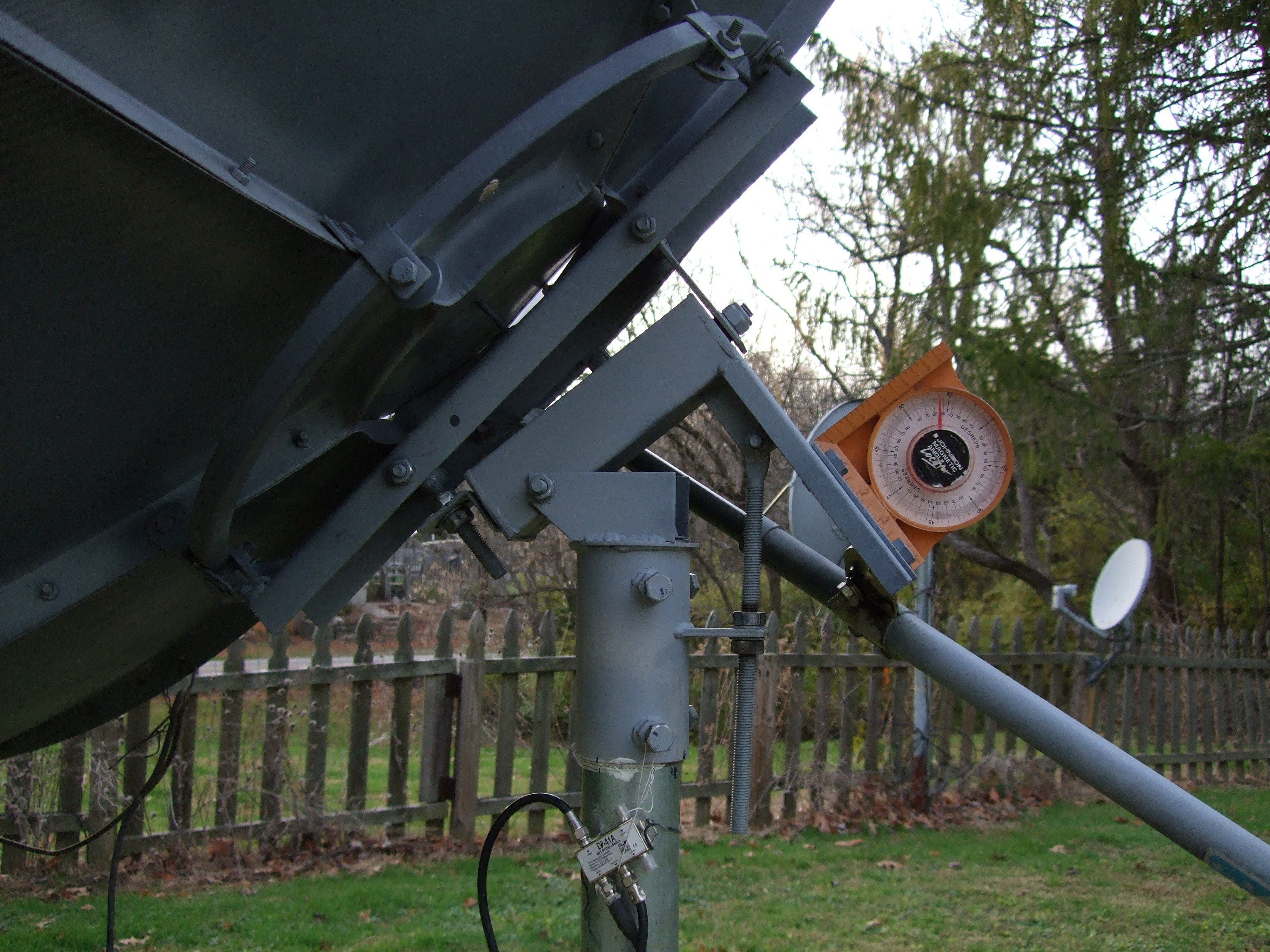

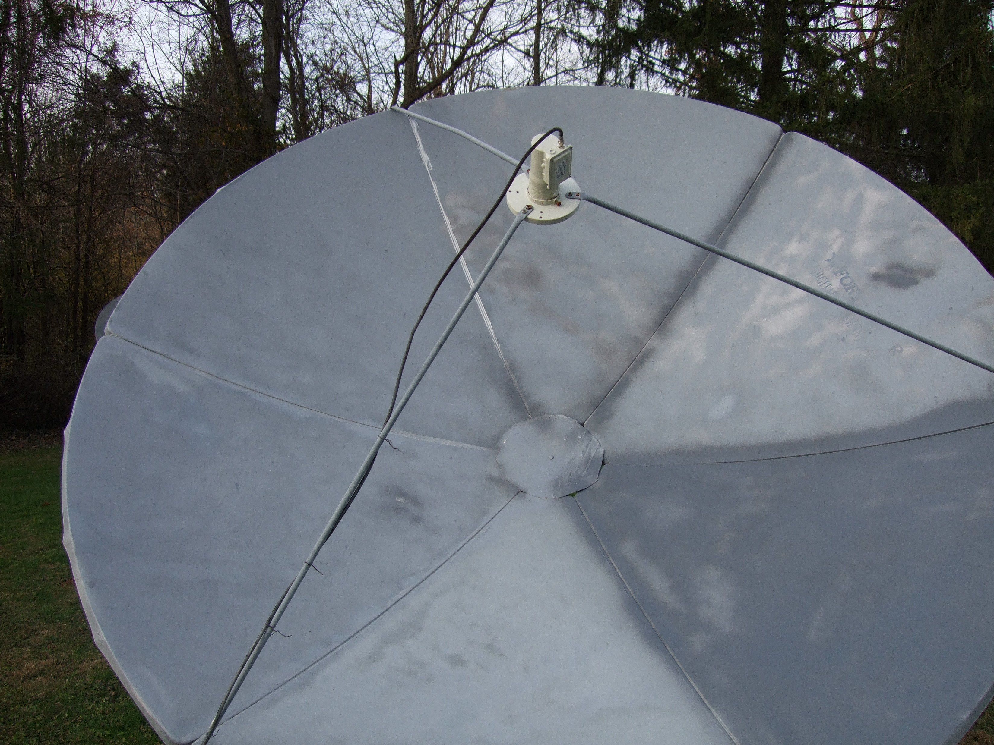

I am going to guess that you are working on the Fortec 8'. From what I have seen, these have either quad or tri support arms for the feed setup. The Geosat CK1 is a pretty light LNBF so I dont imagine the LNBF is moving in the scalar. Are you sure everything about the feed/scalar/arms is tight and nothing is sagging or moving at the ends of travel? It really sounds to me like your azimuth is off or like someone else already said, something is moving that shouldn't be. Do you have any pics of your dish on the new pole? It might help someone to spot something going awry.
A few more photos of the level. Sorry I missed the earlier request!

Bongu, yeah it's an old 8' Fortec. It does have three support arms for the lnb. I've thought in the past of adding a 4th to secure everything better. Nasty winter winds sometimes here. I noticed today the one of the arms was bent slightly. Doesn't appear to have the lnb out of center. I double checked and the center of the lnb is dead center to center of the dish. From center of dish to feed horn was 35 3/4". I think specs say 36". Anything that is a strong T.P. on 137W and 55W will be fine all day. I only lock about 4 channels on 55w, except in the early morning and then 55 and 58W show noticeable improvement. I might take pics and post tomorrow.

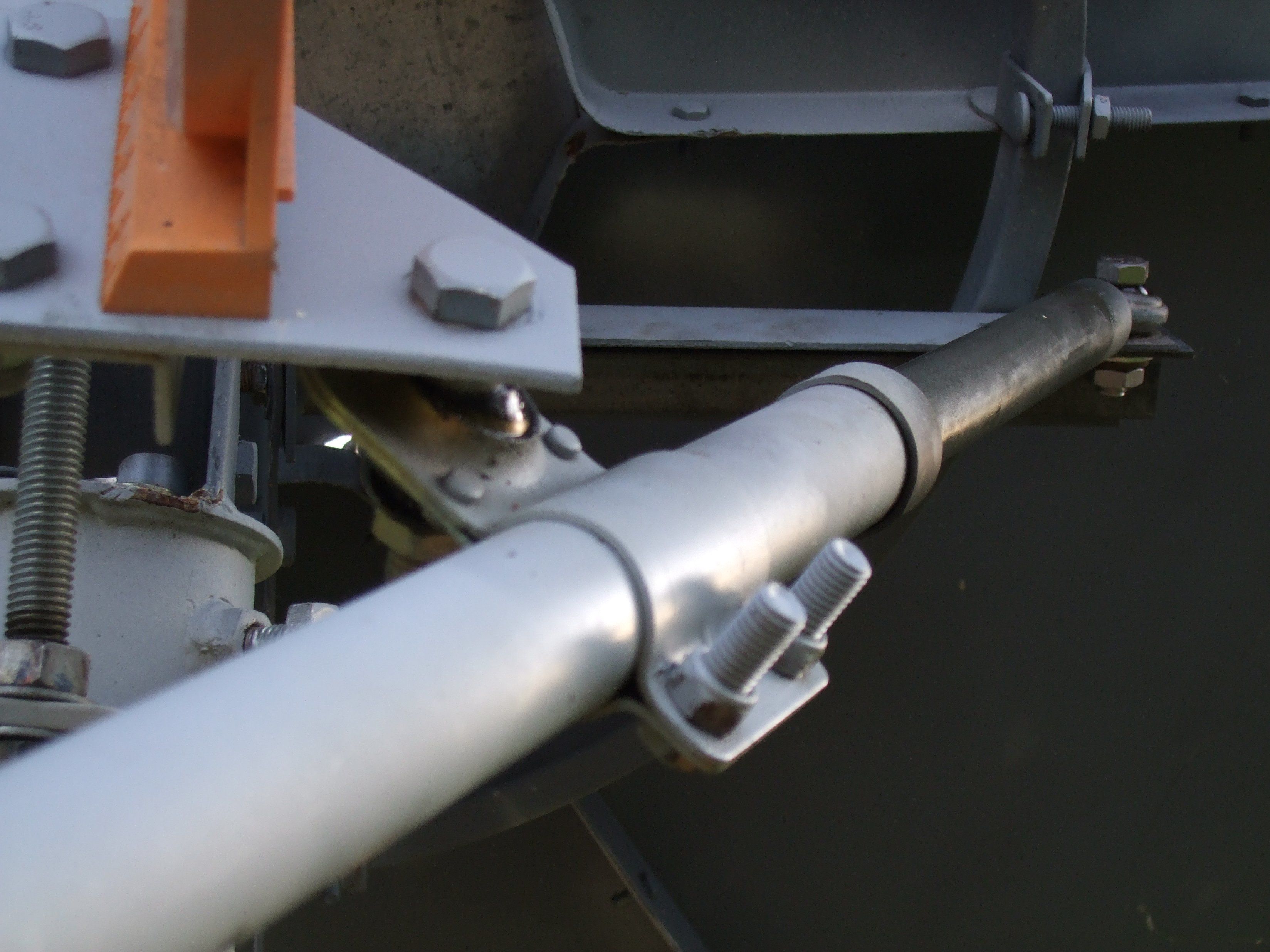

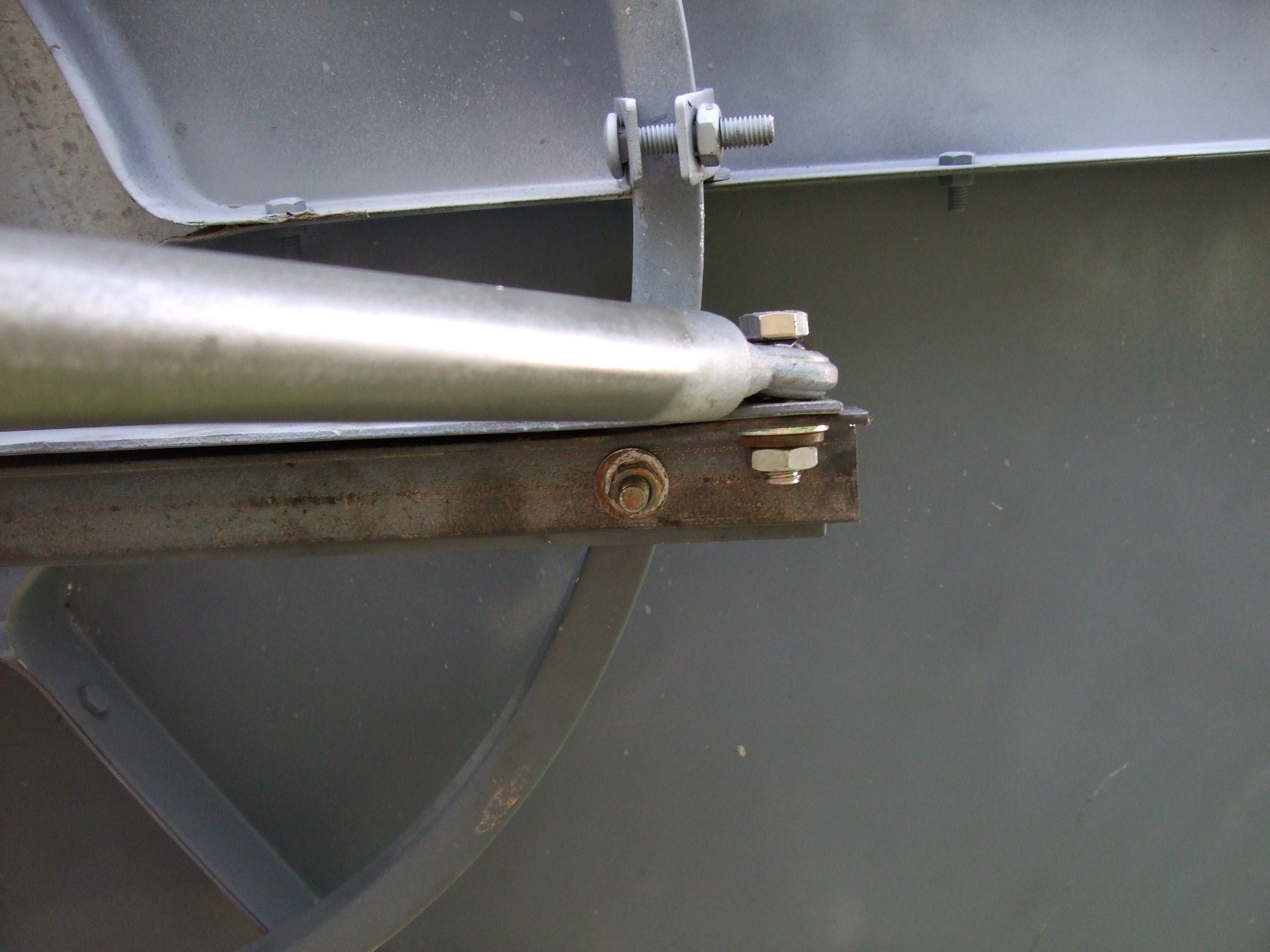

The third and fourth pics show where the arm attaches to dish. I re inforced the L shaped piece where arm attaches. Issue there is the angle iron gets slightly bent after a day or so. I'm wondering if the arm is pushing up or down on the dish at farthest sats? That might explain the problem with signal loss. Not sure how to fix it though. Its a 24" arm. Thanks to all for their help and suggestions thus far.
Wild guess here, I don't know your exact location, but from your Location information and the picture of the inclinometer, it appears your elevation is set to 54 degrees = 36 degrees lattitude. That would place you down into TN at least. Double check your elevation and compensate with the declination adjustmet. Just a thought.
Blindowl, in picture # 4 , where the actuator arm bolts on top of the mount, try moving that below the mount and use a spacer about 3/4 inch between the actuator arm and mount.Works for me....Ed
The inclinometer wasnt sitting flat sorry. Done with dish for now. It is what it is. Served me well for four years. Done tweaking til spring
With the actuator arm on top of the angle iron of the mount, it could be binding. I had mine in that position and was having problems until I relocated the arm under the mount angle iron with a spacer between the actuator arm and angle iron.....Ed
Thanks Olegray. I may try that as well. Looks like it would help. There's a little bit of slop in the mount, always has been. When you move the dish you always have to bump it a little. Getting to cold to do much now
