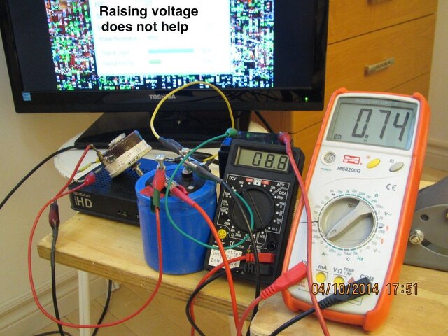

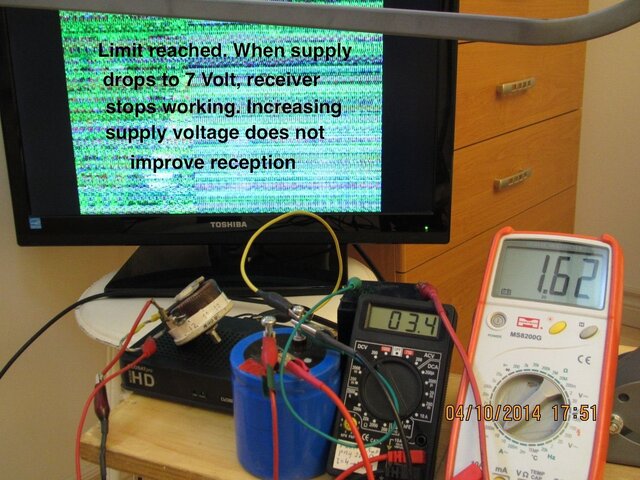

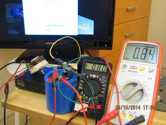

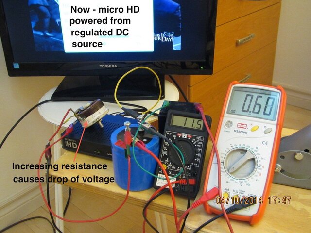

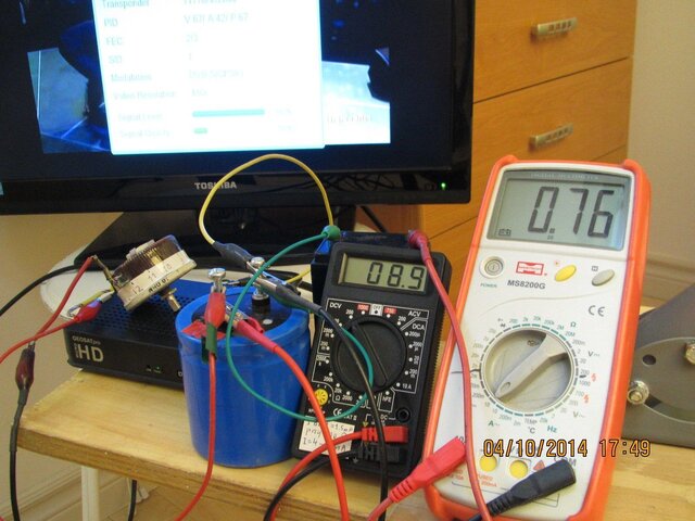

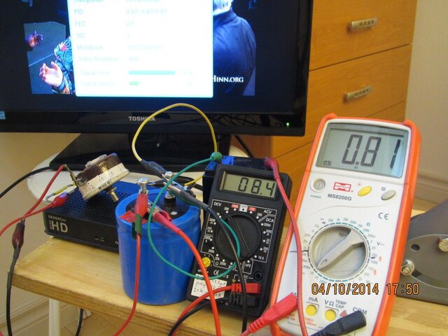

Current needed for micro HD:
Even small 12 V battery can do the job for 1/2 to 1 hour, as the micro HD needs less than 0.7 Amp to work. A few pictures follow.
<img src="http://www.satelliteguys.us/attachment.php?attachmentid=96672"/><img src="http://www.satelliteguys.us/attachment.php?attachmentid=96673"/><img src="http://www.satelliteguys.us/attachment.php?attachmentid=96674"/><img src="http://www.satelliteguys.us/attachment.php?attachmentid=96675"/><img src="http://www.satelliteguys.us/attachment.php?attachmentid=96676"/><img src="http://www.satelliteguys.us/attachment.php?attachmentid=96677"/>

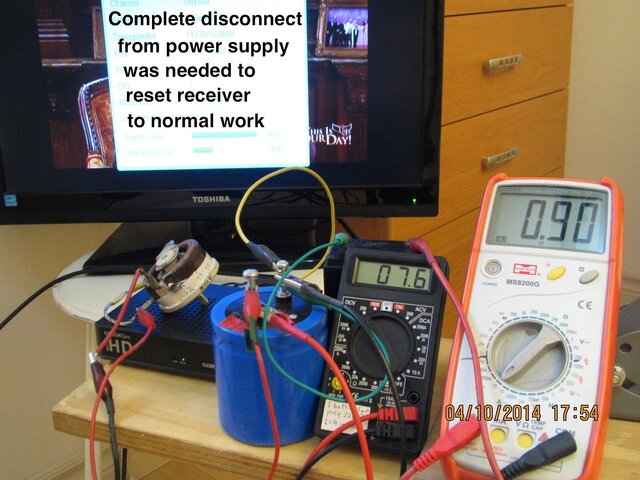

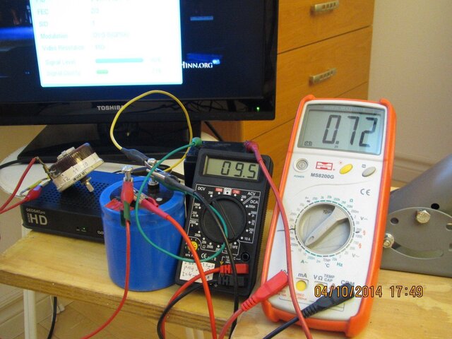

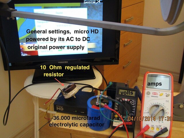

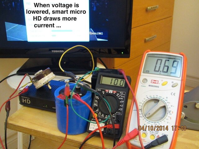

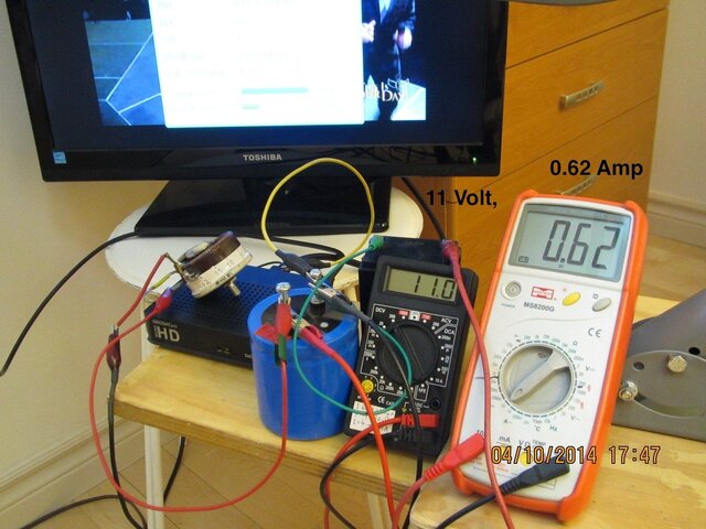

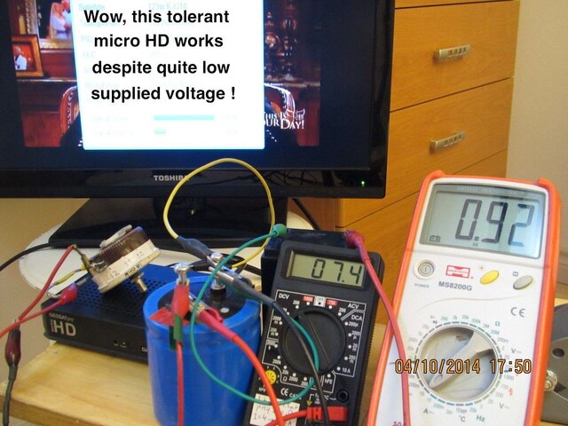

True, receiver, being not-linear device, has the ability to "take" what it really needs.
The micro HD is wonderfully tolerant to voltages much smaller than nominal.
Twelve annotated pictures follow.

Nice test! At least you really have to draw down the battery before the uHD kicks off. Just out of curiosity did you try the same test on the TV too?
