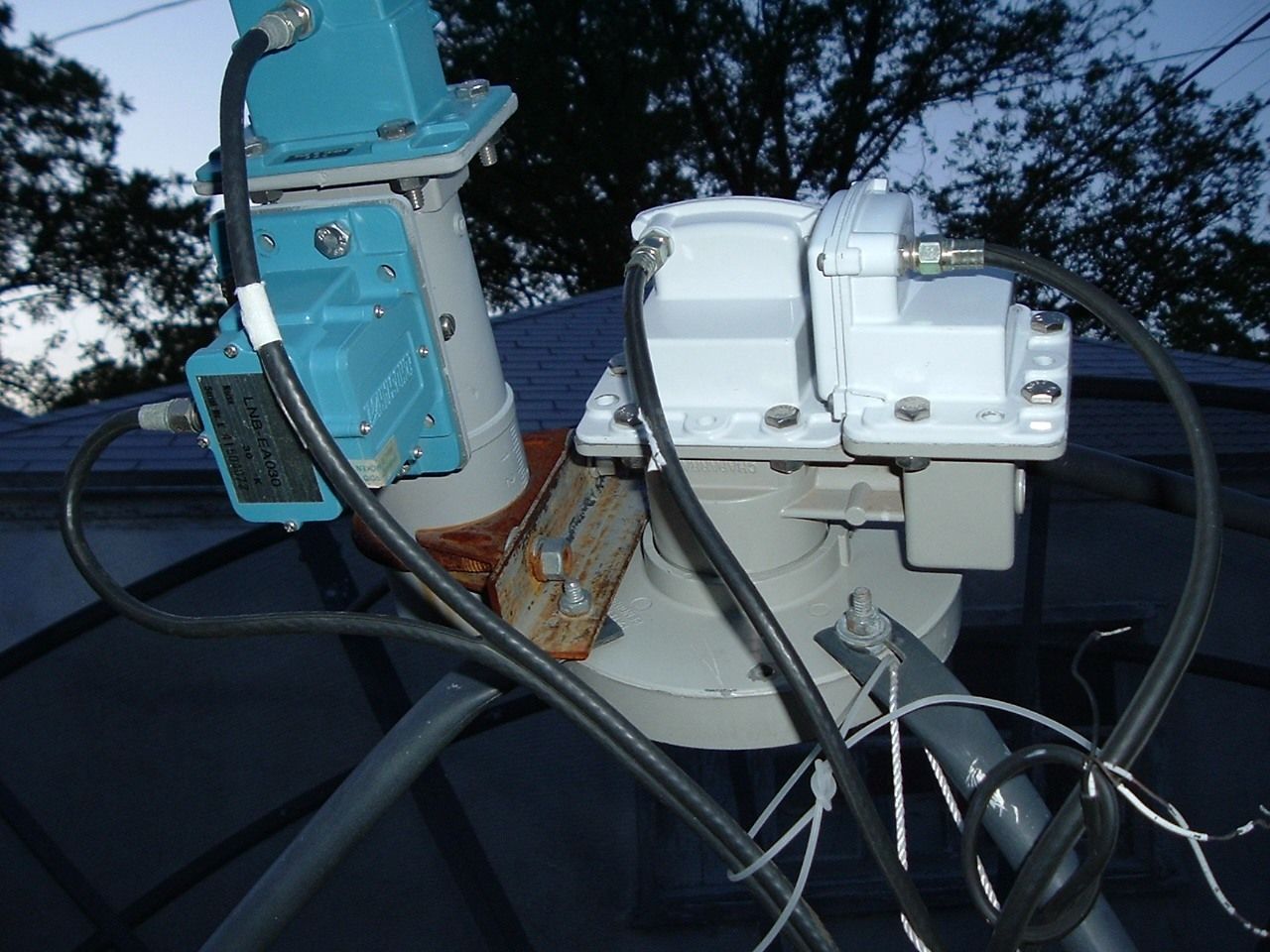

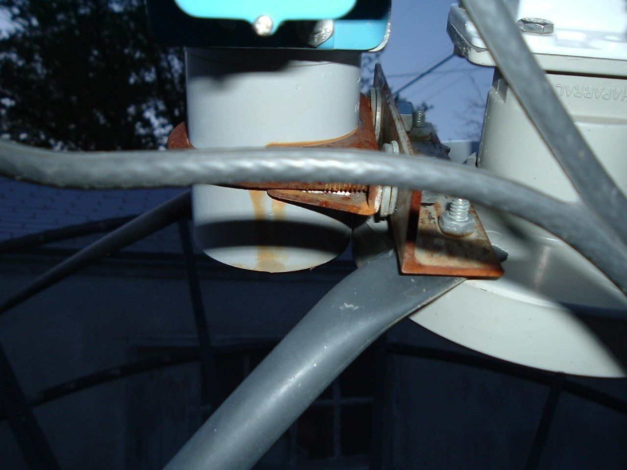

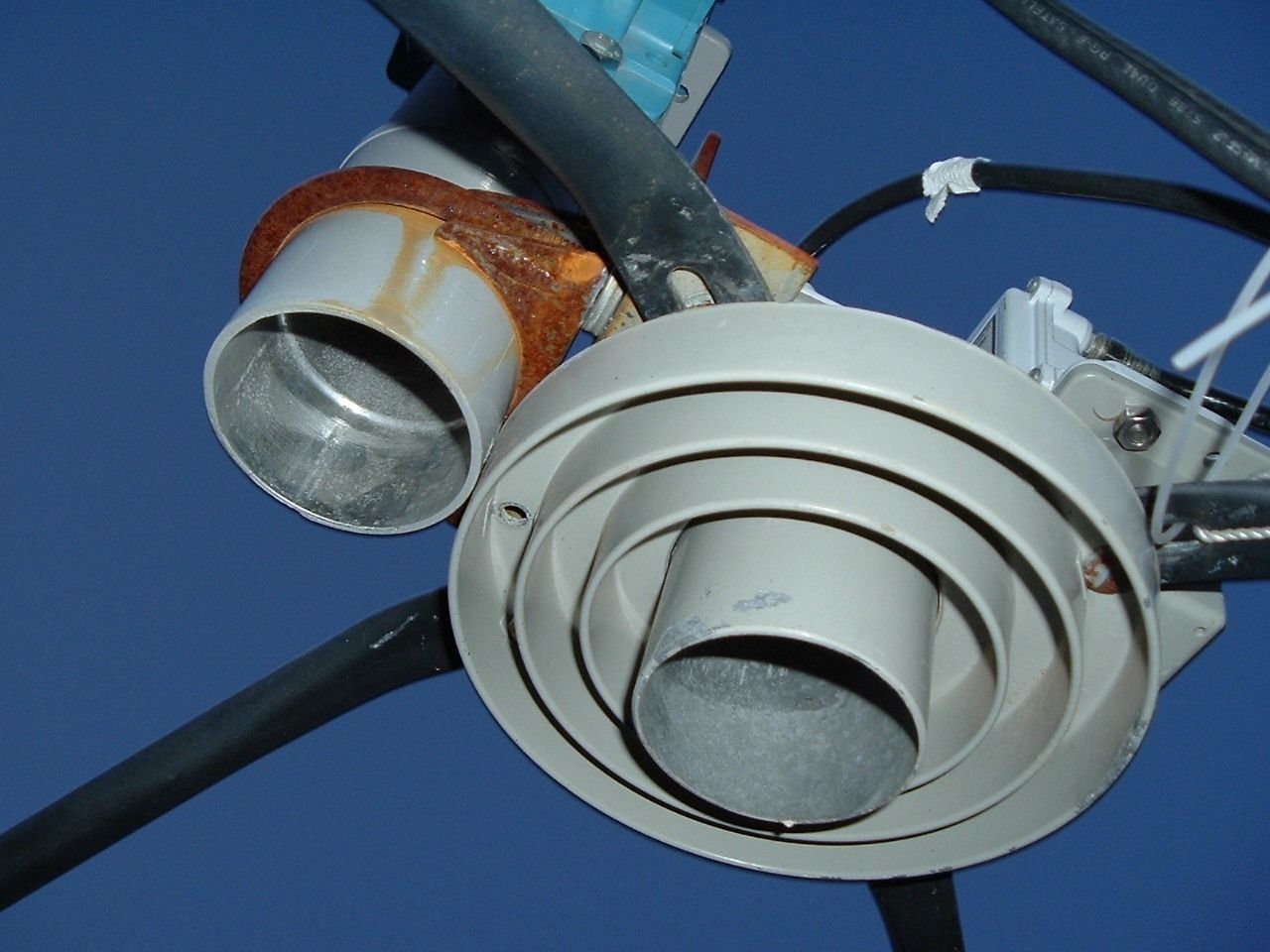

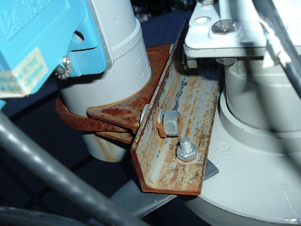

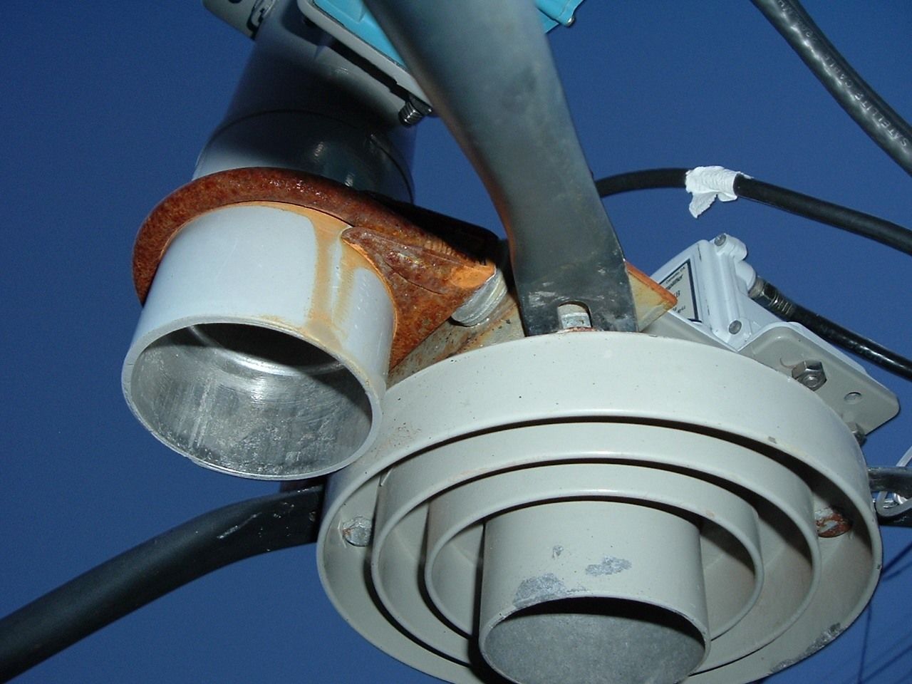

I wanted to post some pictures of two feedhorns that I am presently using on a 10' dish. I used a muffler clamp and thats why its showing signs of rust. The primary feedhorn is on G3C at 95 and the secondary feedhorn is on G17 at 91. The 4 degree spacing is "almost" perfect with this setup...certainly close enough to work in Central Texas.
I hope the pictures make it ok...my first time posting attachments.
