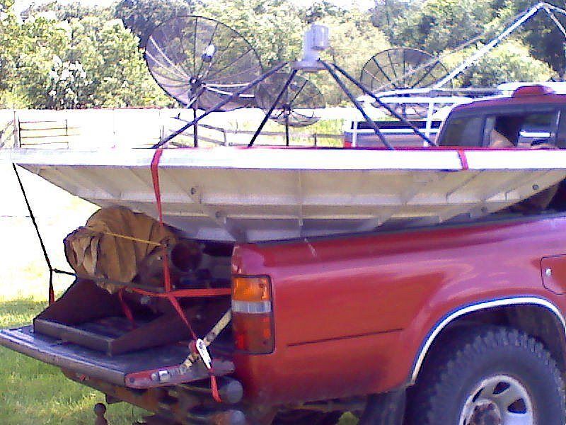

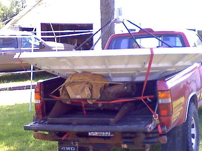

Well, when up today and picked up both dishes and hauled them home. The biggest issue I had was they didn't remove the four arms from the Channel Master and had the dish facing into the ground, which of course bend one one of the arms. Just wasn't sure if I could save it since it's aluminum, but I filled it will wet sand and a little heat and started bending and luck was with me as it came back so it may not be pretty, but it'll work. They also crack the fiberglass on the bottom edge but that should also be easy to repair, may just use some of the wife's CA glue.. Tomorrow I plan on doing a string test on it. Then it's off later this week to get another 10 footer.

Somebody else on the forum had a bent (mangled) arm on his dish.
Forget who that was. Pictures looked terrible.
I think he got it back into shape.
Dee Ann had a Primestar Ku dish with a missing side arm.
She took a similar piece of tubing from a lawn chair, and bent it to match the other side; that did okay.
I'm sure you'll manage.
As for the wrinkled edge, I hear JB Weld will get the job done.
I recommended it to someone recently, and they showed pictures of their work.
Looks like they did a heck of a fine job! - :up
If you don't like the looks after the repairs, painting those dishes is documented very well on the forum.
I'll get you links if needed, but off hand I recall a recent job by Stogie5150, and several years back a fine effort by McGuyver.

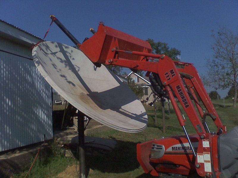

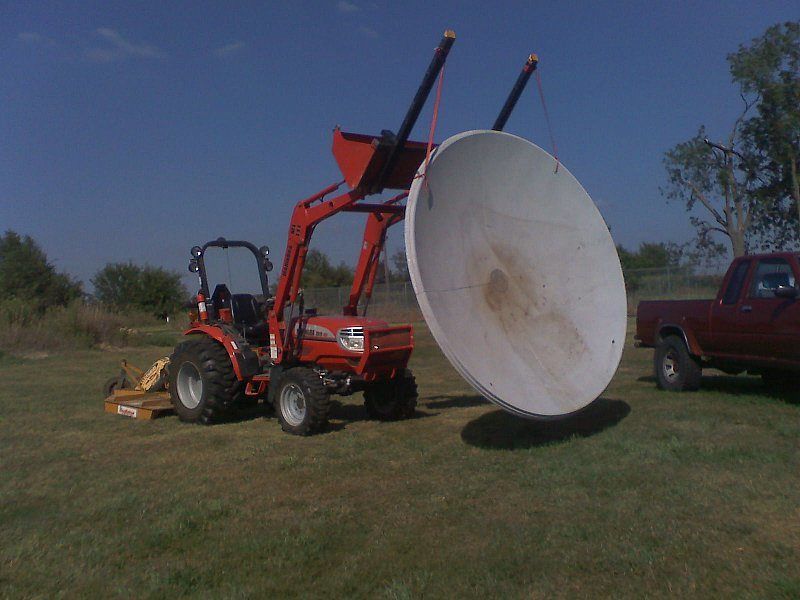

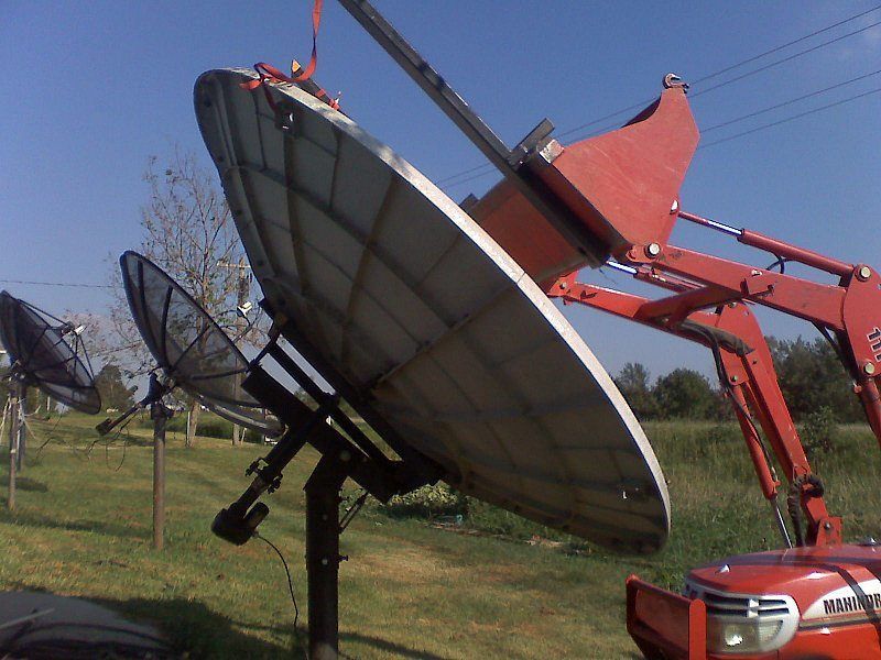

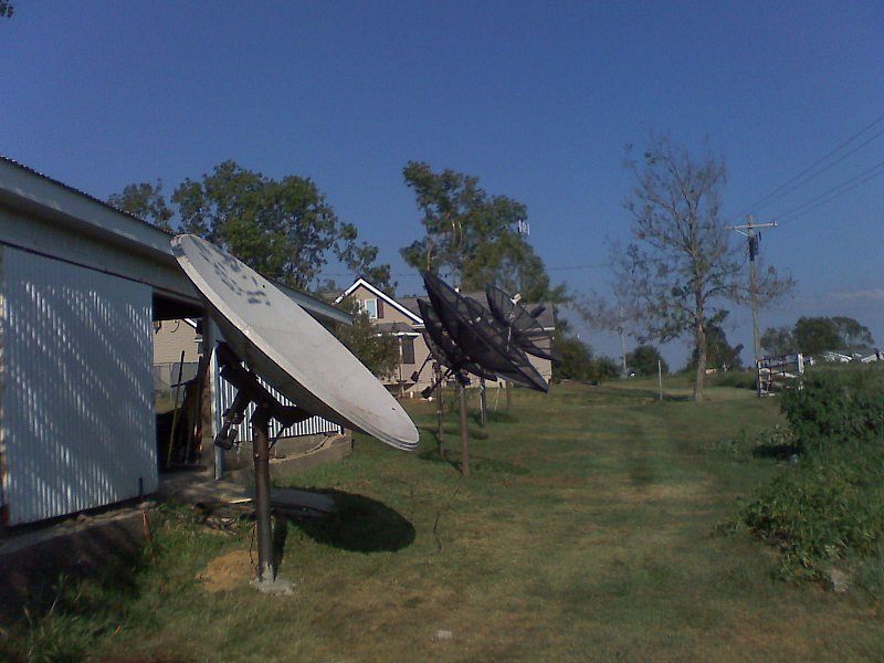

I've added the Channel Master dish to my line up as I finally got around and planted the pole the other day and also installed the mount on the pole so today I install the dish onto the mount and tomorrow I'll finish installing the arms.

That's what I call creative use of a tractor :D ...
Without the tractor there would be no way I could have installed any of the dishes by myself, especially the 8 and 10 foot when going on 6 foot poles. Even with this pole being shorter and trying to install the mount let alone the dish itself would have been be impossible.
