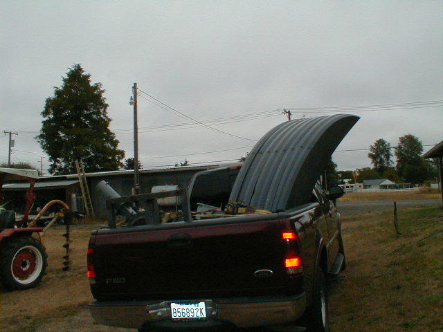

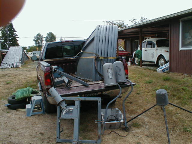

:D I had a busy day yesterday. "No-Doubt", another forum regular, contacted me last Wed to offer three dishes and whole bunch of receivers. He is moving and had a 10ft WineGard and 10ft Zenith (identical to the WineGard) and a 6ft mesh (Just checked, it's a UniMesh).
The dishes were nice and on the ground, ready to seperate the sections. All stainless 1/4-20 bolts. We broke them down into 1/4 or two section each. Very easy to load on my PU. Since we had removed all perturding brackes, ect. all 8 section of the two dishes nested together, standing on edge. Guy took a picture and I'll let him upload that. The 6ft dish was in rough condition and when we couldn't find the mount I opted to leave the dish and salvaged the LNB assemble. Only got one useable actuator but both WineGard mounts were complete and in good condition. Their LNBs were both mounted on Buttonhooks and the covers were still intact. Appear to be Chaparrale I haven't opened them yet but each has only one coax and servo cable. Start to finish, about 1 hr..

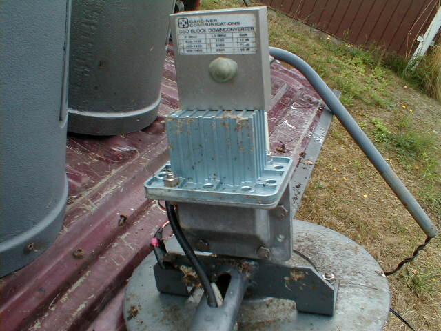

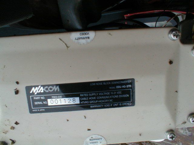

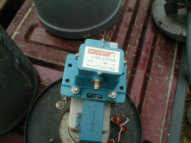

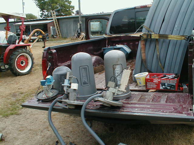

I opened up the covers on the three LNBs I got with these dishes.
After a brief battle with few MAD bees I got a little information and a couple pictures.
The Winegard has M/Acom model ODU-H3-STD. No Gold ring on feed horn.
The Zenith has Gardiner no model # just "DSO Block Down Converter".
The EchoStar seems to be recent vintage with EchoStar LNB-EA030
I was a bit puzzled when comparing the Winegard and Zenith. Both are identical setups, f:D and focal distance would have to be the same, but the Zenith has a the Gold ring called for when the f:D is less than .32. However, I rechecked and notice that they each have different model Chaparral feed horns, as you can see in the pictures. (f:D would still be the same regardless of the feed horn type:confused: )
Comments appreciated.
Steve
