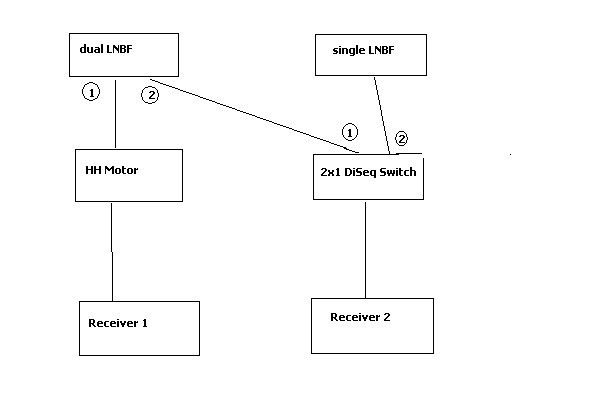

real crappy picture using paint, but it works :)
the 2 squares with no writing are the 2x1 switches
I'm thinking about the following configuration. Do you think if it works.
(hope you can see the attached pict drawn with paint !!)
Recv1 --> SG2100 --> Dual-LNBF(port 1) --> Dish1
Recv2 --> 2x1 Diseq switch(port1) --> Dual-LNBF(port 2) -->Dish1
.....................................(port2) --> Single LNBF --> Dish2
- The receiver1 will control the motor and dish1 to see all visible satellites
- The receiver2 will see one fixed sat (such as G10R) from Dish2 (port-2 of 2x1 switch)
and any sat from port-1 of 2x1 switch depending on Dish1 (same as receiver-1)
With this I can see more sats than just two (from two receivers) ....
Many thanks!!
