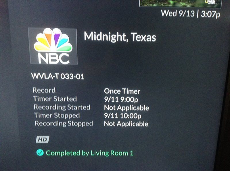

On my hws it just doesn't record ota. It will show it in the timers list, and in the scheduled list, but it wont record. After the fact, if you go into the scheduled list and back up, it will show timer started at 9pm. timer stopped 10pm. But it shows recording started not applicable recording stopped not applicable. ??
