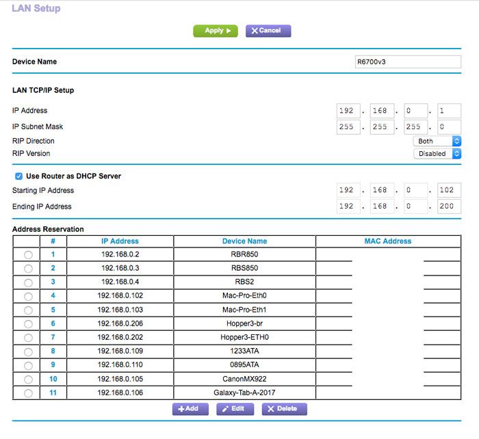

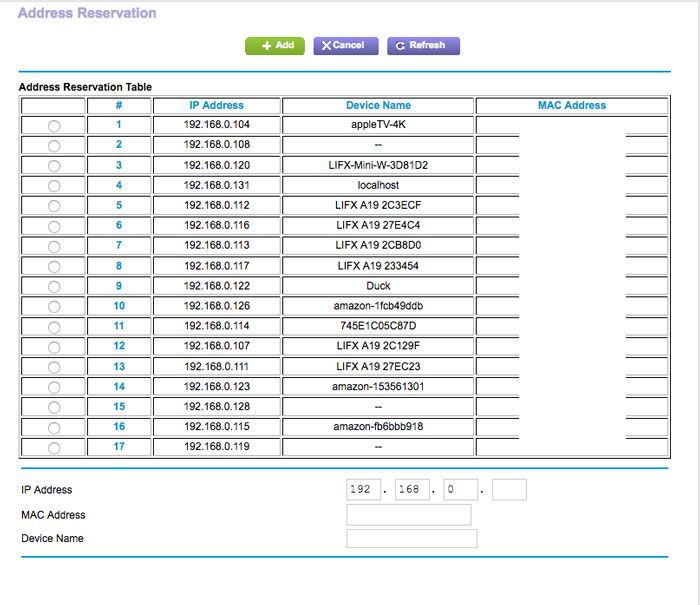

Below is the set up I have at the moment. Since I keep swapping Routers it's not complete. I have the WiFi Mesh System in AP Mode at the moment and I have to build a table to work off of to make all routers have the same IPARs for Devices. I have noticed that Devices tend to get confused and cranky when the IPAR is changed a lot. Access Control is turned off so that anything that comes along with the correct login credentials can go on and I can assign an IPAR.
Below the IP Range: All Networking gear
In the IP Range: All standard Devices
Above the IP Range: The Hoppers
Picture 1: Table of Set Devices and their IPARs:
Picture 2: Table of Devices that have yet to be set a firm IPAR or Manual Setting via MAC Address:

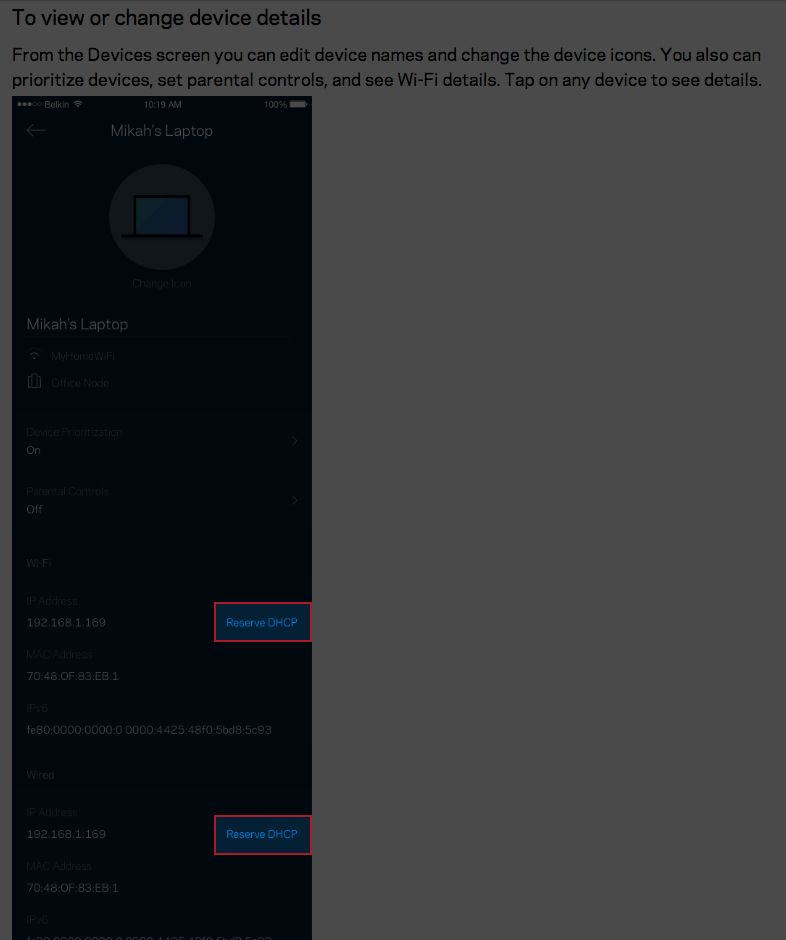

I may have found it. It's the area and, fingers crossed, action I used above. If the software/firmware allows you to go out side the IP Range that will make things easier. Or it may offer "Managed Ports". The picture is out of the MX5300 Manual. I love that you can set an IPA for both Wireless and Wired connections of a single Device. I have neeed that so many times. I just end up doing multiple IPARs. Yours may vary . . .

Keep in mind, I'm just barely educated slightly beyond plug and play when it comes to networking but it's our Linksys Tri-Band Velops, Model WHW0301v1
HipKat, I had a hard time finding a dedicated manual for that model number. And the one I did find looks like if your Firmware is up to date, they all "should" be pretty much the same. BUT it only goes so far in explaining things. It does show what would be the first two steps, but not maybe two to three more for the Devices. And there would be the need to set up the IP Address Range so you can isolate the Devices. Which would be hands-on trial and error. And it would be a true "Trial By Fire!" for someone that is not really further along than UPnP or Nat-UPnP.
I belong to many networking forums and will shout out to them to see if I can find "more detailed" instructions. So until then, if anyone else discovers the full course of action, feel free to post. I'm on a quest . . .
