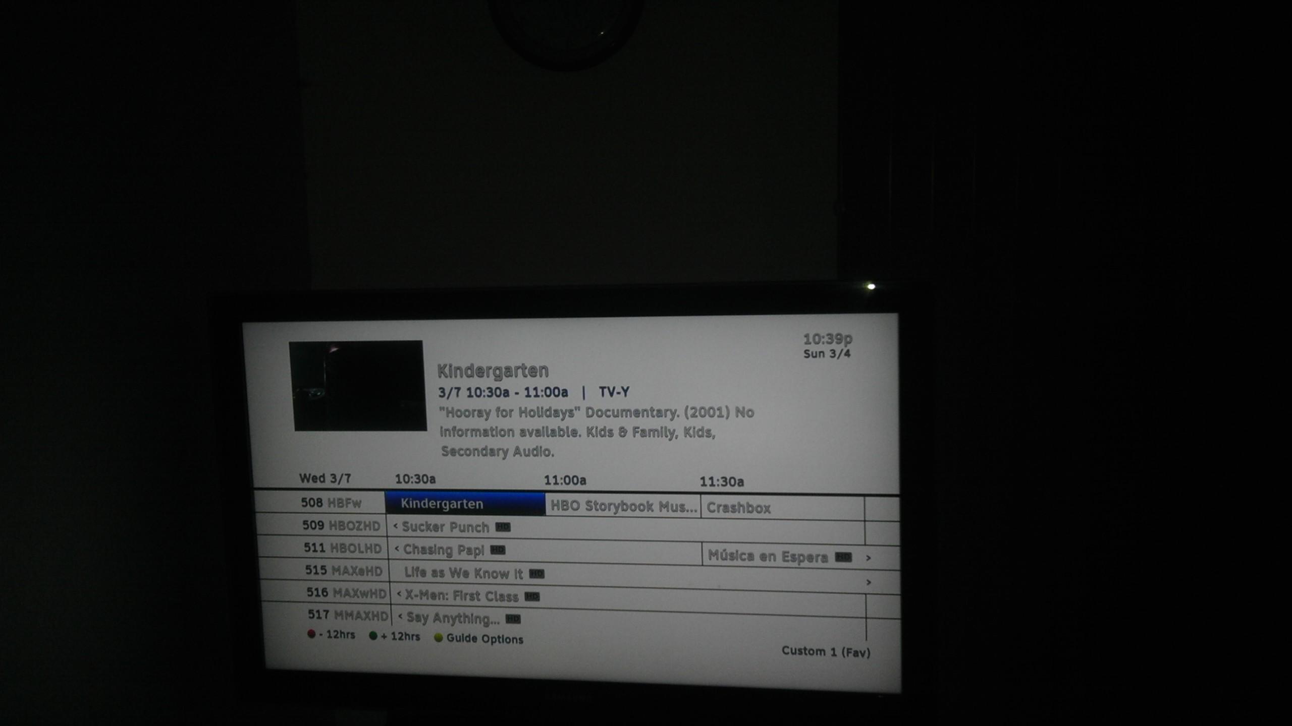

Did i somehow hit the wrong button and turn my guide white on my HR24. I don't see a setting to change it back. Anybody know?

Sounds like a software malfunction. I have heard of that and resetting normally doesn't fix it. Unless someone else had a relevant solution, I would call DTV and have them send info to engineering/ software support. They should be able to fix it within 72 hours.
we need to know if you already did a red button reset. if you have then the next step could be re-downloading the national release.
It just did it again? I think HBO On demand chosen from within the scrolling guide (in the 500's) triggers it.

Nope, just reset the receiver and force a download, it'll pick up the NR
Okay, DL'ing now. (059E). Hopefully it does the trick. If not, i guess i can have directv send me a new one, even though i got this one thrown in for free at the time of my install?
It appears to have worked. I just went to HBO on demand and it didn' turn white! I give it a few days before jumping up and down and declaring victory.:D
