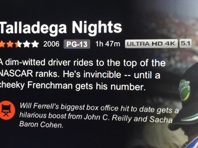

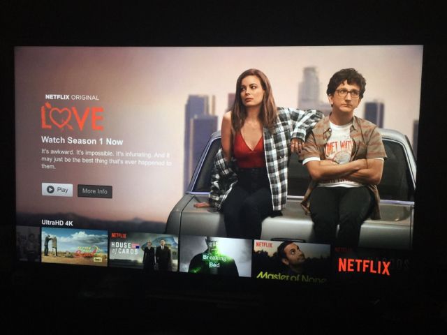

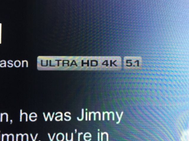

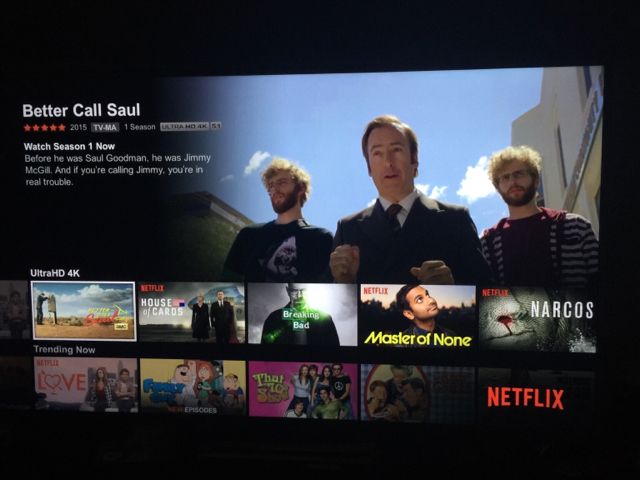

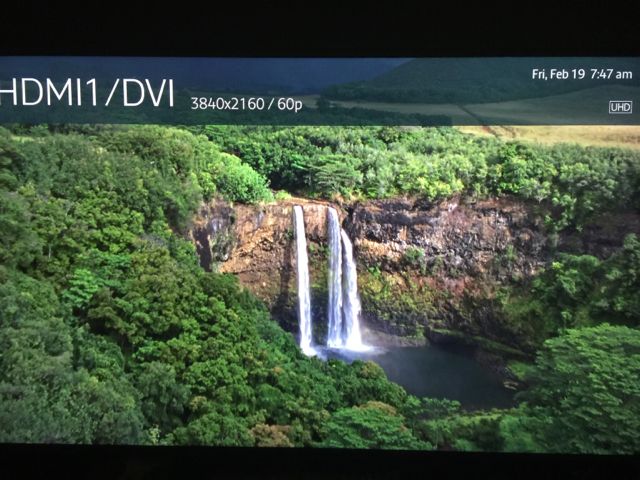

Btw 4K Netflix should look like this.
ImageUploadedBySatelliteGuys1458226095205430
ImageUploadedBySatelliteGuys1458226113453037
ImageUploadedBySatelliteGuys1458226126441753
ImageUploadedBySatelliteGuys1458226143069727
ImageUploadedBySatelliteGuys1458226161645797
