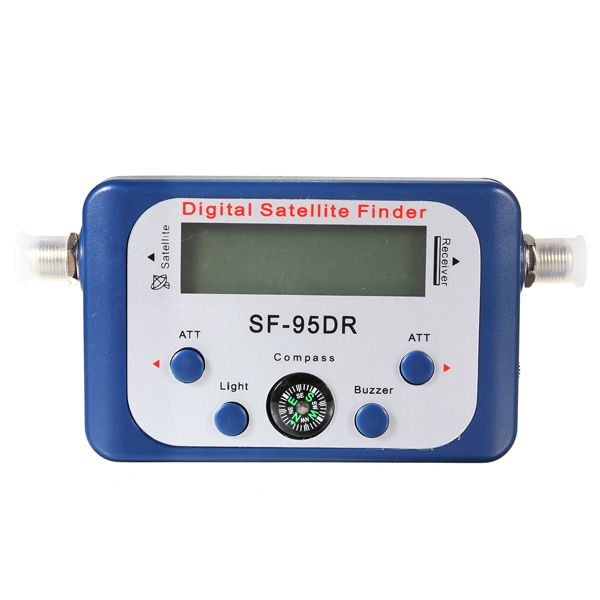

What kind of sat finder are you using?
Are you able to see your TV while adjusting your dish?
hi thanks for the replies guys !! well first off, i cant see my Tv wile adjusting my dish, im considering taking an old tv out side on the top of the shed wile i adjust the dish, my sat finder is a SF-95DR, my LNBF on the box just says GT Ku band Twin LNBF model GT222S, Input 11.7-12.75 Ghz , output 950 -2000mhz L.O 10.75 Ghz Noise 0.1dB and gain 60dB, the LNBF came with the dish i bought. The set topbox dont seem to be anything amazing, i originaly baught a really nice one on ebay and the seller backed out and decided not to sell, so i got this one, i wasnt about to pay 130 bucks on something i honestly didnt know if ide like or not, but all the box says is Settop box DVB-s2 i put in two pics, the LNBF is diffrent than mine but looks the same and same brand, the set box is the same one i got.

That satellite finder meter will light up if pointed at most anything electric/electronic, power pole, air plane. At least you know you are on the arc or close enough.

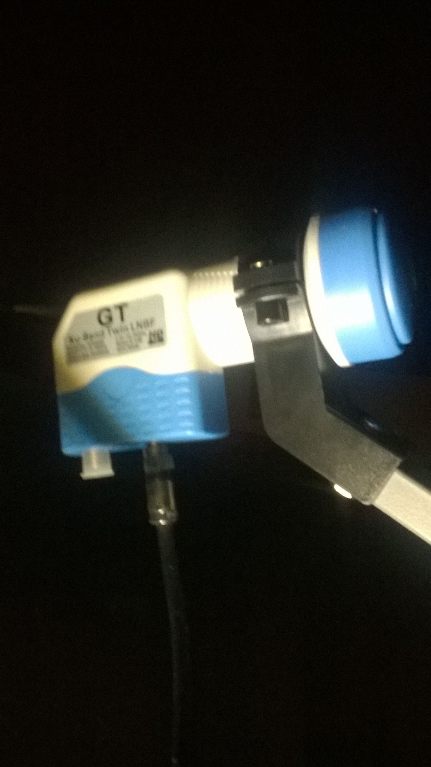

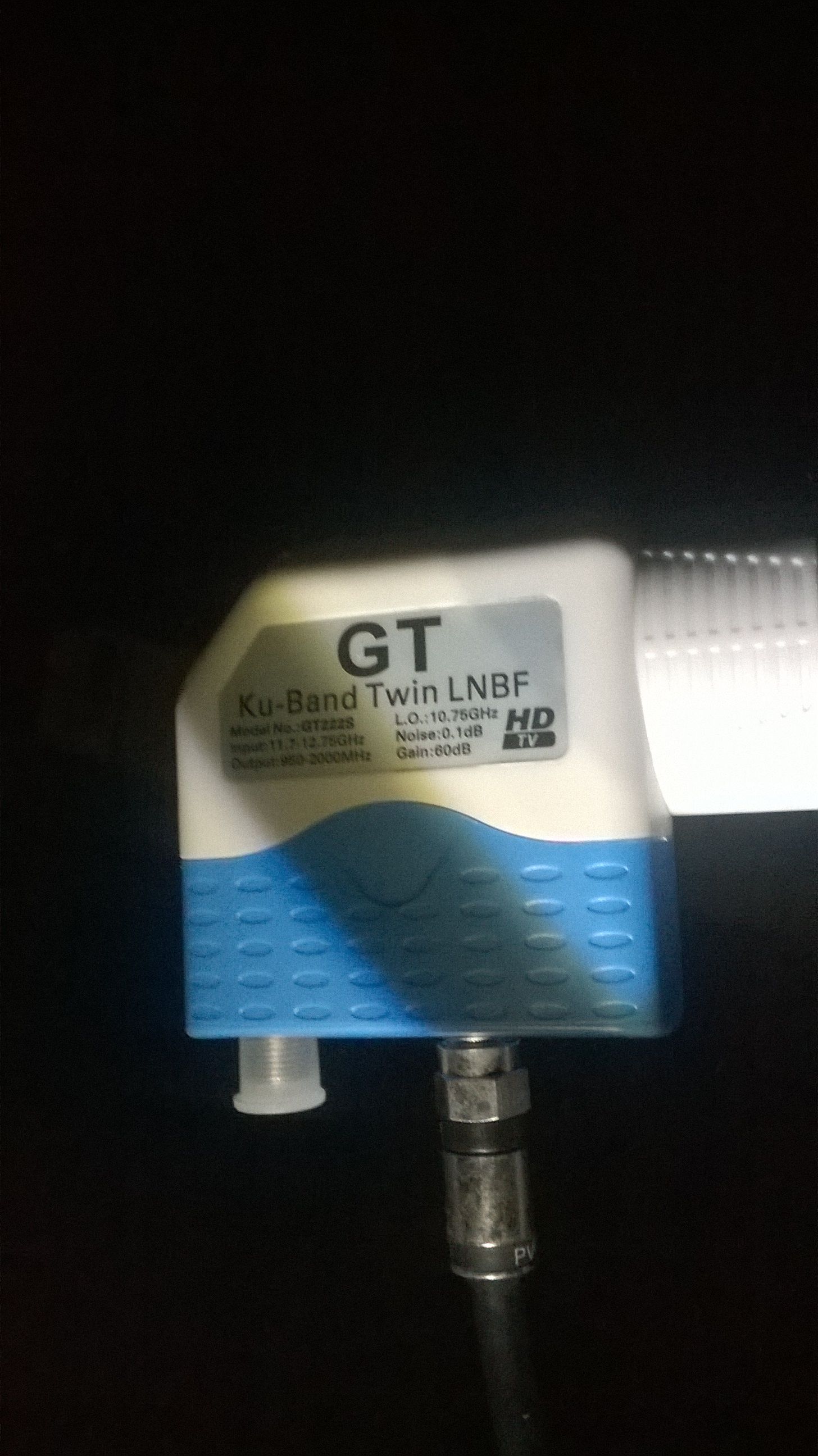

the Lnb in the picture IS NOT the same as mine its a diffrent model, but it looks the same, tomm i can get a pic of it ...actually maybe right now since the ladder is close enough for me to touch the dish ..ill see what i can do
I stand corrected Brian, I see it now in the numbers the OP posted. I googled the GT TC40. :)
Yes, lets see a picture of that LNBF. :D
here is my LNBF but ..yeah everything i wrote from the box is all it says lol, also should the lnb be the way i have it or push it all the way in ?

Ok yes it is for sure a standard, so yeah LO on to 10.750 and 22k off.
I have found it varies by LNBF and dish as far as in and out. Another thing to experiment with, however do that after you lock a signal, it will not be enough of a difference to not lock either way.
