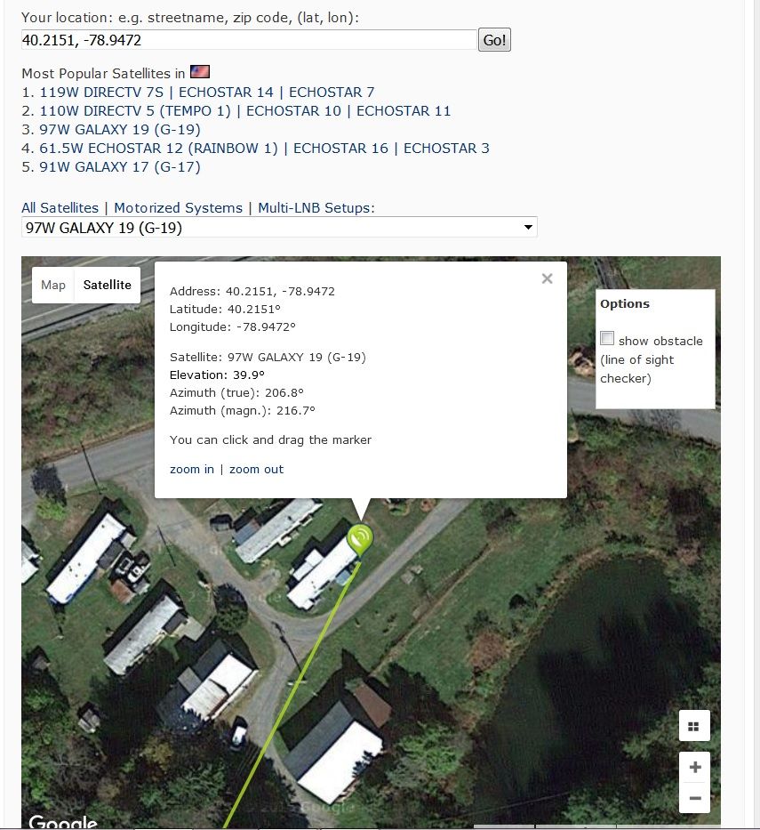

Elevation: 39.9°
Azimuth (true): 206.8°
Azimuth (magn.): 216.7°
LNB Skew [?]: 20.1°
should i go by True or the Magn for the azimuth? to hit 97.0w g19?
im just going by what dishpointer is saying for everything, but for the green line ... yeah depending on the angel you look at it it looks like 4 totaly diffrent spots so im trying to go by compass
and yes i am on the east coast, im actualy about 40 -50 miles from pittsburgh

There is only one green overlay on Dishpointer for 97w. By dragging the pointer to the exact dish install location, the Green line will point exactly to a landmark that aligns with the 97w satellite.
Here are your coordinates plotted on Dishpointer.
Based on the shadows for the Google Map photo, I would guess the satellite snapped the shot at 10am. LOL!!! :D
ok that is my location and that white pole is a telephone pole, so you think aim at that ? acording tot he compass that pole is like 239 degrees ... dishpointer says 206 to 216 degrees . this is why im like umm ok ... i allso have an app called satelight AR and it says g19 is more to the west of that pole ... and this is why im like umm a wait or is it ummm aaaa AURG ! LOL
Is the Green pointer in the above screen capture pointed at the EXACT position of the dish mount? If not, drag the pointer to the Exact position of the dish and the green line will show the EXACT aiming to Galaxy 19 satellite. The green line should align with a compass reading of 206 unless there is some magnetic interference.
No need to overthink the information... as that is what often makes a simple install so difficult! I would trust the Dishpointer/Google Map overlay before a phone app or compass that might have magnetic interference. The great news? next time you aim a dish, it will be a breeze! :D
its only slightly off of where the dish is, i just put out my ladder to go to the dish and got the box, im going to go recheck the compass on the ground , but according to the compass 206 is about the center of that barn to the right of the pole so i got an area idea of where to aim for the most part. so should i go by the degrees on the mast or the degrees by the clinometer you think? like i said in an earlyer post the clineometer is higer position for 39.9 than the mast pole. going of the arm to the lnb and adjusting for the angel of it. ... i think ill kinda try inbetween the two what harm can it do ... get nothing or prob get nothing is still nothing ! lol
