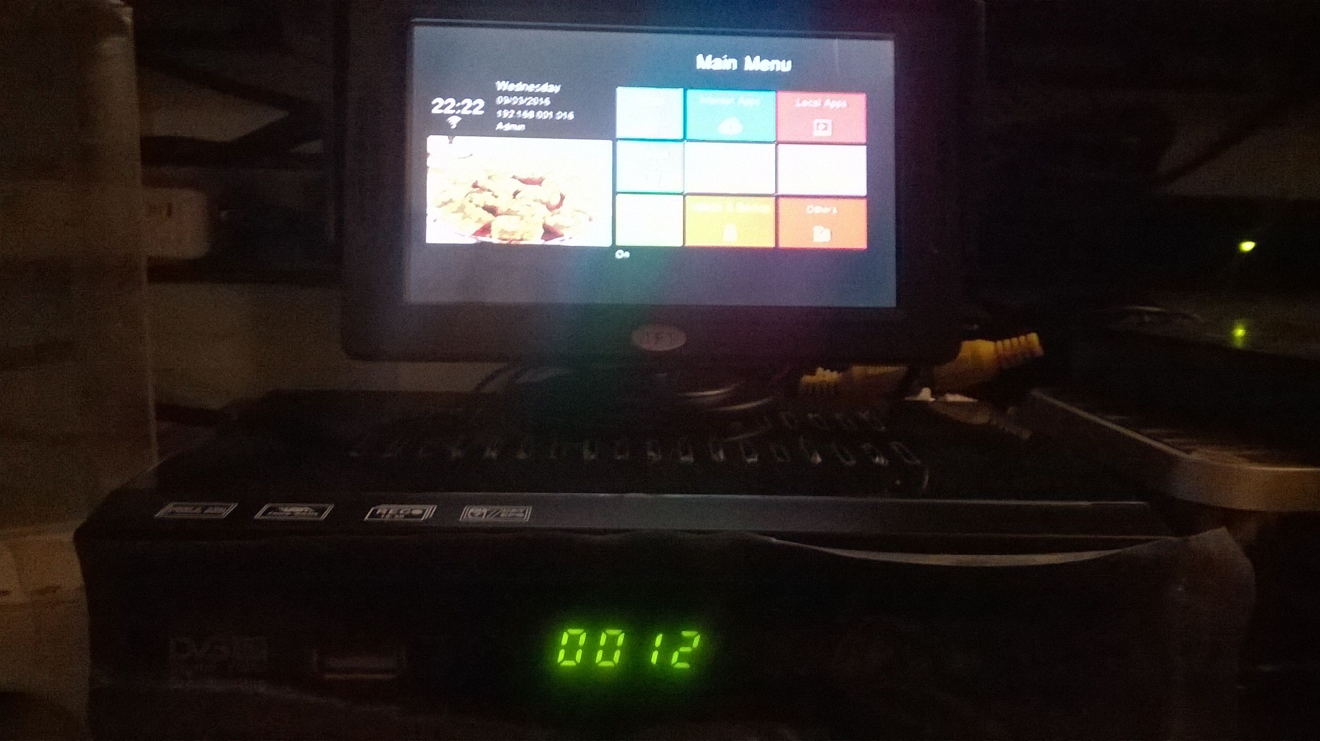

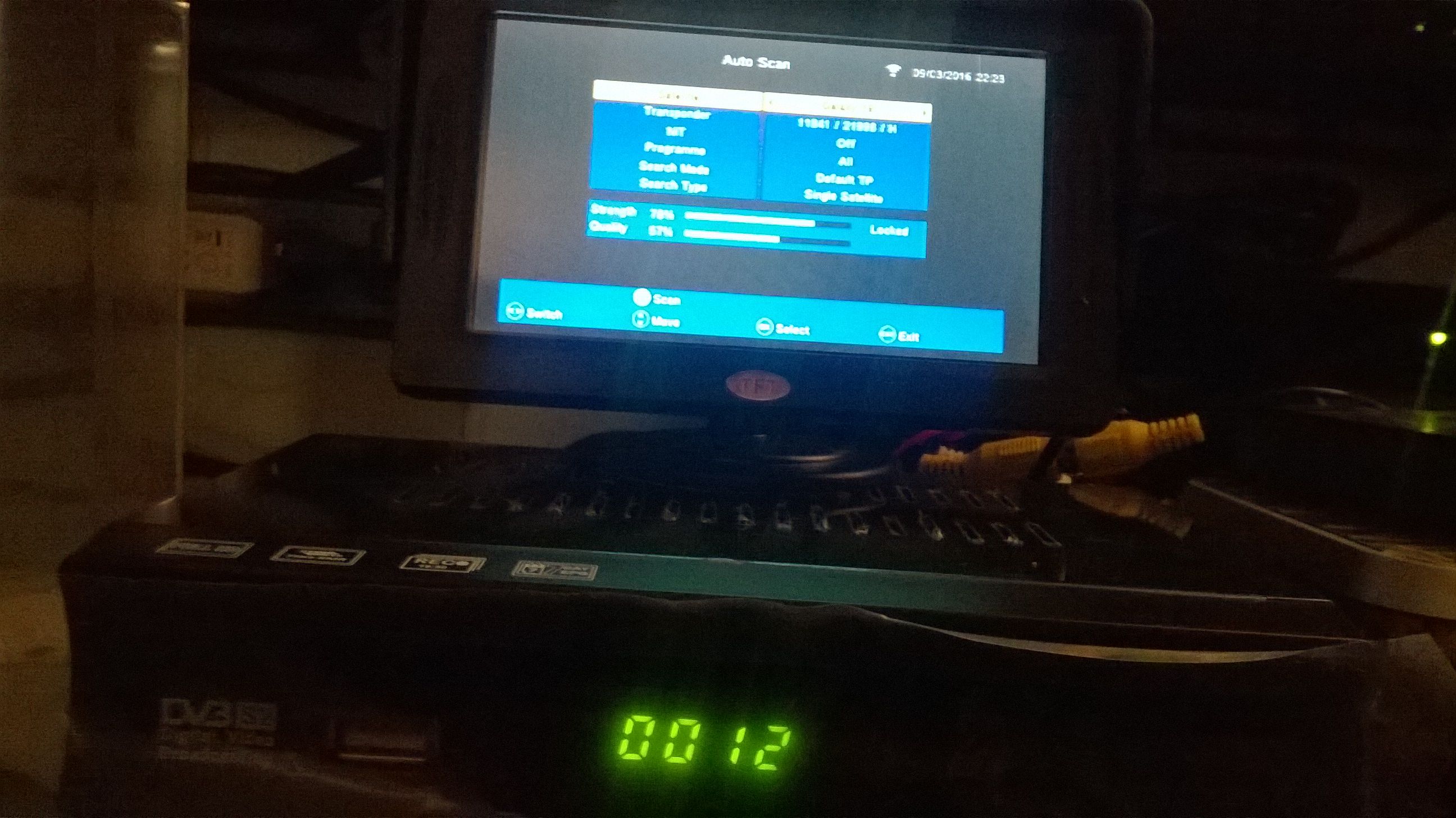

so i was just sitting here wondering how to get a tv on my roof.. LOL and yeah i dont want to drag one one of my lcds up there my luck it will get broke !... but i remembered i got a car back up cam with a small Lcd screen with RCA connectors, so i hooked it to a DC 12v power and hooked it to my Satbox... and yip worked great ! plenty enough for me to see the signals and quality bars ! the screen is smaller than the sat box ! so should be nice and easy to look for some more satellites soon !! =D will help, so my wife dont have to deal with me fliping back n forth on the tv XD and not to mention i wont be running up and down a ladder !! <3
