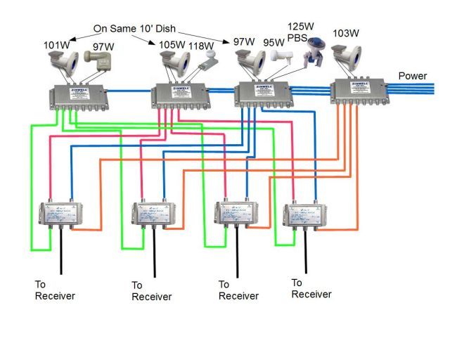

Here is my setup just to show what is possible:
