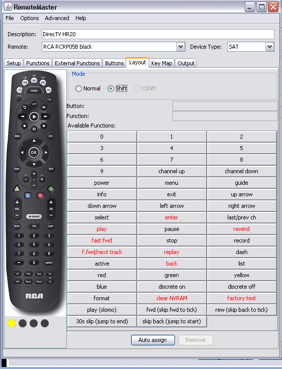

Yes it is PC/Mac/Linux programmable just as I said. I've been programming them on my PC since before Harmony existed. But the OP didn't ask for that.
Here's a screenshot of the programming software that you say doesn't exist:

Yes it is similar to a cable remote. Those remotes also have almost the same functionality, far superior to harmony in most respects and unknown to almost everyone.

Everything the OP wants to do can easily be done without JP1, which is why I mentioned it only in passing in my first response. Going from the DirecTV remote to the RCA, without using JP1 or even knowing what it means, the OP gains learning, global macros (activities), more devices, device specific macros, multi-macros, device specific volume punch thru, channel lock, key moves, key copies, more device codes, favorites, shifted keys (doubling the number of functions on the keypad), EFC capability to add any command without learning, all without any JP1 programming at all. Don't get me wrong, Harmony is nice, but for $13, the RCA gives you a ton of functionality that other similarly priced remotes don't.
