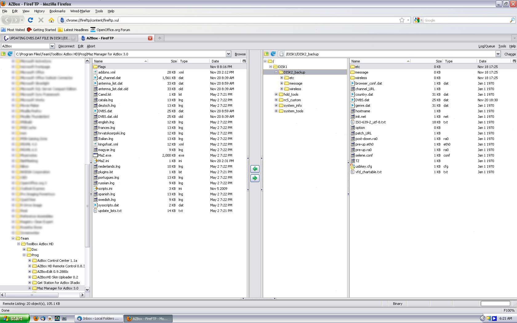

The requested listing on DISK1/DISK2_backup:
AZBox[/]$ ls -ls
is returning a DVBS.dat listing from today:
125 -rw-r--r-- 1 root root 127612 Nov 20 17:30 DVBS.dat
and a utf-8.txt listing from Jan 1 1970 as it was not copied.

Since we last talked, I attempted to FTP my newest DVBS.dat file to DISK1/DISK2_backup. I received an error report indicating the transfer was incomplete. (Remember the file to be overwritten is a "read only" file.
Now one thing I did not see mentioned here and not sure if it is necessary but the ACC program re-boots the receiver after the file is sent so make sure you re-boot the receiver after you send the file.
When I attempted to use ACC it would not reboot my Azbox. Tried several times.
After sending a new file(s) to the Azbox I always do a manual reboot to make sure the new files are in place. And, then immediately ckeck whatever I changes I made are in place.
Please take a look at my reply to JWWBRENNAN about file sizes. After using ACC to upload your files, I'd be interested to know the size of your backup DVBS.dat file? Is it in the range of 16KB or the original file size of 135 KB?

File size is going to vary according to location and selected satellites. A quick snip of birds out of range from here took the file size down to 25kb. When there is time to actually edit the list it will be smaller again. (For the most part we only use AMC 21 and Galaxy 19 but keep a few others for curiosity and testing.) It is easier to use MaZ to add and delete satellites than to keep an updated and comprehensive list of all visible satellites.
