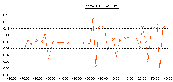

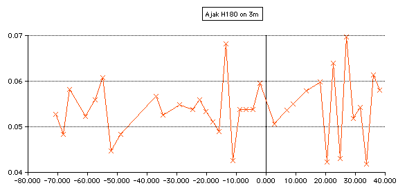

I have two H-H motors, an Ajak H-180 on my 10' and a Moteck HH180 on my 6'. When I set them up last year I logged the 'click' counts for each orbital position on my GBOX positioners for both dishes. I put these in spreadsheets and calculated the corresponding motor angles. I was hoping to automate this into a crude USALS-like process so I could dial up a new orbital position and hit it dead-on.
Unfortunately the number of 'clicks' per degree of motor angle varied over the range I tested for both dishes, from 37.5W to 148W. I could dig up the data, but at the time I concluded this might be useful for interpolating between known positions, but no where near accurate enough to perform absolute positioning.
I hate to burst the H-H USALS balloon, but I assume the mechanical precision of these H-H motors was not as tightly controlled as for typical USALS motors. It seems unlikely at this stage that we will see a resurgence in C-band H-H motors that would address this issue.
Linear actuators may suffer from similar mechanical variations in addition to the theoretical problems already discussed. However the latter could possibly be addressed by calibrating a small number of known positions and deducing the arm geometry from these measurements. This doesn't appear to be a insurmountable problem, but I haven't enough interest or need to make the investment. If mechanical precision is a limiting factor, it won't matter.

Some of the issues here are the often confused distinctions between accuracy, resolution and repeatability. If I have a tape measure, accuracy means I can measure distance between two points on any part of the tape and come up with the same result, regardless of temperature, humidity or other independent effects. Resolution means how close the markings are on the tape; however this isn't the same as accuracy if the marks are at different spacings on different parts of the tape or if say the tape changes its dimensions with temperature fluctuations. I may be able to make high resolution measurements with mediocre accuracy. If the tape markings aren't evenly spaced, I may still have repeatability if I can find the same position each time as long as I measure from the same absolute point.
Without repeatability in a H-H motor, all bets are off. With both of mine, repeatability seems to be a non-issue. If I drive the motors either direction to a known 'click' position, I see virtually the same signal conditions whether it be on a spectrum analyzer, SQ on a STB or the various measurements available on a computer tuner. This is more meaningful on a 3 m dish than 1.8 m dish because of the narrower beamwidth.
I have decent resolution; about 0.055 degrees per click on the 3 m (C & Ku) and 0.9 degrees per click on the 1.8 m (C only). Given the beamwidths and all the electrical inconsistencies in a beam pattern, I doubt that having any more resolution would result in better or more repeatable reception. The variation in a given satellite's orbital position over a day might even be greater than the Ajak's resolution. Unless I employ a loop tracker, having more resolution won't help.
What I lack is accuracy (see attachments). The x-axes show the motor angle with zero being true south and negative-east and positive-west. The y-axes show the degrees per click from the previous orbital position. These graphs are raw data from when I first set up the dishes and are probably only representative because I have refined my techniques for measuring the best position since that time. I'm sure some of the orbital locations were not perfectly determined and this likely causes some oscillations from position to position as is shown on parts of the plots. After I plotted these I realized I could have done this differently to minimize that effect but it's not worth the time to do them over
What annoys me are consistent slopes seen in parts of the plots and regions with very different, but consistent degrees/click. I'm guessing this has nothing to do with the magnet wheel or how many clicks it makes per revolution. It probably is more likely variations in gear pitch, wear and play. The Ajak motor is about 15-20 years old while the Moteck was brand new out of the box. I'm not claiming these results are typical for every setup, but am only providing the data as a warning that putting in a lot of effort to increase the number of clicks over the arc may not result in a lot of reception improvements or absolute positioning accuracy.

Without repeatability in a H-H motor, all bets are off. With both of mine, repeatability seems to be a non-issue. If I drive the motors either direction to a known 'click' position, I see virtually the same signal conditions ...
Back when I had an actuator driven BUD, I got pretty good repeatability, however my current H-H is not very good at all, and is getting worse, probably due to the big semi-circular gear or worm gear wearing out. Both with H-H and actuator, though, I've always noticed a difference in the positions depending upon which direction you're coming from, particularly when you go past center. Ie when you go past center, you are pushing from one side of the free play in the gears, and when you come back, you are pulling from the other side of the free play (hope that makes sense). Anyway, in general, I haven't been that satisfied with the repeatability of any the 3 BUDs I've owned over the years.
However the other issue, besides free play in the gears, is losing or gaining counts. Back when I had the actuator system, I only had a 100' cable run, and I very rarely had to re-sync the actuator. With my current H-H, I'm always having to re-sync, and it's getting worse and worse. I think part of the problem is that I have a very long cable run now, somewhere around 250' or so, and while this doesn't bother the rf sat signal, it does seem to affect the DC on/off signals from the reed switch. Either that, or perhaps the distance between the magnets and the reed switch isn't proper. Also, the reed switch on my H-H is pretty exposed to the elements, and it gets very wet. Darn thing has grease all around it, which somehow seems to keep the moisture from draining properly, so I think the grease makes it worse. I bought a replacement reed switch, but it didn't help.
In any event, I haven't been very happy with the repeatability of any of my BUDs. My 90CM dish on the SG2100, on the other hand, has been quite repeatable.
You say "motor angle" above is this what you really mean, or are you talking satellite longitude along the Clarke belt? Ie I'm curious how you determined this? I'm kind of assuming that you don't mean motor angle, even though that's the only angle that you'd really expect to be related to the counts. Since you mention oscillations from position to position, I'm assuming that you determined the angle by peaking on the satellites. I'm wondering if you could have smoothed out your plots by using a sat tracking program with the newest keps, to get the actual orbital position of the sats at the time, since they vary by amounts consistent with the oscillations you observed. It would take a lot of work to do this, but it would be interesting.
I have a spreadsheet that I've set up, which I use to relate counts to orbital position of the sats. This has been very useful to me in terms of being able to locate sats that I don't have programmed, particularly sats over the Atlantic, when my last programmed sat is like PAS9, or whatever it's called now. I've always been able to pop in the longitude of the sat I was looking for, then it would tell me what count that sat shoud be at, and when I'd go there, I'd be close enough to see the signals from that sat. However this spreadsheet was also using orbital position angles rather than motor angle. I'm thinking of re-doing this spreadsheet, and instead of orbital location, use the USALS angle for each sat. I'm guessing that it will result in much better results. Since I have a program that capable of spitting out both current KEP based orbital locations and USALS angle, I'm tempted to try modifying my spreadsheet to use USALS angle as well as the semi-real time sat positions.
There are so many things that would affect the clicks and angle where you peak on a sat that I'm surprised that your results look as good as they do. I'm a bit confused though with respect to why you chose to plot the degrees per count between sats, when you knew that the distances between sats is always changing? And if both adjacent sats are changing the affects are sometimes doubled, probably why every other one seems to be up/down/up, etc. Again, using the keps to use the actual real time positions might help here, but that would require re-peaking on all the sats, which is a pretty time consuming effort.
Last question, is how you got the "degrees/count" for the Motec motor? Only thing I can think of is that you used DiseqC-1.2 and went one single pulse movement at a time until the next sat was peaked? I sort of did this when I first set up my arc using DiseqC-1.2, and was locating each next sat by estimating how many single moves it took to get to the next sat. However it seemed like it wasn't as accurate doing this as I though, I'm guessing because the motor might occasionally miss a command (whereas when you're sending a goto type message, it sends it several times to make sure). Anyway, I'm curious how you got those counts with the Motec motor?
Interesting study, but with my BUD, I'm just happy if I end up close enough to see the signals so I can re-peak.
Even though my Ajak motor is old, it doesn't appear to have much wear. Still, I worked on both my H-H motors to reduce any play before they went up. So far I've been unable to find any meaningful difference in positioning based on the direction I approach the desired point. A couple of months ago I tried to measure this error on my 3 m with a combination of my spectrum analyzer and a scrap of Linux code I wrote that ran a USB box receiver. Even with long integration times and measuring the beam pattern, I wasn't able to determine if there was any difference.
My first Moteck HH180 had a similar repeatability problem out of the box. I bought a replacement as a spare, and before sending the bad unit back, I swapped sensors. That solved the problem. Just before doing that I had put a scope on the sense lines at the controller box and noticed the pulses were rather ragged. I have nearly 200' of run to the Moteck mast. I breadboarded a quick differential amplifier so the two sense lines could float and played with a bit of low pass filtering. I also tried a monostable multivibrator. Both cleaned up the pulses, but all this proved was pulses were still being lost/added. I ran a benchtop electronic counter in parallel to the controller and both saw exactly the same thing. With the new sensor the pulses were cleaner and I don't use any preconditioning before the controller. I mention this because you might be seeing either or both effects.
I calculated the motor angles by the nominal orbital position using the same technique you and I previously discussed in the USALS Notebook thread.
If I had seen better results I had planned to go along with an outline similar to what you describe. My initial analysis on the 3 m was the step resolution at the controller was about half of the station-keeping requirement for the orbital positions I checked. I therefore elected to neglect the instantaneous positions of the satellites, because I was going to measure a lot of positions; if the dominant error was the off-center satellite location I would see a lot of +/- 1 count variations from a nominal value for degrees per click. However the data showed locally consistent variations of larger magnitudes consistent with mechanical errors. I did my best to peak each position with two independent measurement techniques, but I could do better if I did it today.
I agree using the orbital elements would have eliminated the effect you describe. My supposition at the time was the mechanical errors would dominate and I think that turned out to be the case. I also found the on-line calculators for satellite position didn't all agree. Sorting out the rights from the wrongs was out-of-scope to the level of effort I wanted to invest. Realize I collected the data for a quick look and hadn't planned to use it as a basis for any detailed studies.
The Moteck HH180 is a traditional BUD motor with 36V motor lines and separate sense lines. It does not do DiSEqC 1.2 and requires a controller like a GBOX to run it.
