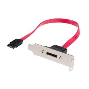

The 410 series does not come with eSATA but I just as easily add a card for that, I suppose.
You don't even need a card. If there is an extra SATA port on the motherboard, then all you need is an eSATA adapter, like this one:
And you can buy an eSATA (or eSATA/USB) disk enclosure at a local Microcenter or on-line. Those enclosures are very inexpensive.
They often cost less than the included eSATA cable if purchased separately! ;)
Some of them come with the SATA-eSATA adapter too.
