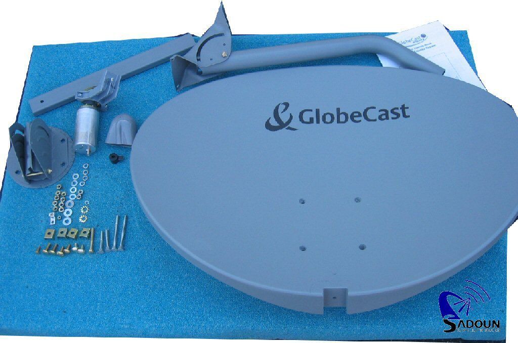

I currently have a Dish 1000.4 for the Eastern Arc Satellites that I have temporarily moved to a new location, because my roof is being fixed. Now, this temporary move got me thinking! I should replace DN Dish 1000.4 with a modified Channel Master 36"x27" Globecast Elliptical. As we all know, the 1000.4 has a very low "Rain Fade" tolerance and the Globecast Dish should help reduce, but not eliminate it. My concern is that I do not have a meter that would detect the MPEG 4 signals from 61.5°W, 72.5°W and 77.0°W, and that leaves me to use my 722K to point and peak the Dish. (1) Since 72.5°W is my true south, my Elevation should be 41.2° and the skew on the Dish should be about 90.0°, right? (2) Does anyone know the transponders that I would use to point and peak the signals on all three Satellites considering that I'm on Eastern Massachusetts?
I have attached sample picture of Channel Master 36"x27" Globecast Elliptical dish.

How are you planning on getting 3 satellites from a dish designed to be aimed at one?
The Channel Master 36"x27" Globecast Elliptical dish has almost the same parameters with the DN 1000.4 Dish with exception of the size. The advantage being the Channel Master 36"x27" Globecast Elliptical is bigger.
But is the LNB support arm at the right point for using the E* 1k4 LNB setup?
Yeh, the shape of the reflector, the length of the LNB arm and the spacing of the LNBs all come into play in capturing signal. Good luck in your endeavor. The way to reduce or eliminate rain fade is to use a larger reflector and a single LNB for each orbital.
The elliptical describes the outer shape of the dish, not it's curvature.
All dish surfaces are hyperbolic to one degree or another.
Dish network multi lnb dishes are defocused in the horizonal plane to service lnbs along a line across the focal point of the dish (they are hyperbolic in the vertical plane but the hyperbola is flattened in the horizonal plane.
If the Channel master dish is not designed with multiple lnbs in mind AND with the same focal length as the Dish Network 1000.4, it will not work because you will be able to focus one satellite but the other 2 will be very weak if they are distinguishable at all.
EDIT: Looking at the Globecast data on line it is designed for one LNB, so it has a single focal point and would probably give you less signal strength on 61.5 if you were able to get 72.7 and 77 lined up.

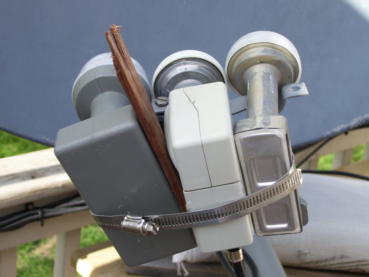

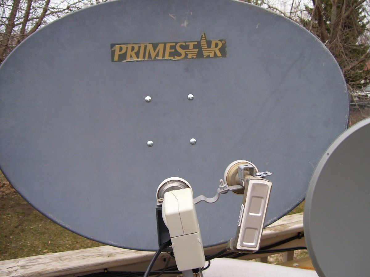

DBS is so much easier to do multiple LNB's on a "non standard" dish than it would be for KU Band. I've done it numerous times. Below are 2 pics
-119/123 (KU)/129 on a Primestar (40x30)
-107.3 (when I had a Shaw Direct account) and 119
both times the DBS signals were much higher than what a stock D500 would give
Looks like you re-spaced the lnb's also, putting them closer to the focal point of the dish, can't do that with a D1000.4 EA lnb head.
yes I know that. I've worked with using multiple LNB's on dishes for a fair amount of years so I know the spacing is different on the larger dishes versus the smaller ones. There's a reason I have a stockpile of hose clamps and scrap pieces of wood. It doesnt have to be pretty to be effective ;)
But if the OP only has one receiver (the 722 as mentioned) and isnt in Springfield (as those HD locals are on 77) he could feasibly get by with a couple Legacy duals and 2 SW21's (them are dime a dozen) or could do DishPro duals or singles and a DP34. The OP is a FTA person too so he's probably done some "reworking" of a setup previously:)
