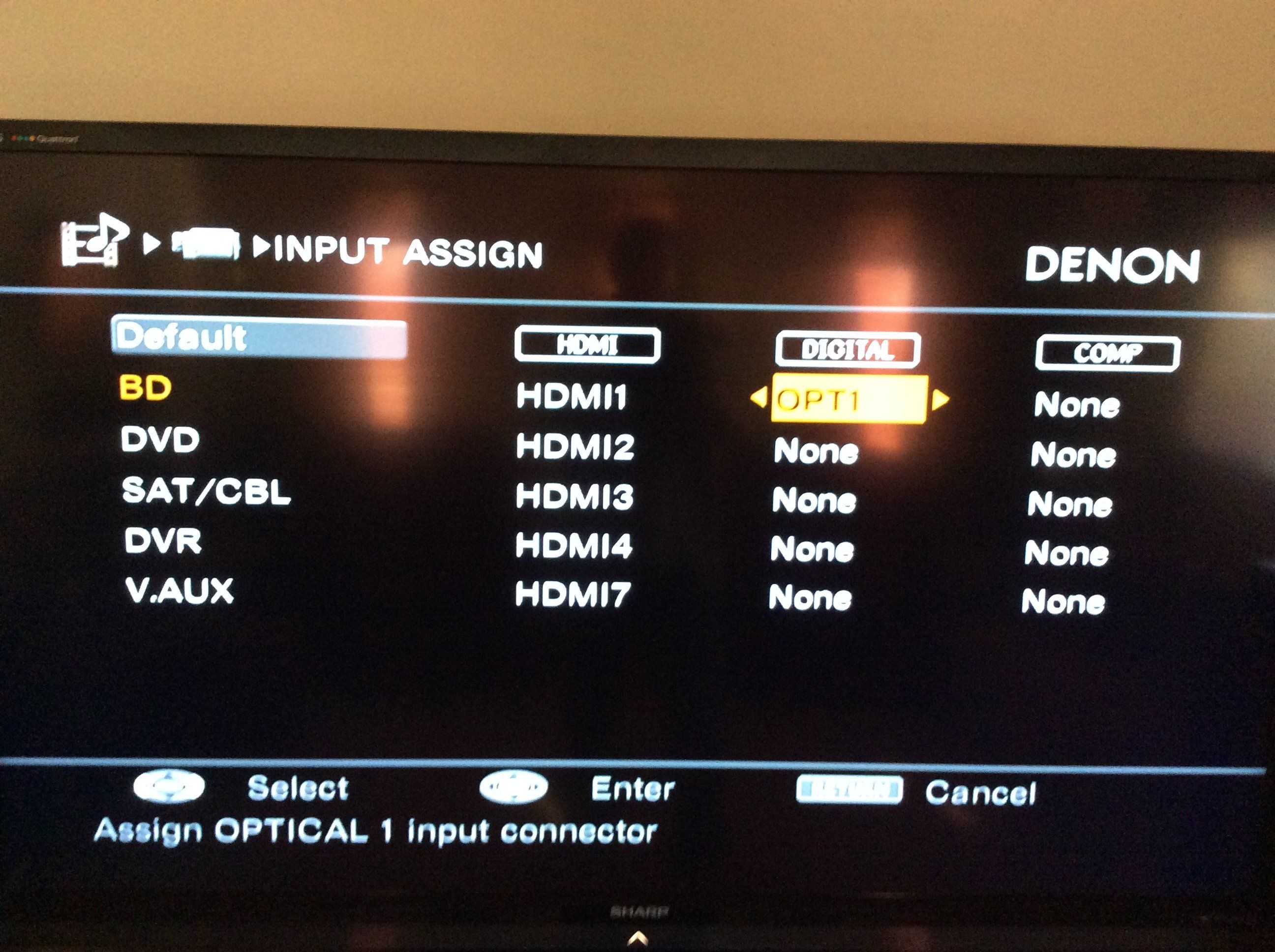

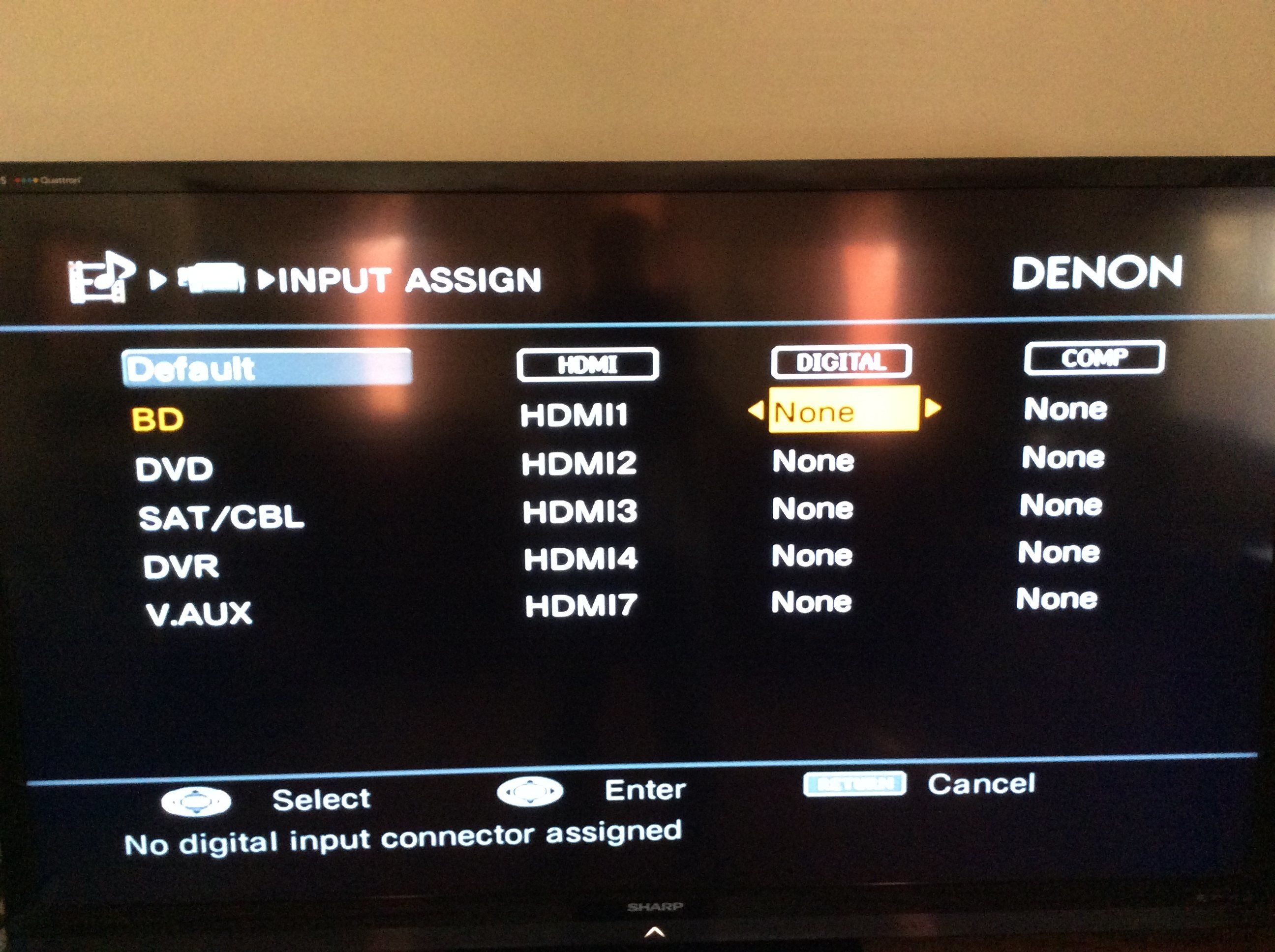

Well I've come across an issue with getting audio from my optical cable. Simply put, I'm not getting any. I tried two different optical cables running from my 722k to my Devon receiver. I get the picture but the challenge for me is what input to select for the Denon. This may be more of a Denon question but I have the optical plugged into Opt.1 (tv/cable). There are several selections on the Denon one begin tv/cable but that doesn't work. I even tried running my component cables from the 722k to the Denon then out of the Denon to the TV and attempted to assign the optical that way. Doing this I didn't get picture or audio. Can optical be used while having a HDMI cable also plugged into the 722k? I have that cable for my Xbox One. I'm at a lose now and need some advice.
The Denon inputs are selectable. You have to tell the Denon which input to use for which assignment.....
Yes I've tried the two scenarios as mentioned above. Unless I'm not following your response fully.

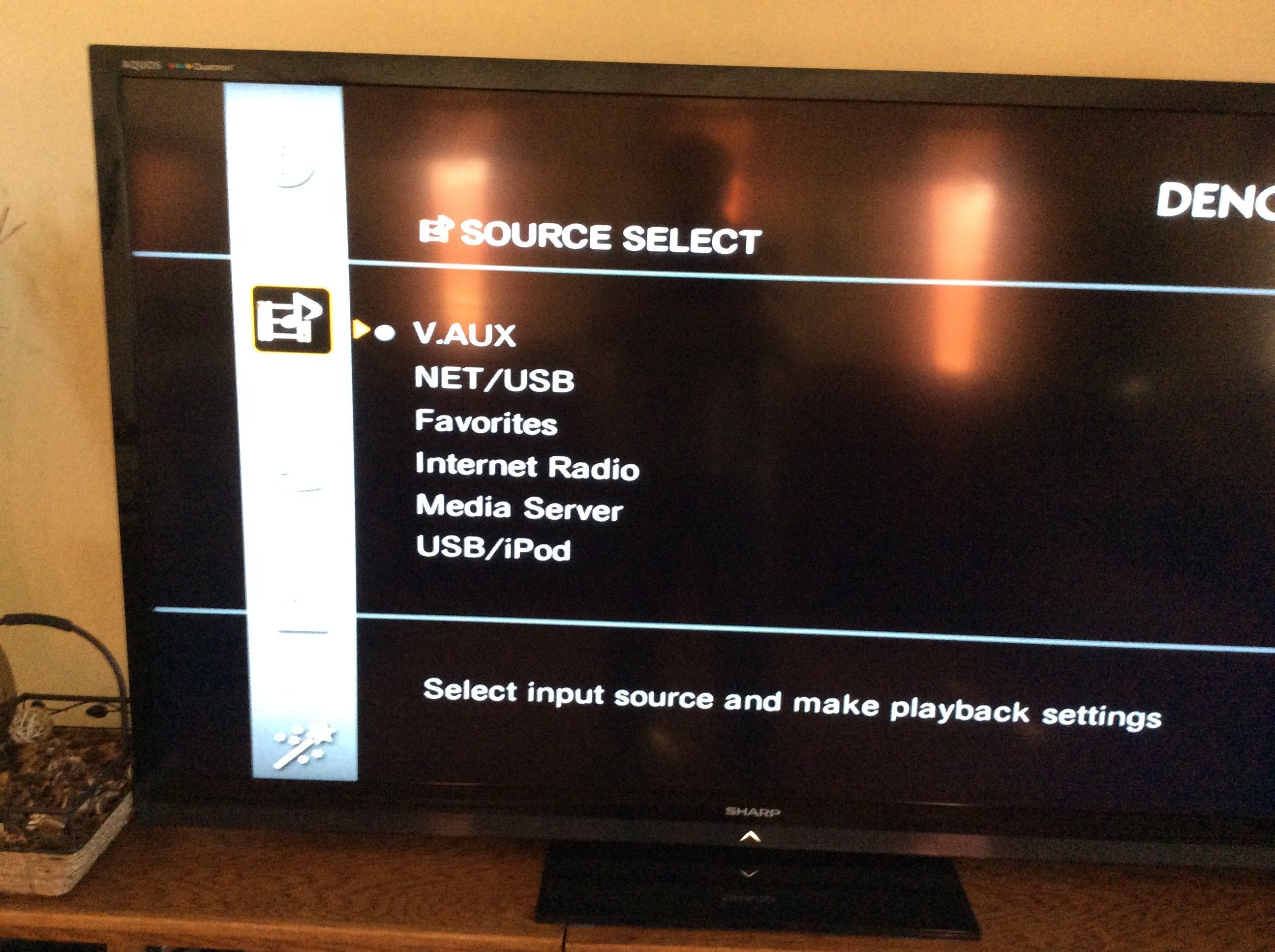

The Denons have a menu that goes up on your TV screen, if you have it hooked up. Within the menus are a spot to assign your inputs and tell the Denon what type of input you want to use. See the following images:
I don't recall seeing this menu, ever. How do access this menu? Thx for the heads up!
