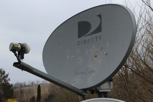

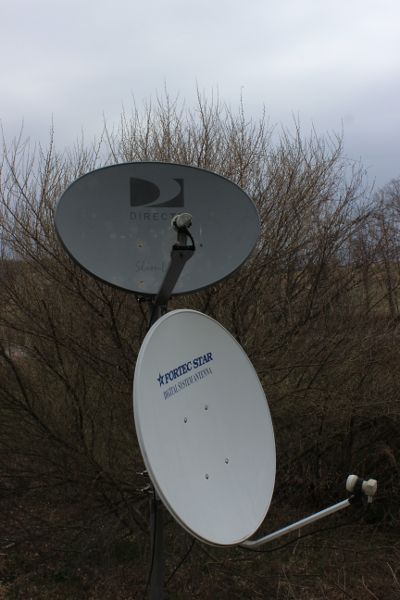

I measured where the original lnbf was and used a standard FTA lnbf with a universal mount. Dish is at zero skew, lnbf is skewed. It is mounted on top of the pole for my motorized ku dish. I rushed putting this up during really cold weather, :snow which bothers my hands horribly, so it likely can be dialed in a little better but so far it has worked great. :D
Images below are thumbnailed - click for larger view.
View attachment 144401 View attachment 144402
Thanks for the pictures and the info i would like to try it this way now which would mean i could use a dish that doesnt have a skew setting and i have several of those lying around.
