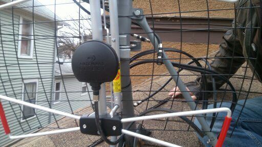

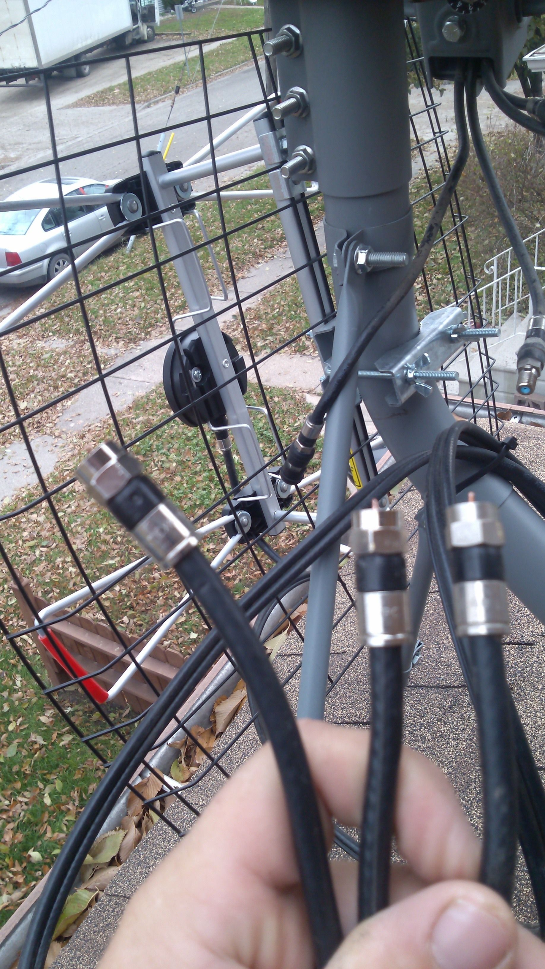

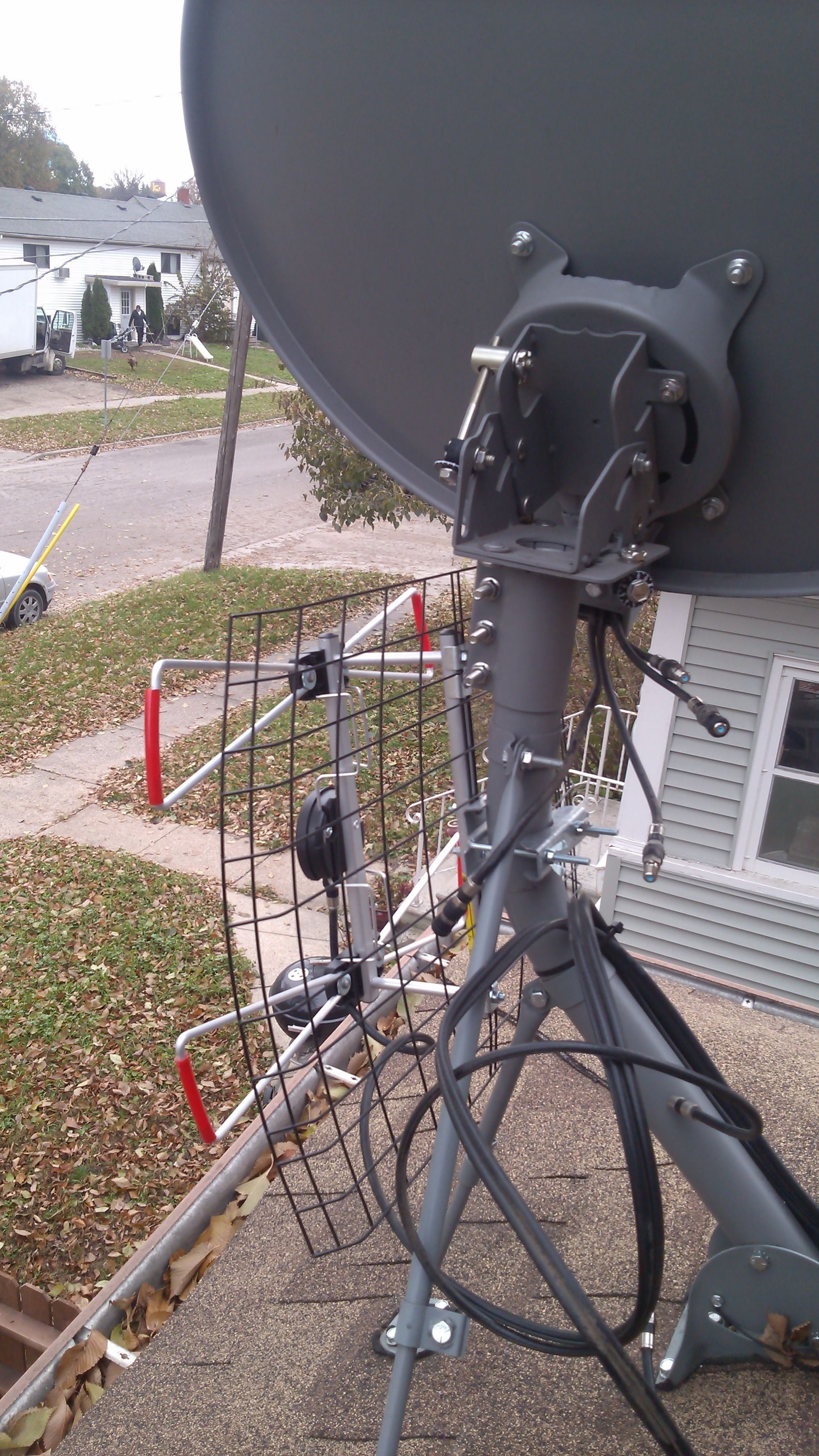

It's an Antenna's Direct brand outdoor antenna that I have had hooked up and used in my house as recently as 3 weeks ago. I have it mounted on the old DirecTV dish mount that was here when we moved in in July. It's about 15 ft off the ground and east facing in Fargo ND.

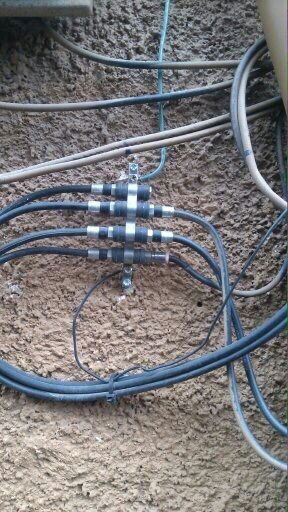

The first pic is the cables at the dish (with one still attached to the antenna) and the second is a spot on the side of my house where the cables are re-split into 4 and 3 are run into the house and one is blunted off. This makes sense as there are three coaxial cable points in the house. (Bedroom, Living Room, Basement) I had my converter box hooked into my bedroom TV as I tried all 4 cables into the antenna and got a signal from none. When I've had the antenna hooked up in the house sometimes I get a pretty weak signal, but it always picks up stations after a scan and it did not with the antenna hooking into the DirecTV cables

Wow, I had that wrong! I thought you were trying to get an FTA satellite dish working with one of the DirectTV cables, I see from the pictures that it's an OTA antenna! Ok, disregard my previous post! Check what Lak7 suggested, that there isn't a satellite switch somewhere in the cabling, it'll look something like a splitter. if there's a switch somewhere, it won't pass the OTA signal.
If you have an ohmmeter, with both ends of the cable disconnected, you can measure from the center conductor to the outer and it should read infinite, no continuity, if it doesn't then the cable is probably bad, or there is a switch or something somewhere in the mix. If that test is good, with both ends of the cable disconnected, short the center connector on one end to the outer and measure across the center and outer connector on the other end, you should have continuity that way with very low resistance. If the resistance is high than the cable is probably bad, or a switch or something is in there somewhere.
Check that the cable is RG6 and not RG59. It's probably [and should be for an OTA antenna and DirectTV] RG6. IT should be marked right on the side of the cable somewhere what it is. RG59 doesn't work well at all with OTA signals.
If the cable run is real long you may need a pre-amp to boost the signal, how long is the cable that you're trying to use? The F-connector on some of those Antennas Direct antennas break loose very easily, check that it doesn't feel loose and wobbly, if it is, the connection inside of the junction block may be broken. That one looks like a DB4 or a DB4e maybe? Those are decent antennas for the size and price.

You could try bypassing that grounding block in one of your pictures with a splitter or double F connector just to eliminate that as a suspect. I doubt it's that but it's easy enough to do and could possibly be the culprit.
