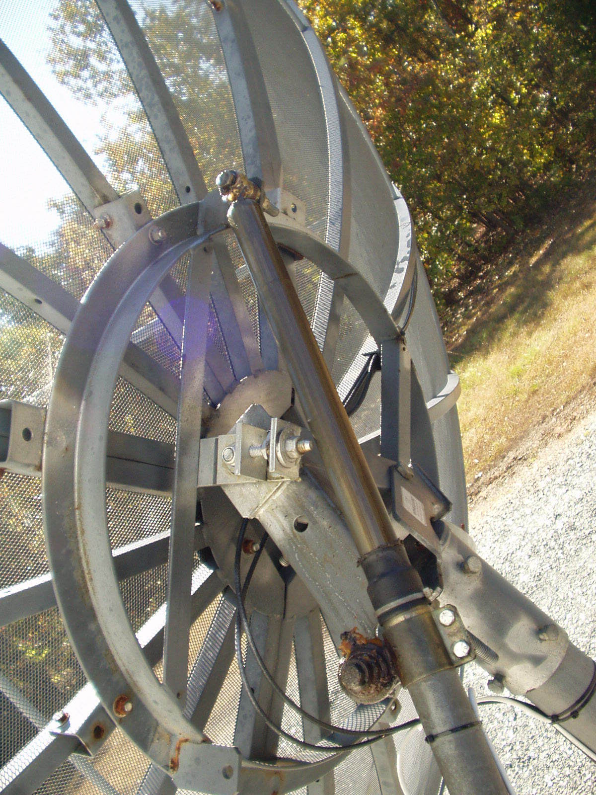

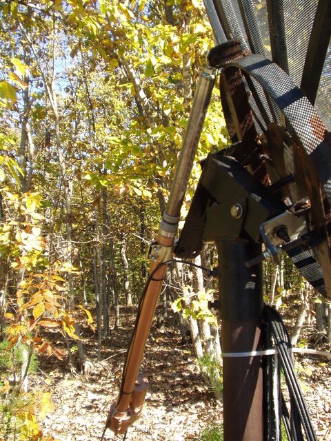

What limits my travel is the physical limit of the polar mounts in relation to the linear actuators. I took a couple of pics to show what I mean as right now both are almost at a point of contact with the inner tube of the actuator and the upper dish mount pivot. I could probably make some 1 or 2 inch spacers to lift the actuator up to clear these obstructions but I can't receive anything past 37w because of trees that I don't want to cut down. Keep in mind that I'm at 79* due south and my actuator is mounted on the West side. The Unimesh is the pic on the left and the Winegard is the one on the right.
Oh, and that 7.5ft SAMI dish I gave away a few months back would cover 37w back to 139w also with a 24" Super Jack actuator.
That 36" is probably going to be way more than you need for the distance you're covering. Both my 10ft systems have 24" movers and are nowhere near the end of travel and I'm looking at 37w back to 139w on both systems and that Unimesh will actually get to 34w with some to spare but I don't have that bird programmed in.

View attachment 92184View attachment 92185
Side note... I "assumed" it was a 36" because it was so big compared to my other actuators, but after measuring it today, it is a 24" Von Weise.

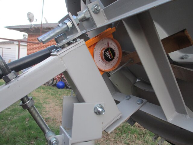

I have returned to play with my "toys" to look something else:D

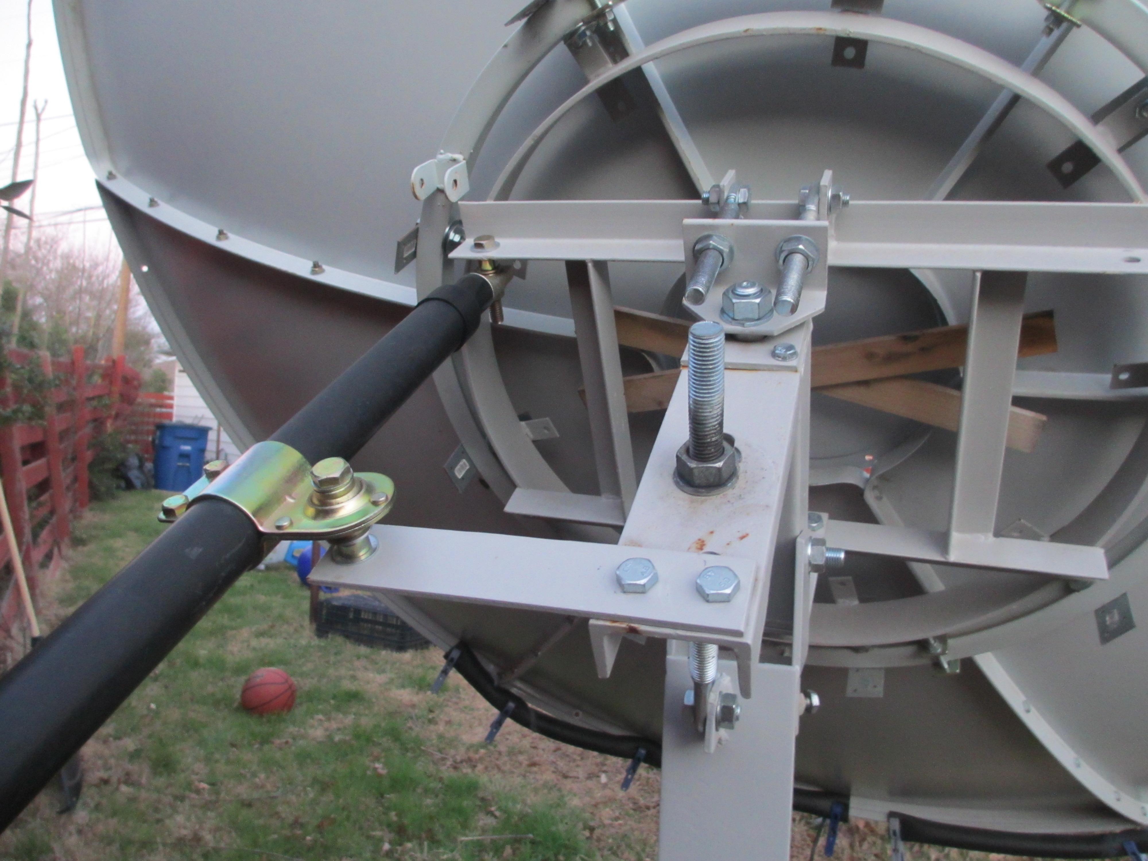

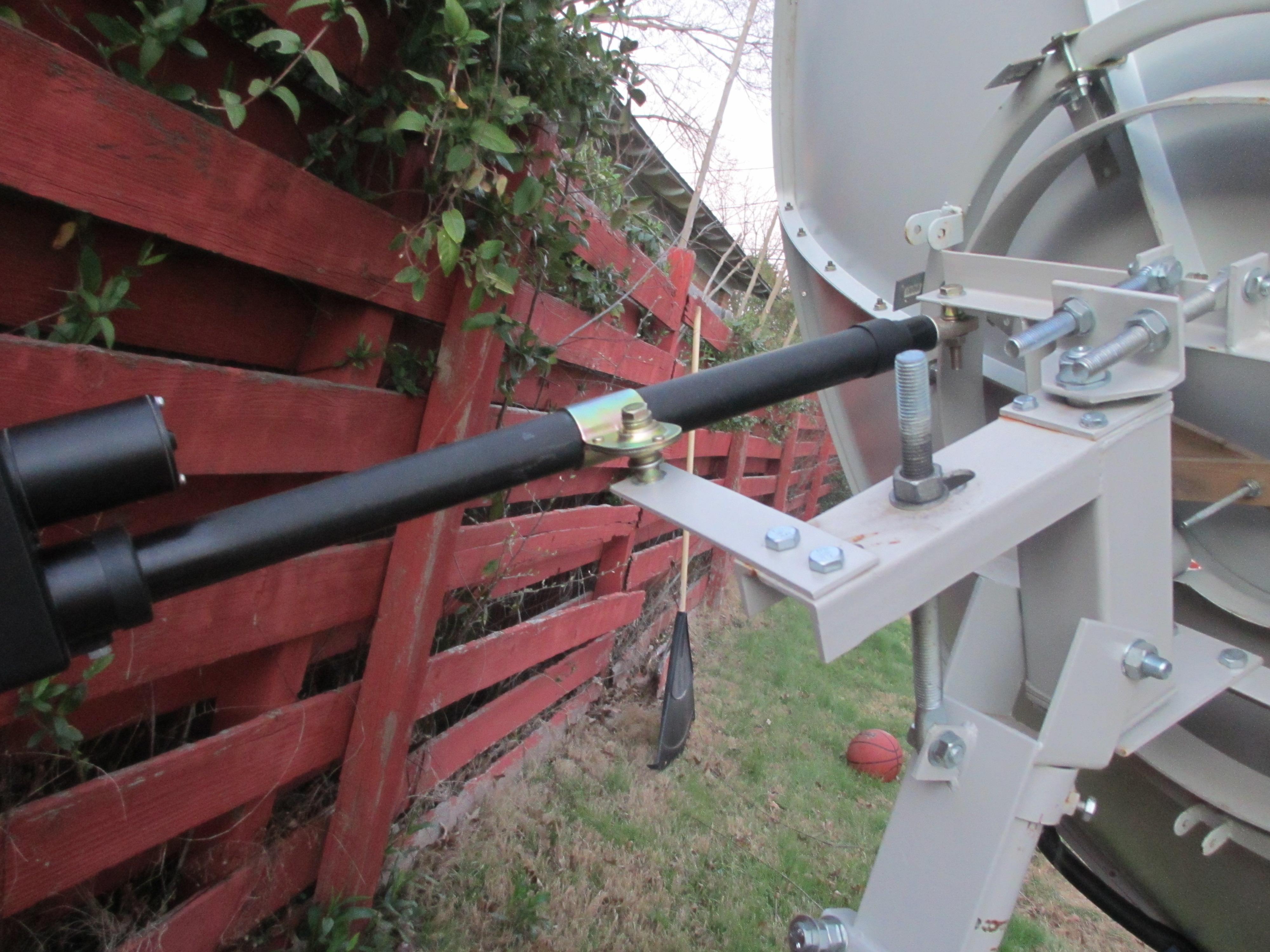

I have installed the actuator on the east side. last weekend I have tested my Vbox with the actuator and moves well.
Reading the information I know that the first step is to Aim at my Highest satellite that is 97.0W due my location is at 96.67...and set my elevation or motor latitude & my declination. Right now my dish is still aiming to 58.0 w and last wekend I have tried to 45.0 W & 50.0W manually (with my actuator retracted or closed ) and i got some signals on some Tp's. so according with my installation "blocks" and view horizont I wish that 45.0W satellite could be my low satellite with my actuator retracted (closed)
My first step is to get all satellites posible between 45.0W to 97.0W
Question: If I want to try to get My highest satellite "97.0W" I need to find it with my actuator retracted (closed)? or Open "push out"?

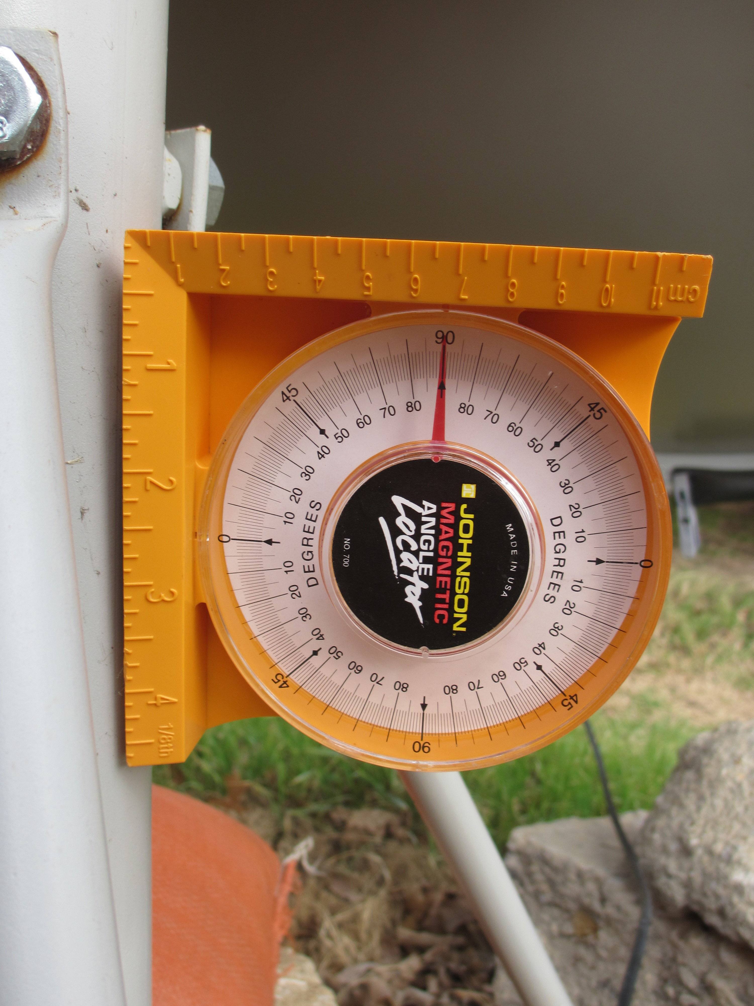

I have attached some pictures that you can evaluate my current installation any suggestions are welcome;)

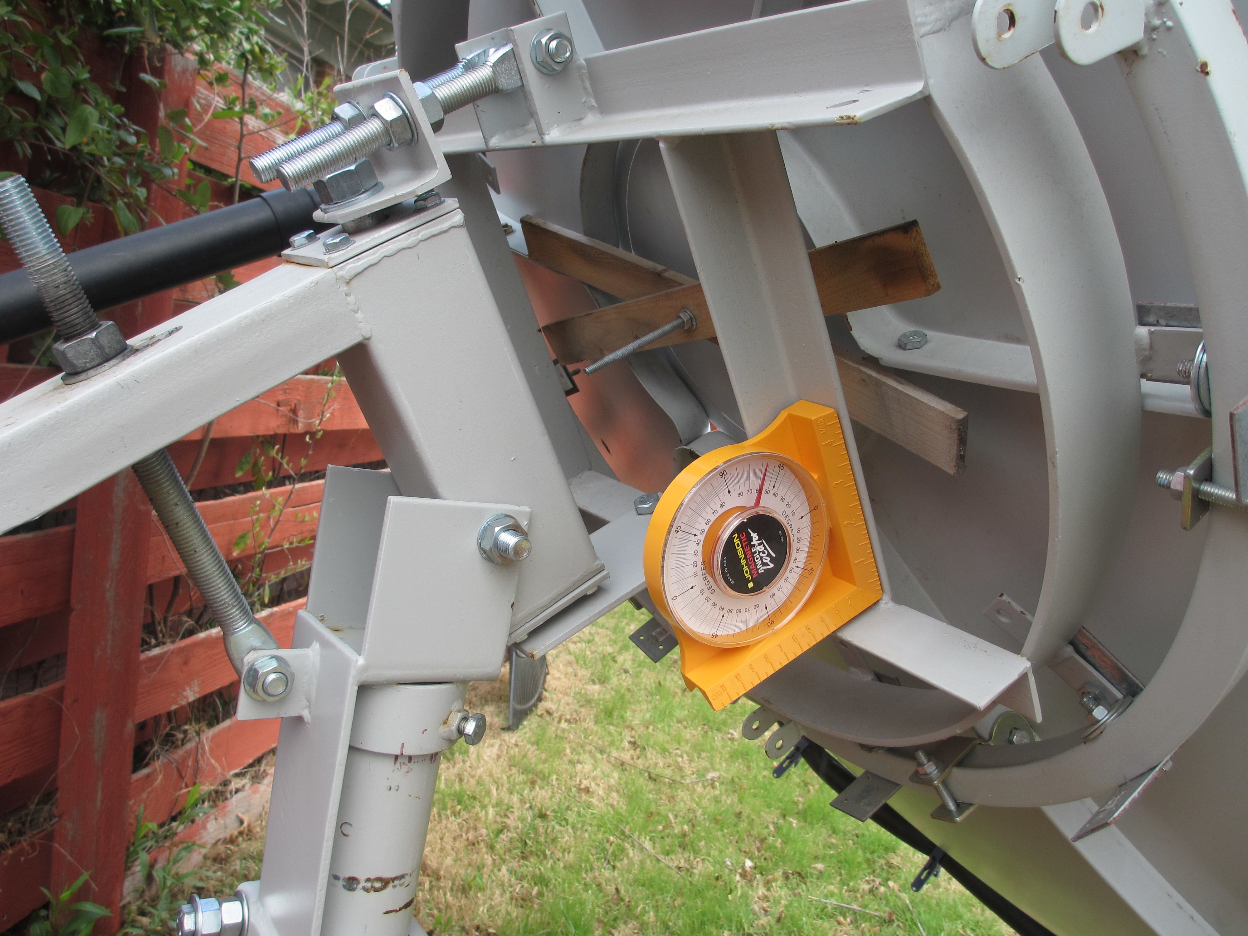

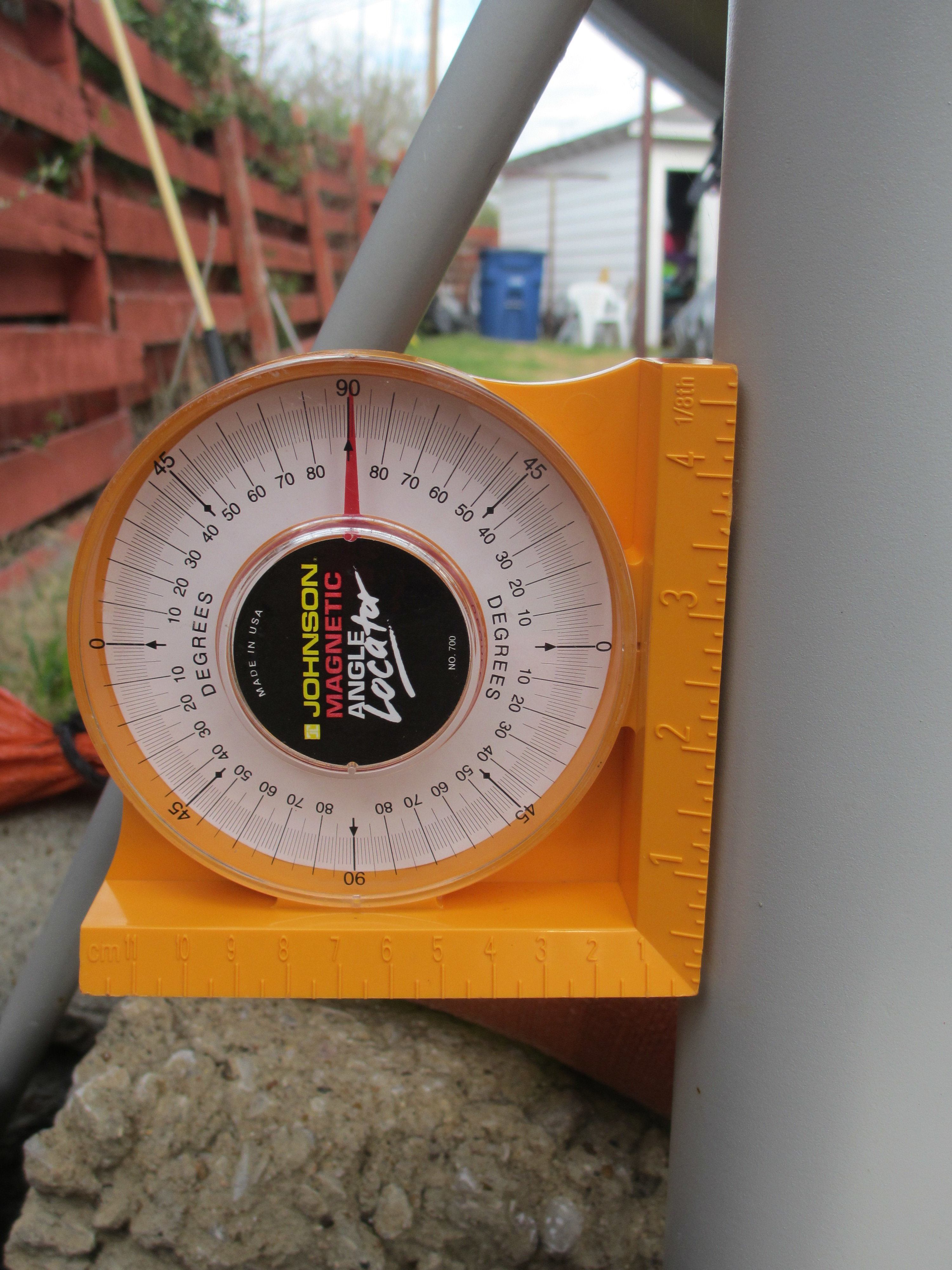

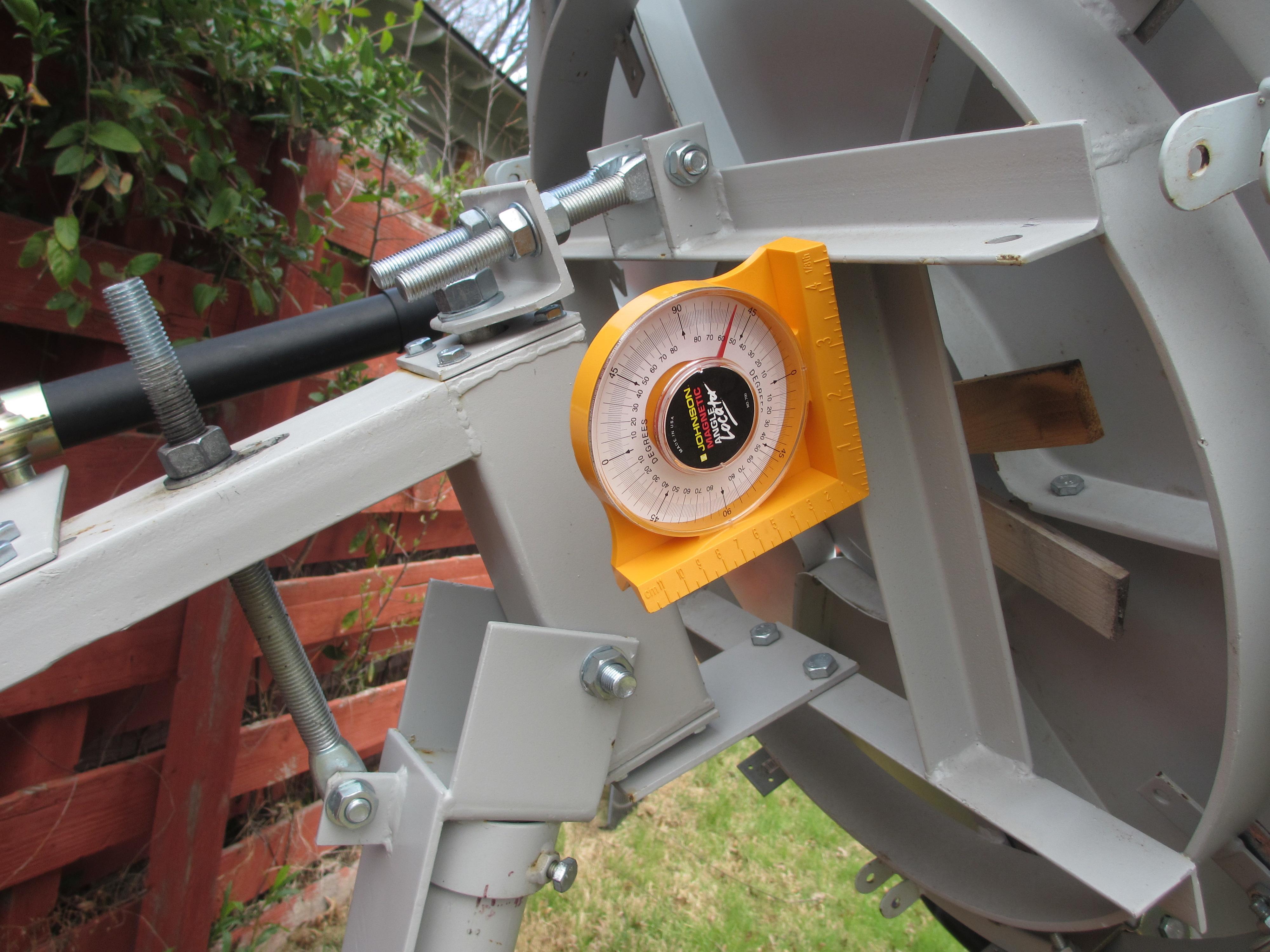

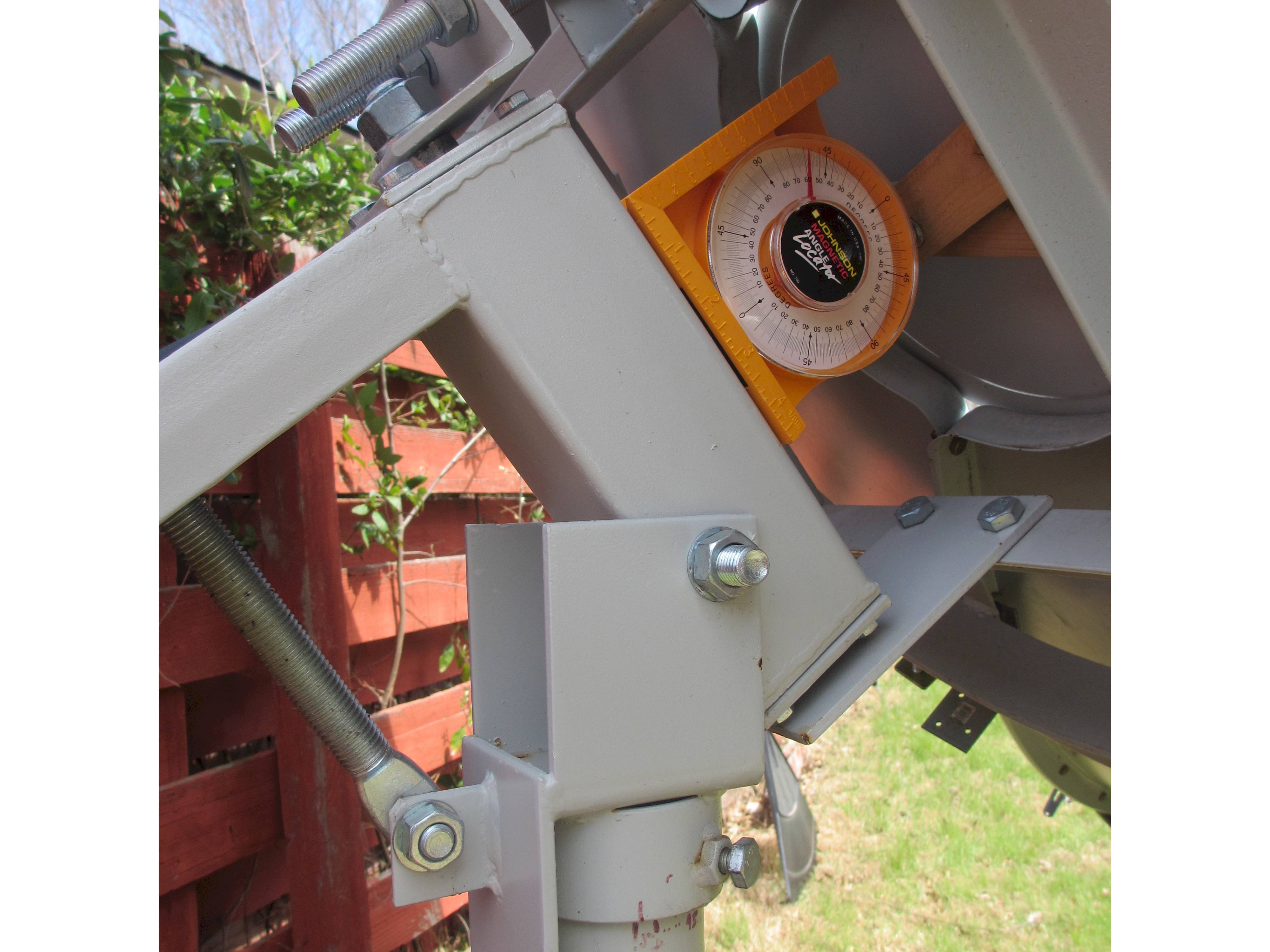

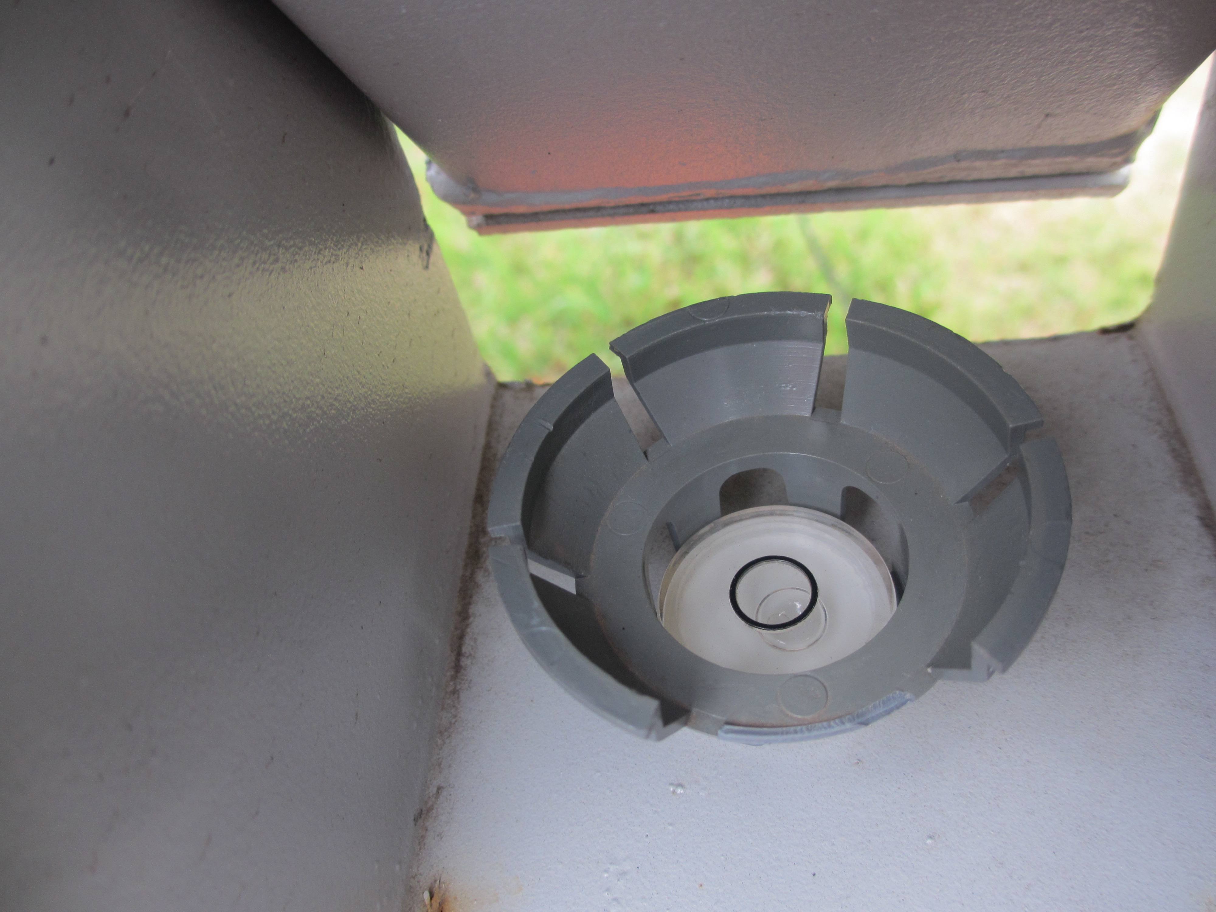

picture: 012,013 (actuator), 019(elevation setting), 025,026 (declination setting),030 bubble tool (mast plumb), 032,034 inclinometer in the pole (mast plumb)

With the dish set as in picture 1. Check and adjust declination. That's the difference of the angles measured in pic 1 and pic 3.
With dish still set as in pic 1, Set angle in pic 3 to your Latitude. (elevation)
Rotate mount on pole to find 97W (don't use the actuator)
Adjust angle in pic 3 and rotation of mount on pole to maximize Q.
Lock down the elevation adjuster. DONE
Then look to other satellites with the actuator.
Adjust actuator and twist of mount on pole to peak.
When at furthest E or W satellite, and Q is 'maxed out' Tighten up mount on pole.
Go find all satellites and program the VBox.

actuator on east side- set up. Retract the actuator fully, extend it just a little. Slide the actuator fore-aft in the clamp on the mount so the dish is just past your desired furthest east satellite. See if it will extend to your furthest west satellite. A compromise will have to be made if it doesn't. (or a longer actuator??)
Just past your furthest west satellite, set the limit switch in the actuator so as to not 'over extend'.

I have put all my parameters on my antenna, according of my location:
Latitude: 32.82.
According the declination table this is my Declination: 5.4
Motor latitude or Elevation (32.82) + Declination angle (5.4) + 90 + Elevation (51.8.) [97.0W dishpointer]=180

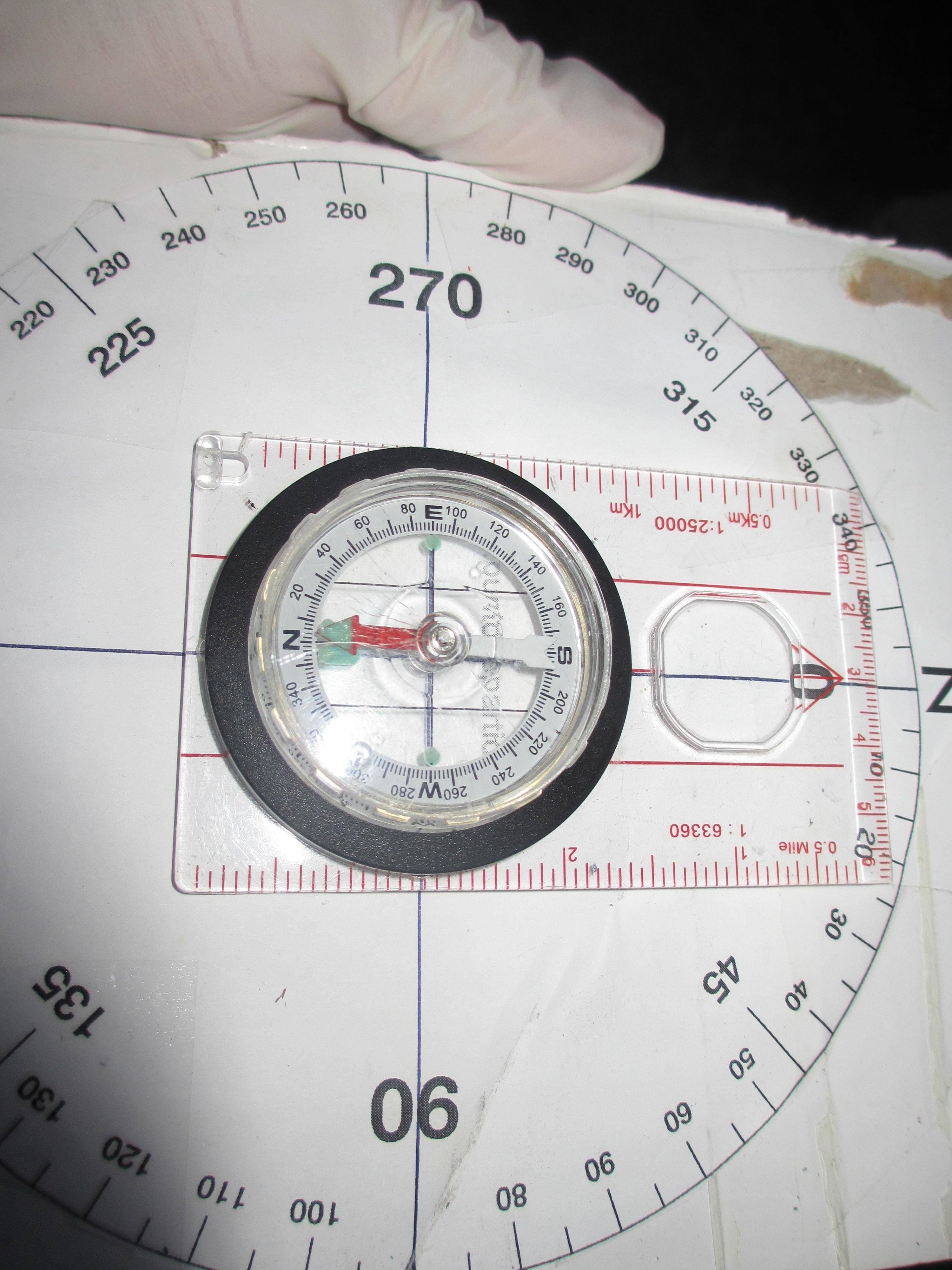

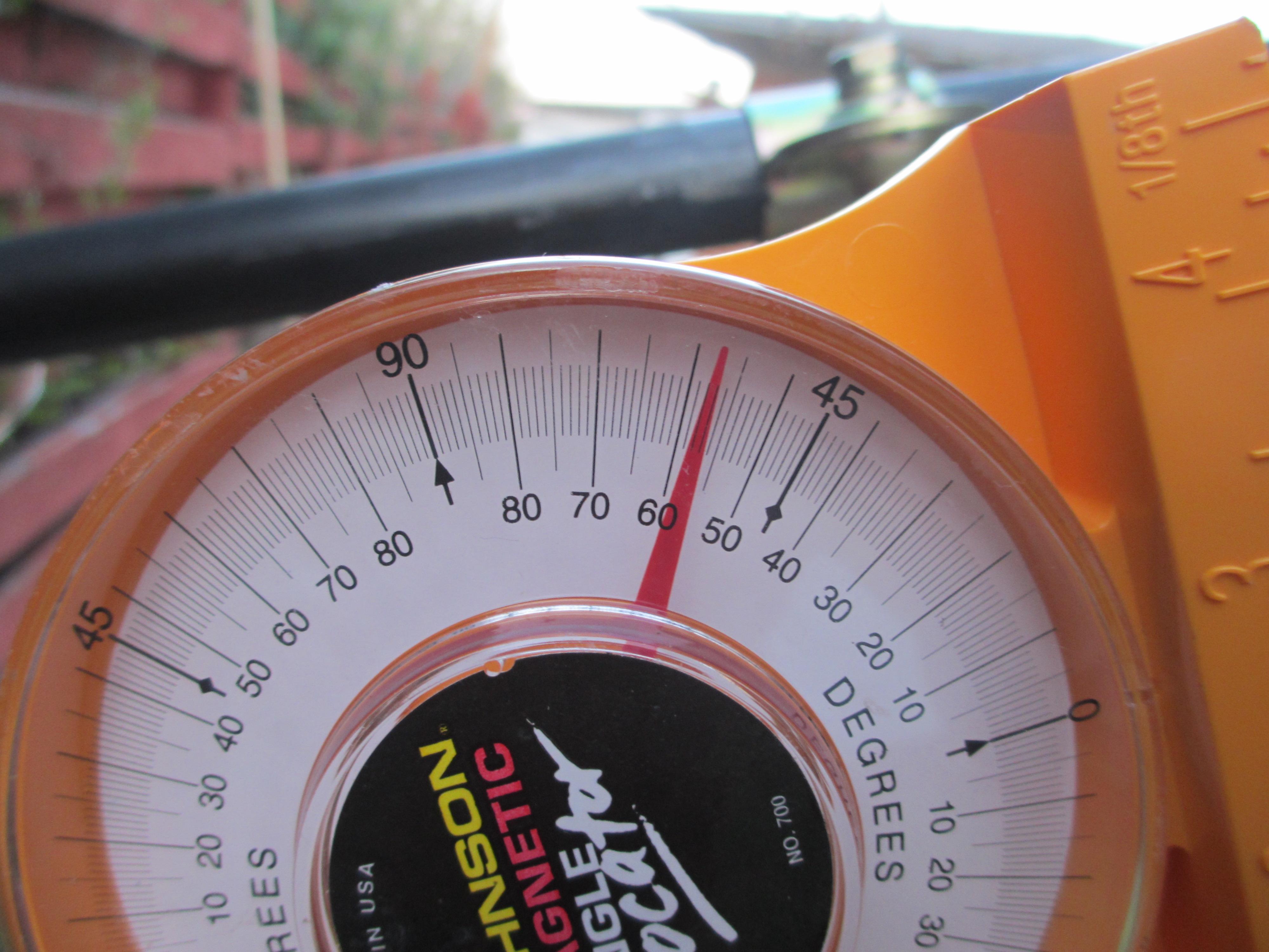

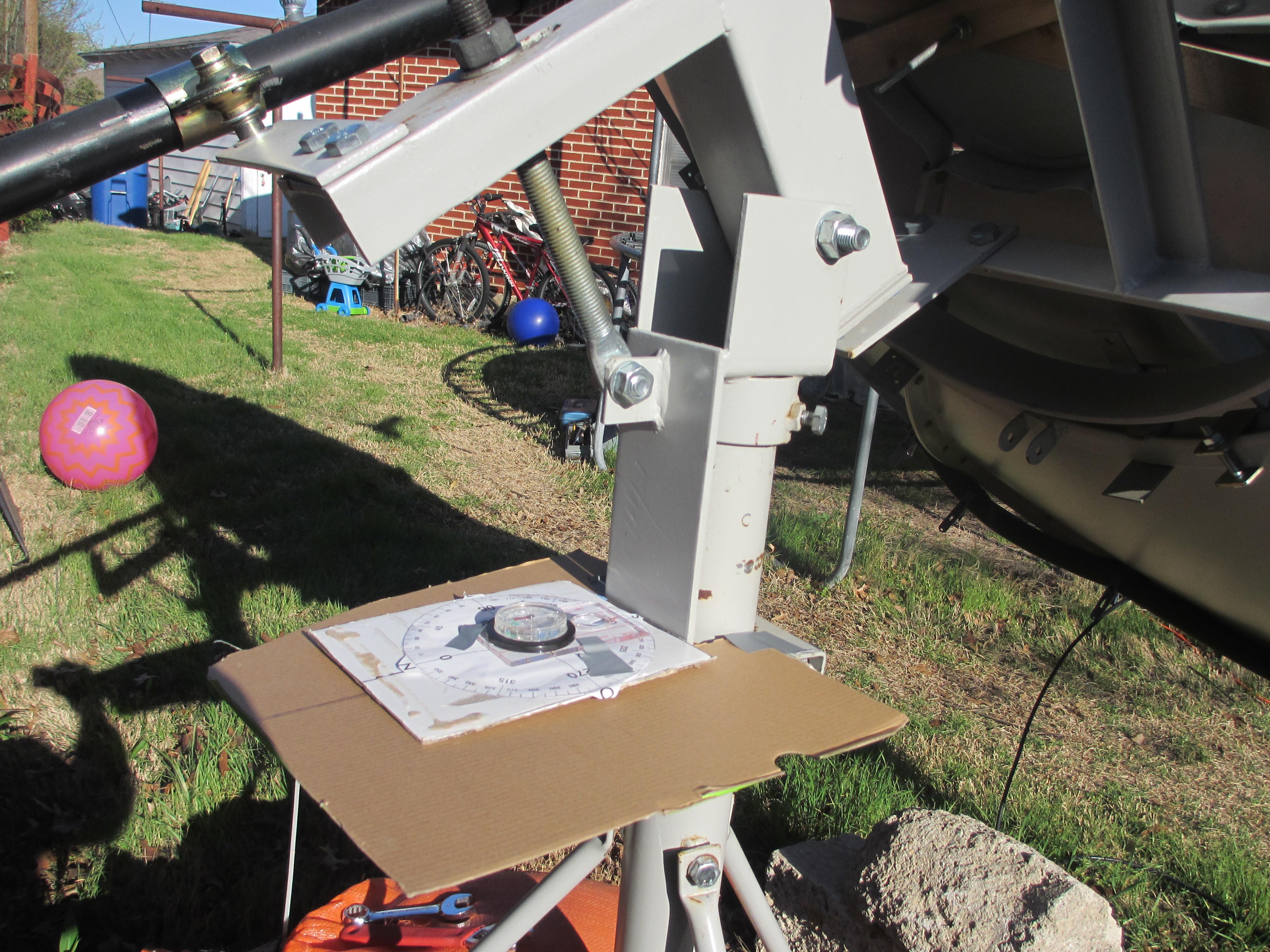

I have attached pictures measuring My parameters. You can see the value of the inclinometer tool for Elevation . And also You can see my magnetic compass aiming to North to South my antenna is aiming to South..
Questions??:I am not sure If the values taken for me from my inclinometer are correct.
I am taken since 90 to 63 = 33.. Is correct?? :confused:See pictures.

attachment.php
set to 57,elevation (33)
attachment.php
set to 52 ,declination (33 + 5)
I found these with my Coolsat 5000,
3851V 3532 sr Walk TV has pic and sound
3922V 3703 sr NoAmerica no pic or sound,but strong tp
4141H 32363 sr scramble channel
4060H 32363 sr appears to be an HD channel,just green "plaid"
I was going by the way you had the inclinometer in your pics,so 90-33=57,90-(33+5)=52.
If you can turn the inclinometer so 0 is up then it would be 33 and 38,I think,now I've got me going in circles :D.
