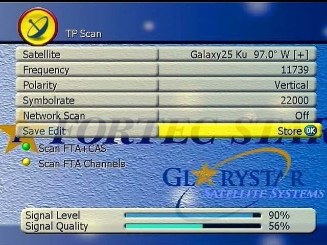

  • Scan only for the new transponder:
  1. Press the Menu key on the remote
  2. Enter the TP Scan menu screen (see attachment VBS1)
  3. Select Satellite Galaxy25KU 97.0W
  4. Enter Frequency 11739
  5. Select Polarity Vertical
  6. Enter Symbolrate 22000
  7. Select Network OFF
  8. Select Save Edit, Press the OK key

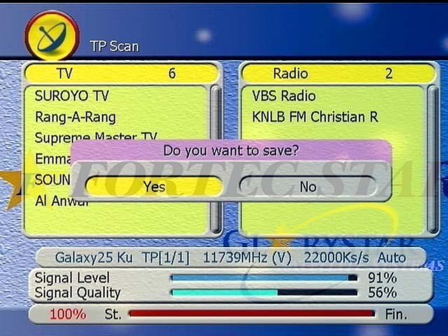

  9. Press the Yellow key to scan for available FTA channels
  10. When prompted with "Do you want to save?", Select YES, Press the OK key (see attachment VBS2)
