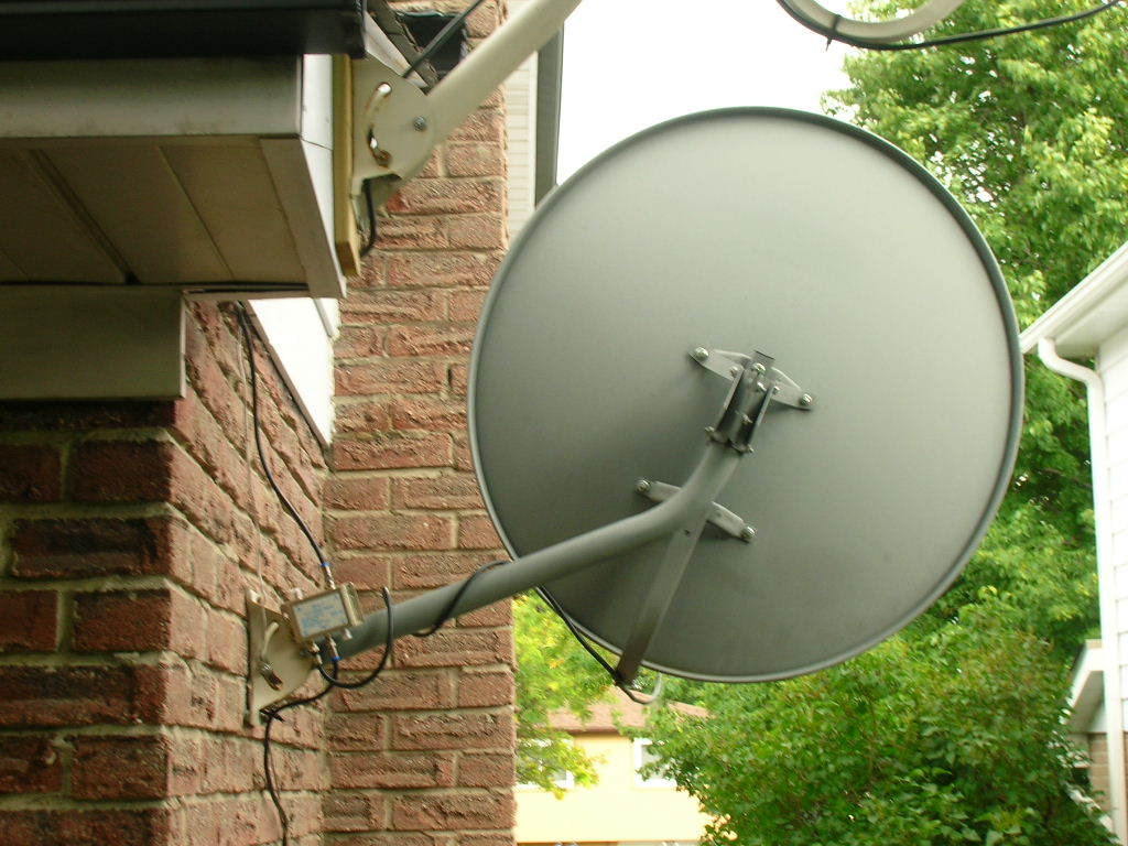

Sometimes you just have to think outside the box. I always believed that the dish mast had to be perfectly vertical to receive satellite signals. It does if it's motorized. Look at the attached picture. If I were to reset the mast to vertical then the left half of the 33" dish is obscured by the brick wall in front of it and the Q from Hispasat 30W is about 50. Nothing ventured nothing gained. So there's the end result. It works. The mast is about 15º off vertical. Had to reset the dish elevation and readjust the LNB skew but now the Q is about 70 and all is well. The caveat is that to do the initial setup the mast must be vertical otherwise finding the sat with the mast at that angle is almost impossible. Oh unless you have tried this don't say it can't be done or it won't work.

I dont think anybody has ever said it wont work. It wont work on a MOTORIZED setup

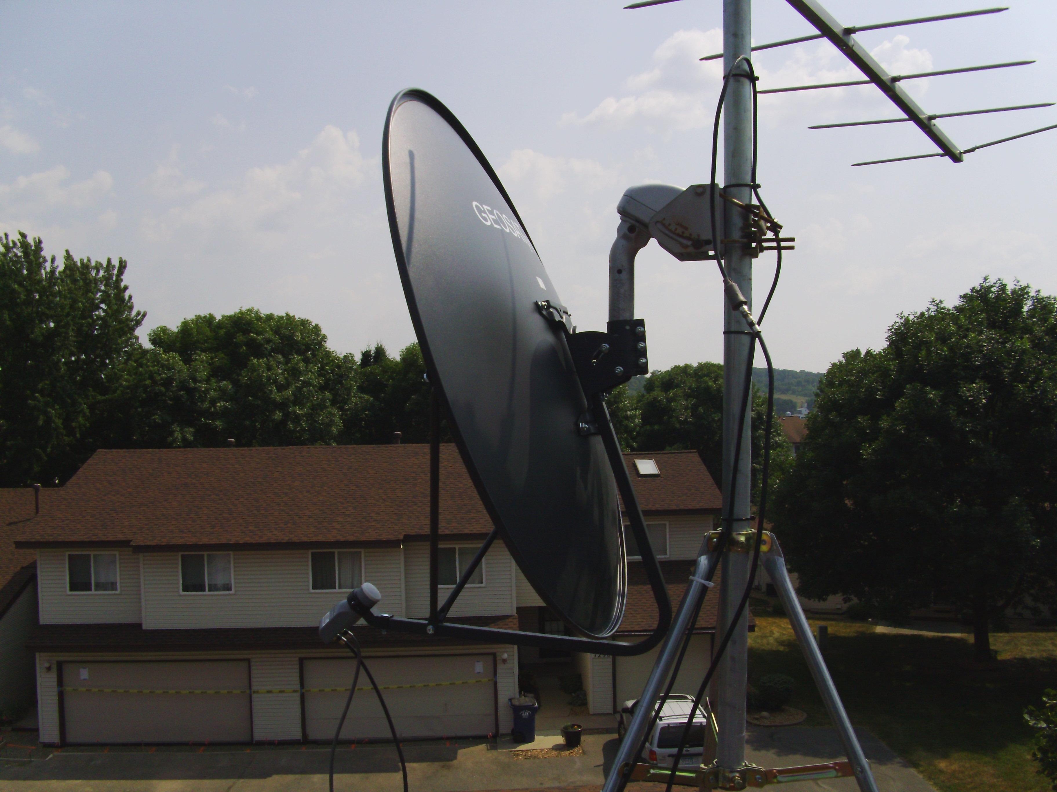

damn when I had my setup I use to rig up weird mast setups for 30W no issues. When I mounted it on the TV aerial mast I had a oddball mast + a non straight motor shaft :)

The mast doesn't have to be plumb for a static setup, but you may not be able to adjust the skew enough with it tilted.
I wouldn't recommend an off-plumb mast to a noobie, except in very special circumstances (almost never). :)

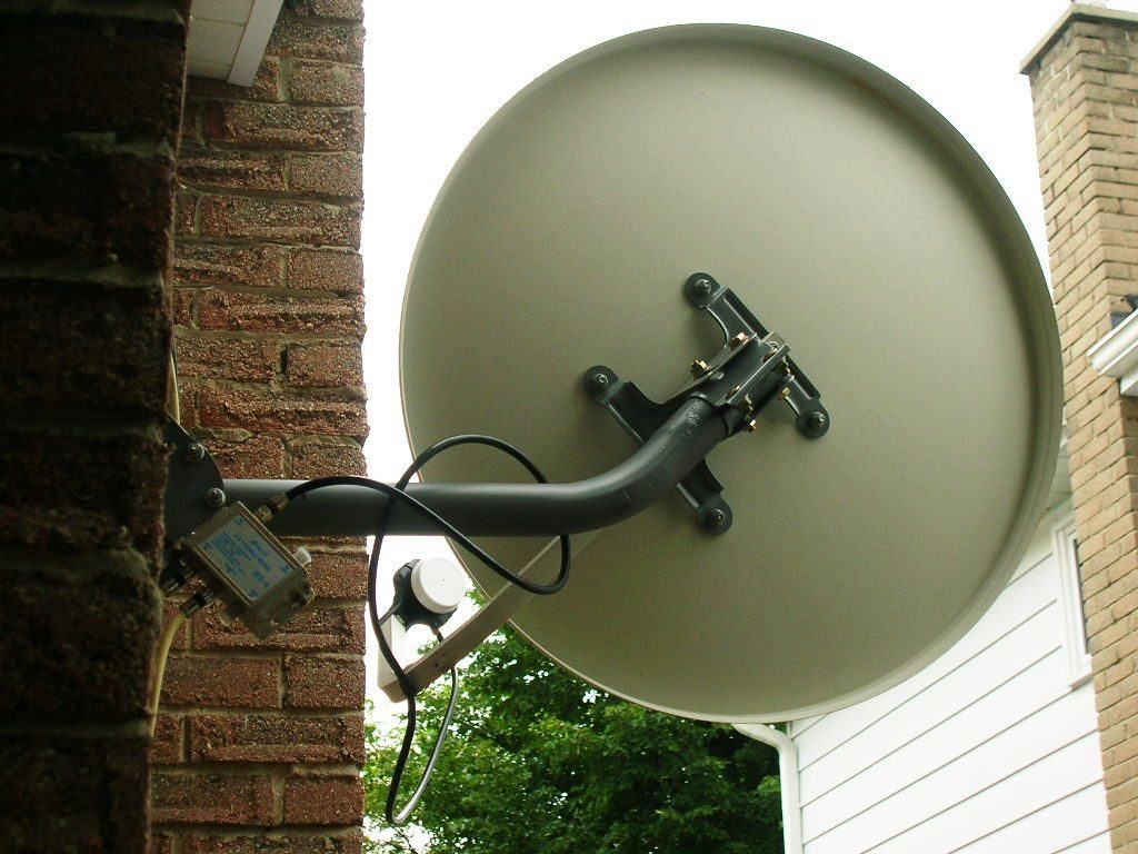

Here's my latest iteration. A 25" dish with Avenger PLL LNB viewing Hispasat 30W.
Yes the mast is horizontal and it works. Both dish and LNB are heavily skewed, the Q is 70.
But its been raining, heavy at times, since last night, the Q is zero. Definately a fair weather dish setup.
This is not a recommended way to install a dish, don't try this at home. Not recommended for a motor install either.
This is simply me having fun pushing the limits to discover what can be done and what can work.
Must have a lot of time on my hands!

Necessity is the mother of invention! Don't know who originally said that, but it's been proven time and time again by folks just like us.
Hey, stuff like this is part of the fun of this DIY hobby, IMHO. I like being different, I like saving money and I do love to learn to do new "stuff"!
