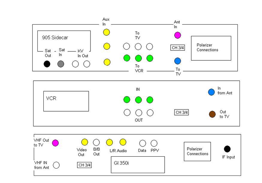

I seem to have bollixed up the analog reception/output to TV screen while trying various connections. If I switch off the Sidecar, I get snow instead of the blue menu screens.
I took some photos of the back of the units before I started messing with the cables, so I may be able to get back to Square One.
Stay tuned for further developments.
Thank God for foresight. Working from the photo, I've got my analog back. No VCR yet, of course, but at least I'm no longer further behind than when I started.
If I've done it properly, there should be attached a primitive MS Paint diagram of how things are currently connected. Uncoloured circles have no wires attached, colouring shows what is connected to what: yellow to yellow, green to green, etc.
This may help someone tell me where I've gone wrong.
Thanks.

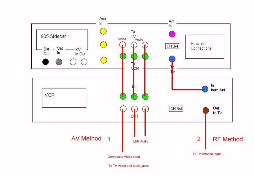

I modified your drawing. You can use either method 1 (AV Hookup) or method 2 RF. They will work if done correctly. If they don't work something is wrong with either your your VCR or sidecar.
Tvpro,
Thanks for your reply. The AV method won't work as a permanent solution because the TV is on the other side of the room. I will hook up a portable to test it out, though.
Your RF method is what I have now. Blue to blue and then out to TV.
I'll try to set up the portable with rabbit ears and hook it up to the VCR to see if the VCR's autoscan can find anything and try to record it. If that works then, I guess, it's back to the drawing board.
