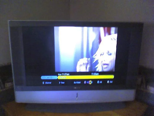

Anyone else using the "native resolution" output feature on Voom? (voom sends video in native resolution, so 1080i comes 1080i, but 480i comes 480i without upconverting)
When I use this, it works great most of the time. However, sometimes when I switch from a 480 program to a 1080, the video only shows the upper left portion of the 1080 screen (cuts off the rest), and it appears like it's a 480-size box on my screen. Switching channels a few times resolves the issue. Anyone else seeing this?
The reason I am using the native switcher is that my TV (Sony WEGA KF-42WE610) does a much better job at upconverting the 480i than the Voom box does - otherwise, I would just leave it at the TV's native resolution).
Thanks...

I have not seen this. Can you provide a picture of it?
I get it ocassionally when using DVI as the output (syncing) vs Component. I don't think it is native res related. It blows out pretty quickly to a full screen.
Picture...
No, I don't watch "The View"... but you wanted a picture, so here it is. It doesn't happen every time. It took about 4 switches back and forth between SD and HD before it happened. Interesting to note that the show is in high-def, but the guide being displayed is in SD. So, it's possible that it's the TV instead.
I've had this happen quite a few times. Sometimes the image will be even smaller on my screen. Wonder what does this? I would say it's the STB.

Correct...
You are correct Sean. This only happend in the conversion between 480 and HD. If I leave my settings on 720p (native for my tv), then I never see this issue...
