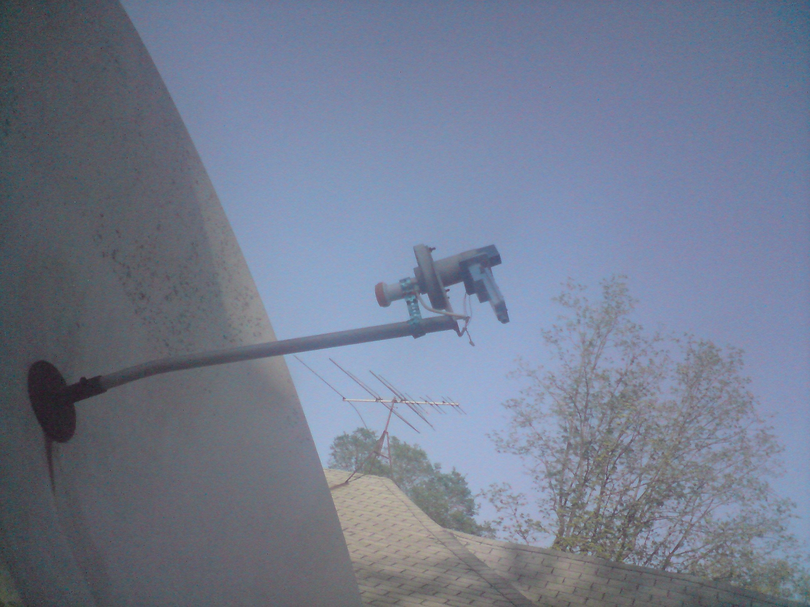

What kind of dish is this? Six foot may not be good for Ku, depending on what type of dish it is and how the LNB is mounted. A picture of your LNB and how it's mounted on the dish might be helpful, or the type of dish and the model of the LNB.

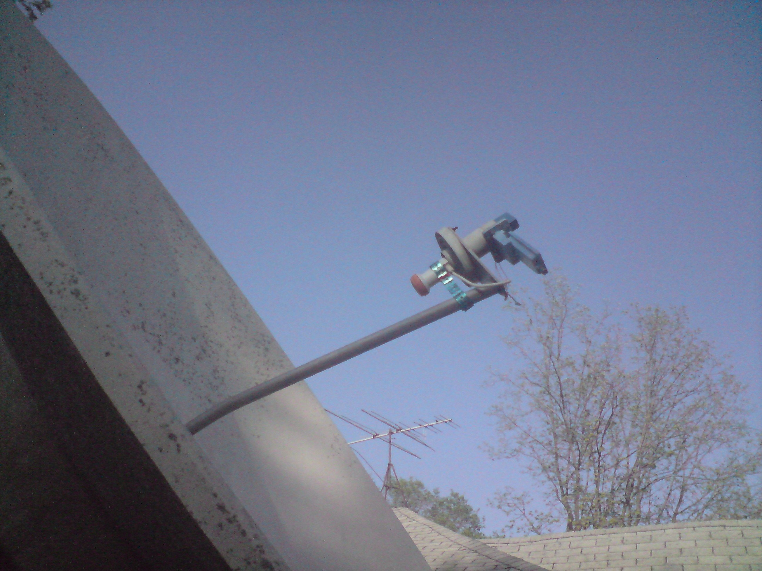

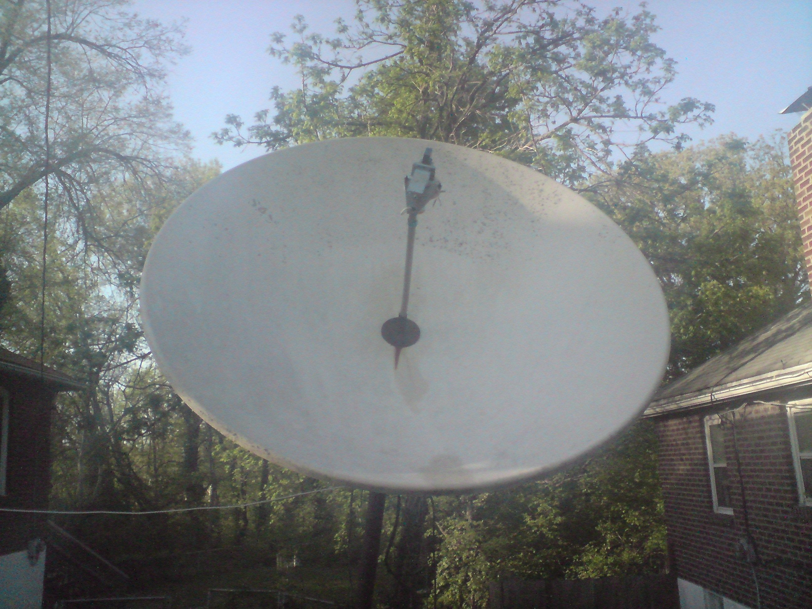

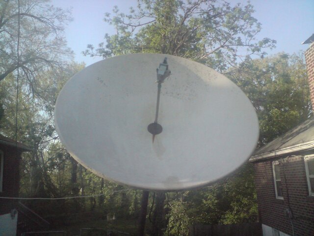

DSC00301.JPGDSC00302.JPGDSC00300.JPGDSC00298.JPG I have added picture of the dish and LNB used ,I am a beginner i really do not know what i am aiming for . i first wanna get any channel then i can try to aim for some specific ones .i also don't have any meter with me to detect the sognal or orientation of the dish ,(not too sure where my dish is aiming right now) the blue LNB was found on the dish i do not have much information about it but it was used with a drake 324 earth satellite receiver i struggle to take it out so had to hook up my LNB (orange ) with out taking the old one out .My LnB info : Universal Single KU LNBF RF Frequency : 10.7-12.75 GHZ IF frequency 950 -2150 MHZ Lo frequency 9750/10600MHZ noise figure 0.2db .Thank you so much for you input.
As mounted, the Ku LNBF isn't going to work. It is too far in front of the focal point. (dishes are large 'lenses') The focal point is about a 1/4 in inside the piece it's in front of. (Feed throat) * That Ku LNBF might work if it replaces the feed throat leaving the scalar** in place. Placing it's face about the same place as the existing feed throat. BUT aiming a big dish is very, very, touchy at Ku frequencies.

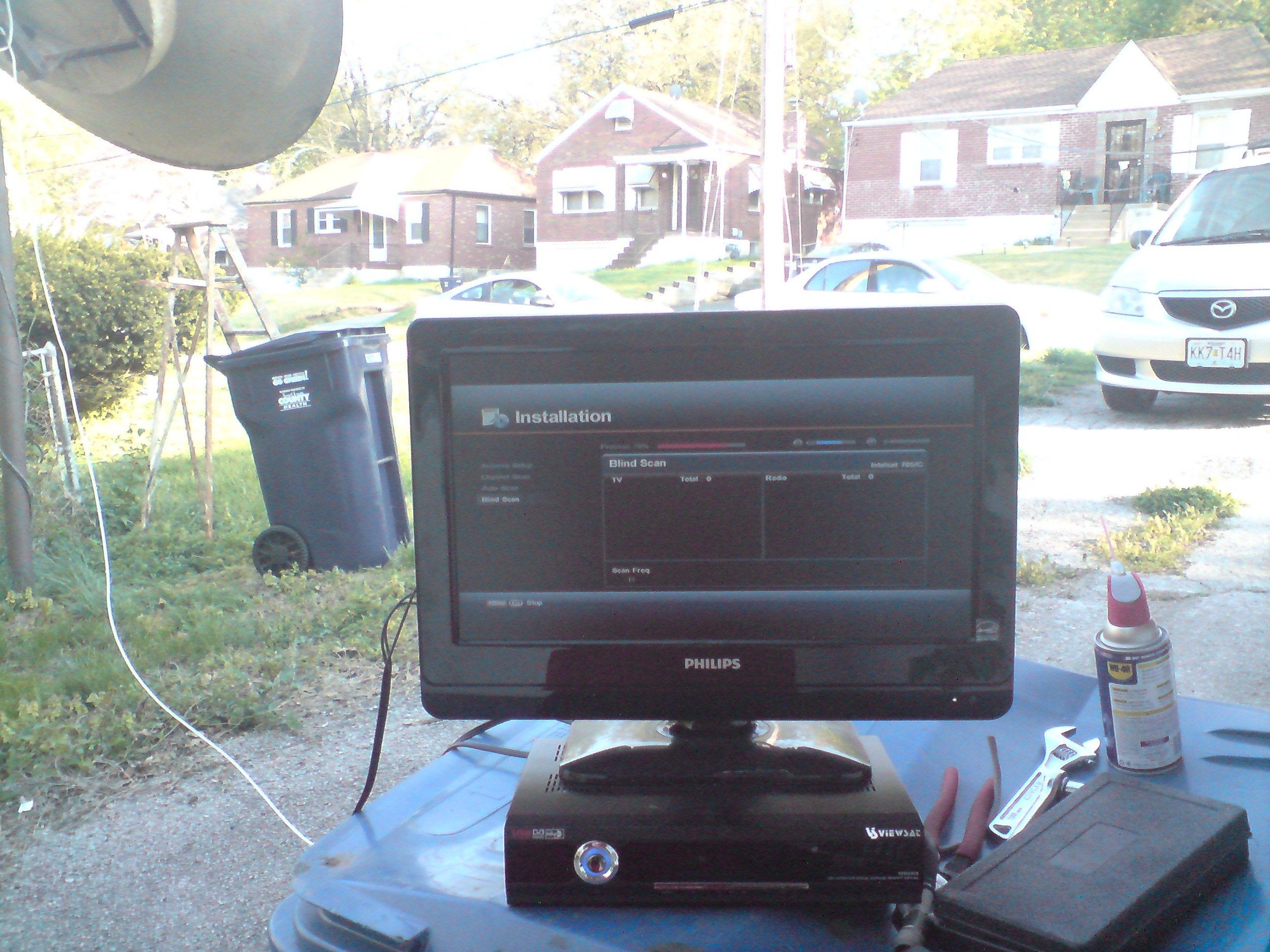

For 'giggles' and maybe finding out 'where' it's aimed. Remove your Ku LNBF and connect the coax to the existing LNB. Then, in the receiver, find Blind Scan^, and do one. See if it gets any transponders and shows something for Quality. (might get lucky and see a channel even)
^ in the set-up change the L.O. to 5150, then blind scan.

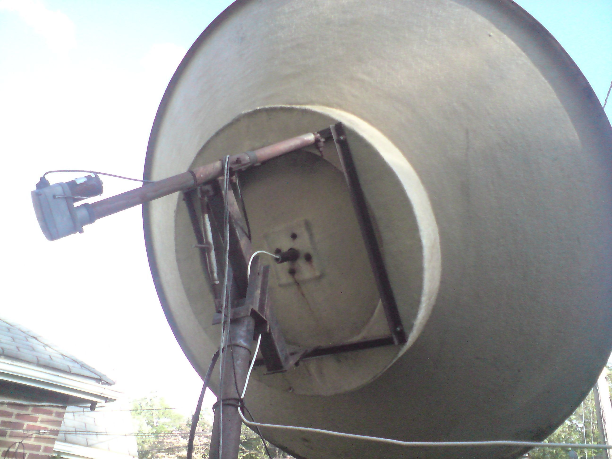

Picture of the backside??
i will definitely post the picture of the back of the dish tomorrow , i had hard time removing the old LNB (blue on the picture ) the screws are old and rusty, I might need to cut them or something.I still have the old receiver but the motor system broke . will try all the option that you talked about and will let you know .

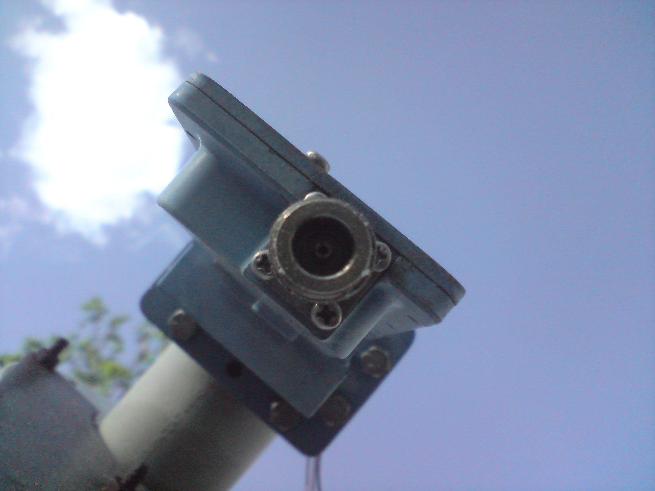

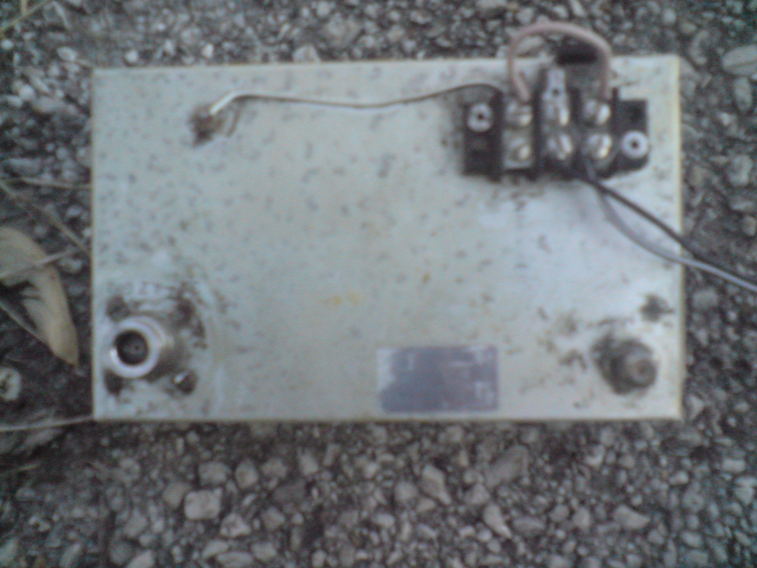

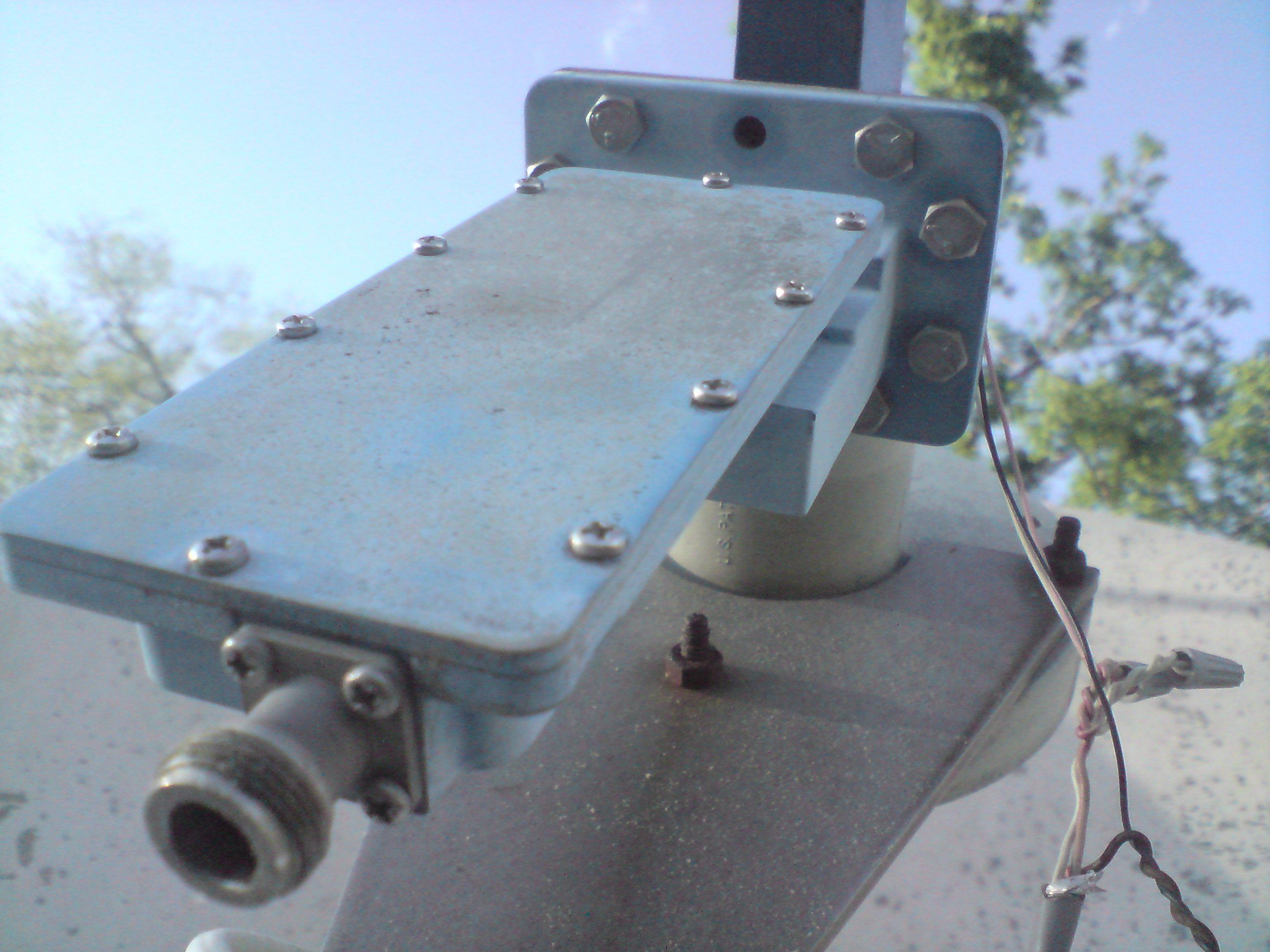

i posted picture of the back of my dish ,when i tried to connect the old LNB i got nothing ,i even used the old receiver ,one thing which i do not understand is that the output port of the old LNB (bleu on the picture ) is bigger than than normal LNB cable

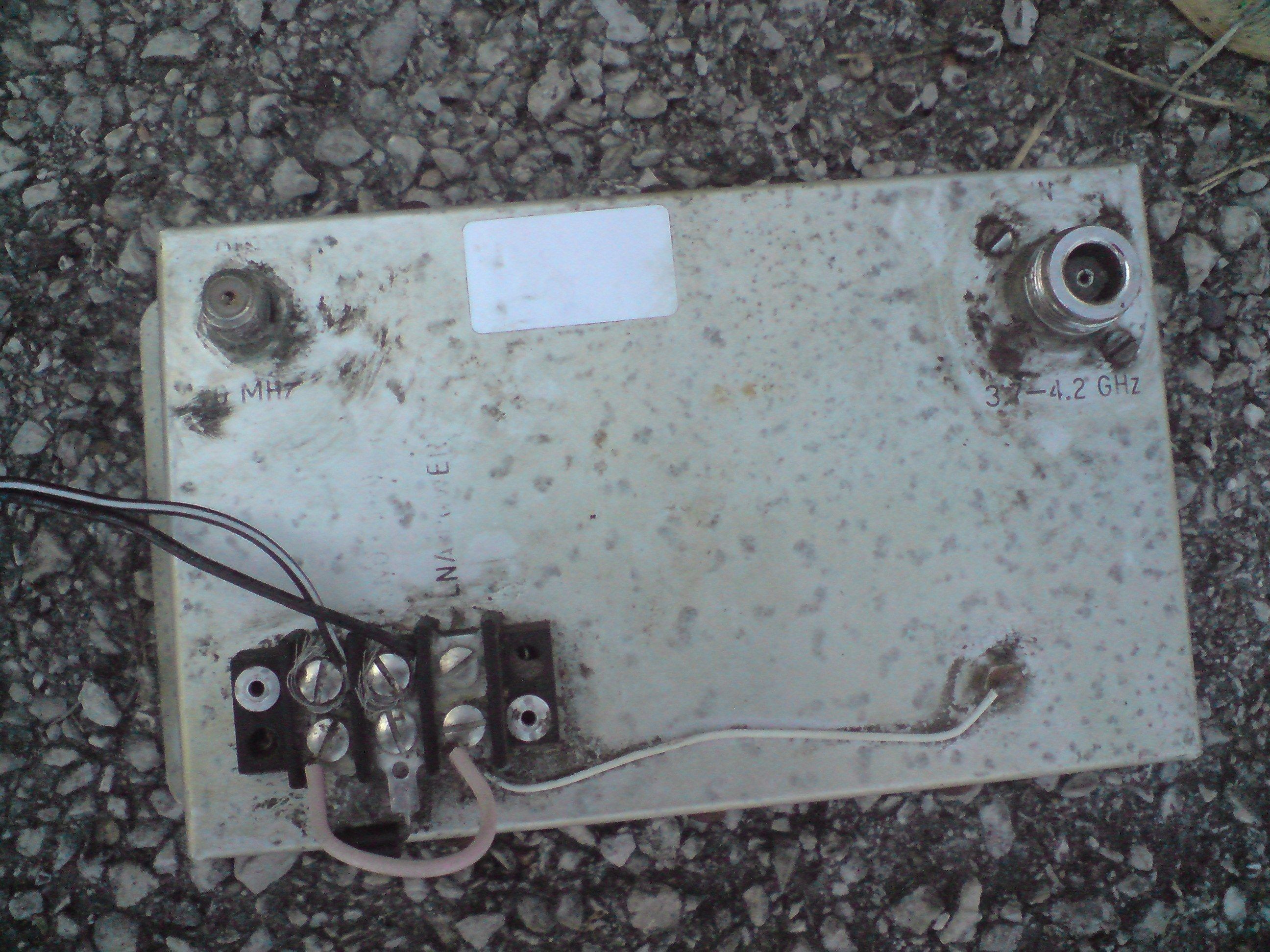

i posted the picture of a circuit that used to receive the out put of the old LNB it is written (3.7 to 4.2 GHZ at the LNB input and 3.7MHZ at the coax output )
what is the normal output of a C band output signal frequency? ),

OMG - that's not an LNB, it's an C band LNA (low noise amplifier). Not worth leaving up there. I'd replace it with a C band LNBF and be 'dun wit it'. There's a heck of a good one available today - the Titanium C1PLL . Some cheaper could be a BSC421. (Worked good for me)
FWIW - pic 1 & 4 are the LNC (low noise converter) that takes the 4Ghz from the LNA down to 70Mhz for the old receiver. A single channel at a time. The LNC is also the 'tuner'. Not nowhere compatible with today's 'stuff'.
The outputs of todays LNB's and LNBF's is approximately 940Mhz to 2400Mhz. All channels/transponders are 'on the coax' at once. Tuning is done in the 'box' alone. See the FAQ's LNB L.O. frequency 101

Nice looking dish. Almost 'commercial' looking.

If your LNBF is too close to the dish, it will not get signal "condensed" enough - see the following picture

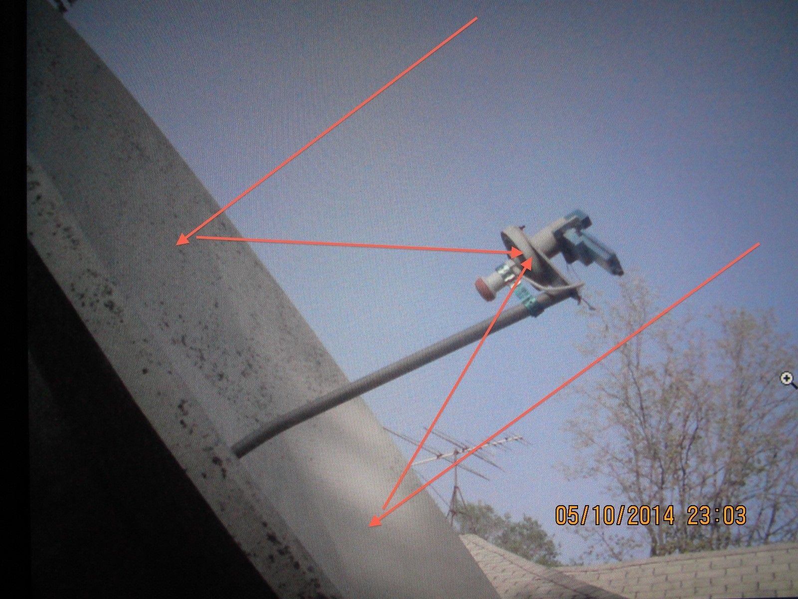

Thanks for all your comments. i got a BSC421 and placed it on my dish , i also got a dish orientation from www.dishpointer.com/ on the picture (word doc 2 attached you can see my dish ) it is a Big dish and the motor does work i will have to figure out how to move it to point in the right direction .View attachment 97482View attachment 97483 you right polgyver my easiest choice will be galaxy 17 or 19 .i hope to get some signal soon .

Check the bearings the dish moves on. Don't want any slop or binding.
The actuator that moves the dish, make sure its also not binding and slop is minimal.
Is this a 'fresh' install, or has the dish been used previously in it's present position?
No? it's been used (skip down to SKEW
Yes? Continue - -
In order to 'how to move it to point in the right direction' I will refer you to some reading that I've put on the web. http://theho.web.fc2.com/BUD/ (Dang, they've cluttered it with adverts, may have to move it)
First step is finding the "Zenith" satellite (or the one closest to your Longitude)
Once you think you have the 'handle' on it. come and question away.
SKEW - IIRR to 'skew' the BSC421 correctly, when the dish is moved to zenith, the '0' alignment mark should be pointed at the east horizon. (horizontal)
