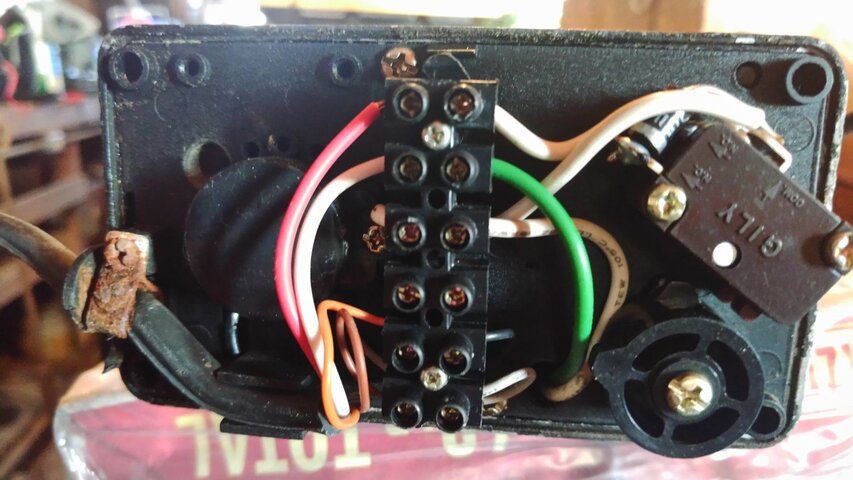

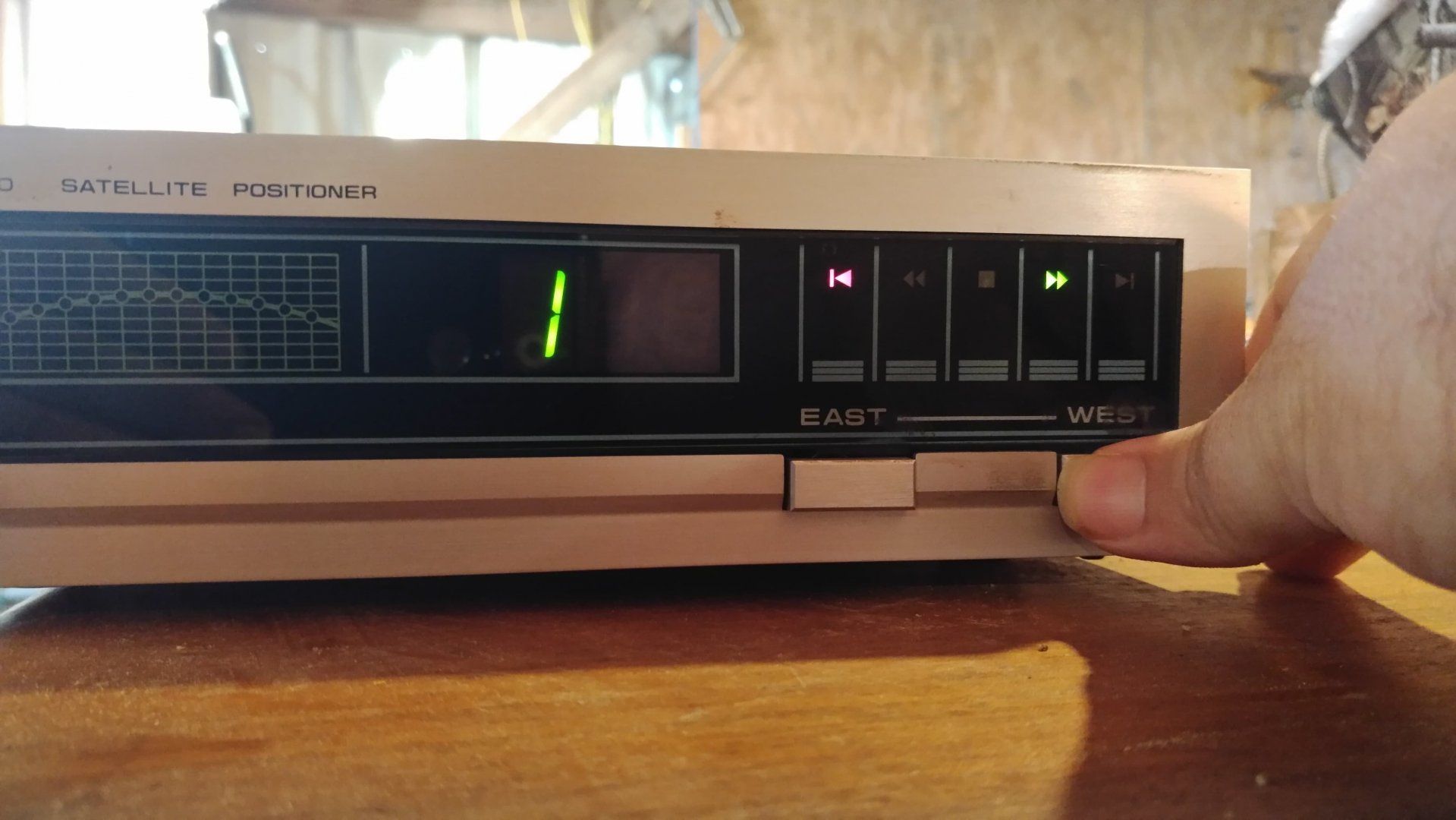

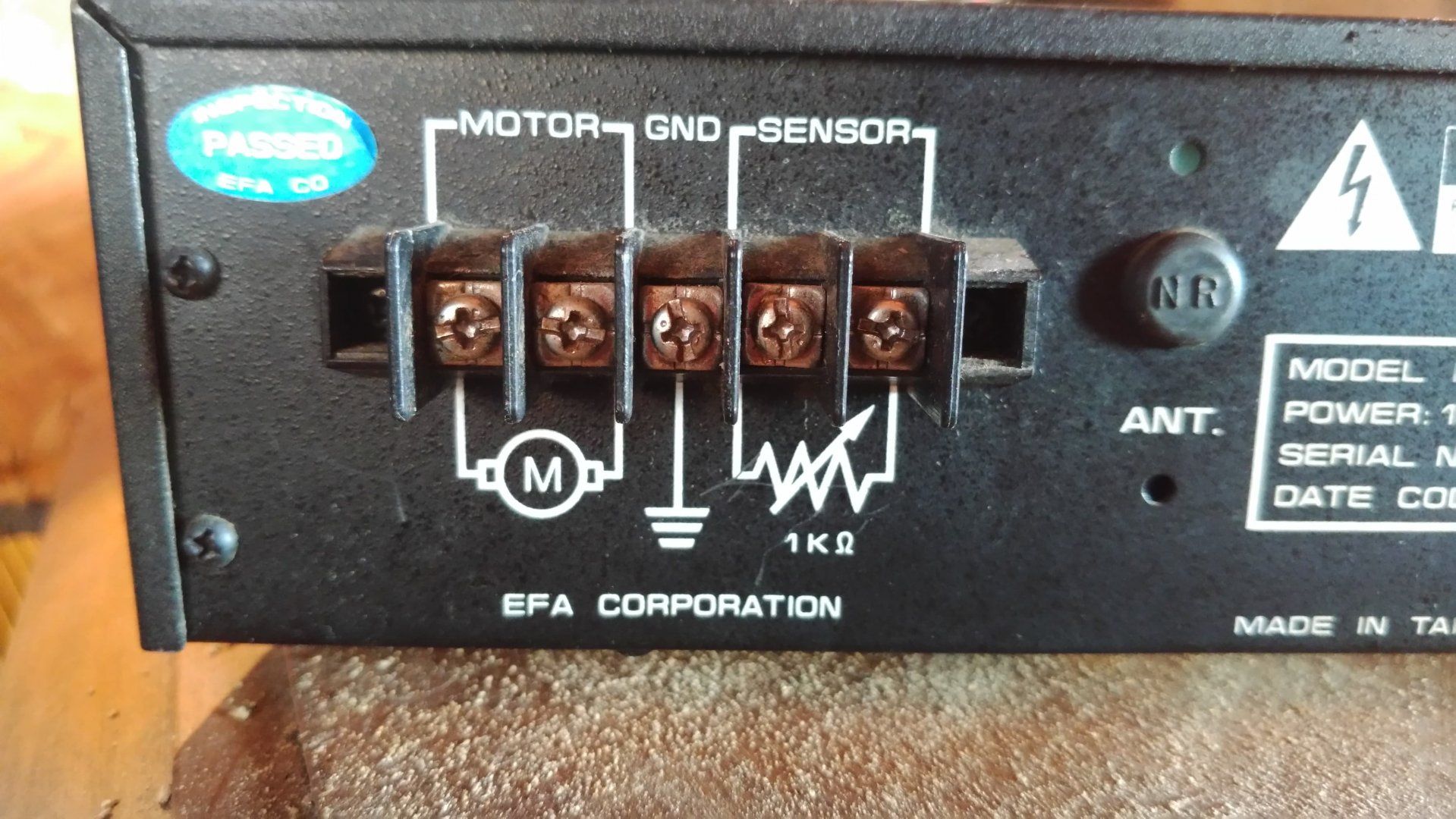

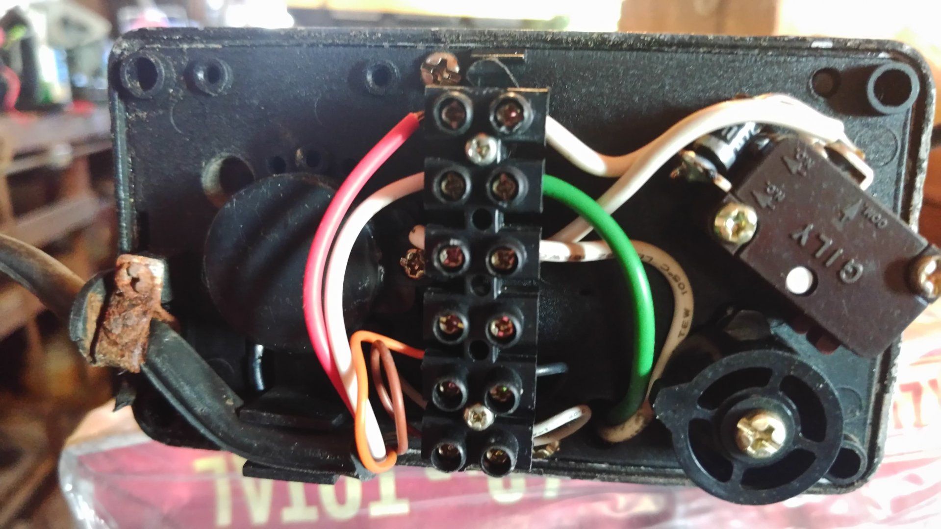

Okay, I ended up scoring 2 ProSat 210s for $45 including shipping. But I think I have the wiring wrong. Or something is bad with my actuator.
I'll post photos, but I did get the actuator to fully extend and fully retract by reversing the motor power wires. I tried to wire the sensor wires both ways but had no luck with getting the mover to pull the arm back in after retracting it (without reversing M1 and M2).
I have not looked much on google for help yet, but I figured someone here could help me faster LOL.
Also, the "West" button is the only button that seems to have power. "East" does nothing when pushed. Same for both units! Makes me think something is just not wired right or the actuator is bad...
Thoughts?

Prosat 210's are for actuator motors with old-school POTENTIOMETER sensors. They won't work with reed switch. I know this for a fact, because I used one years ago. In fact, I still have it, though I can't use it anymore as I don't have available one of the old arms that used it.
You could use it as a straight power supply East or West, but it won't read the counts on reed switch.
Ah, well that's the drawback of old tech. At least both have 30 day returns. I'll keep one just for the 36V for testing.

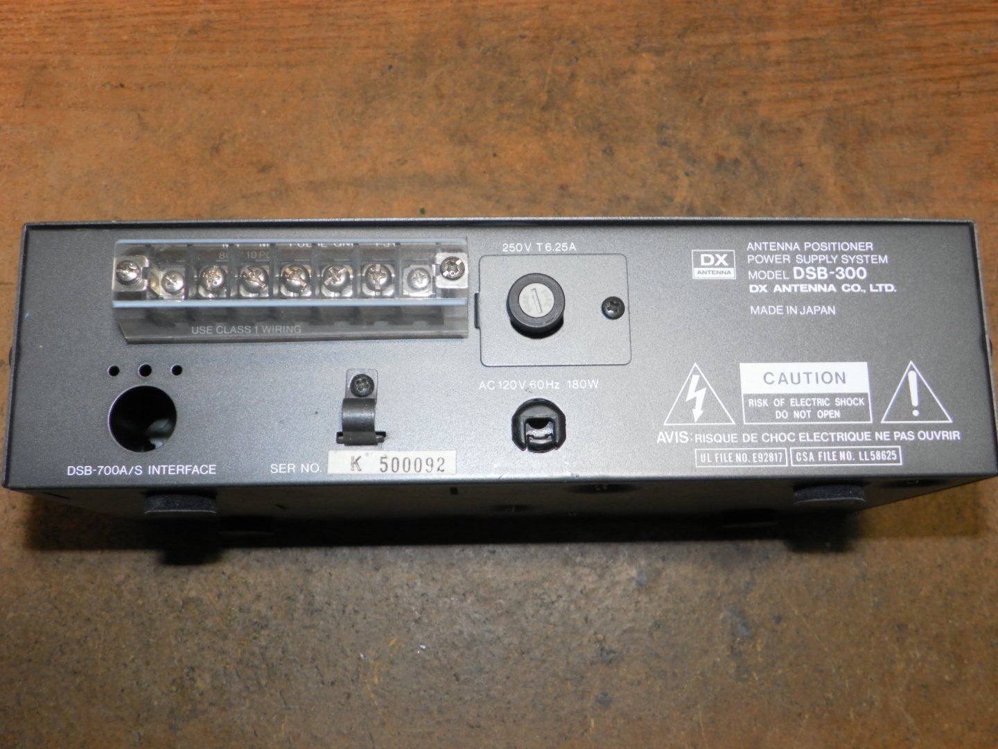

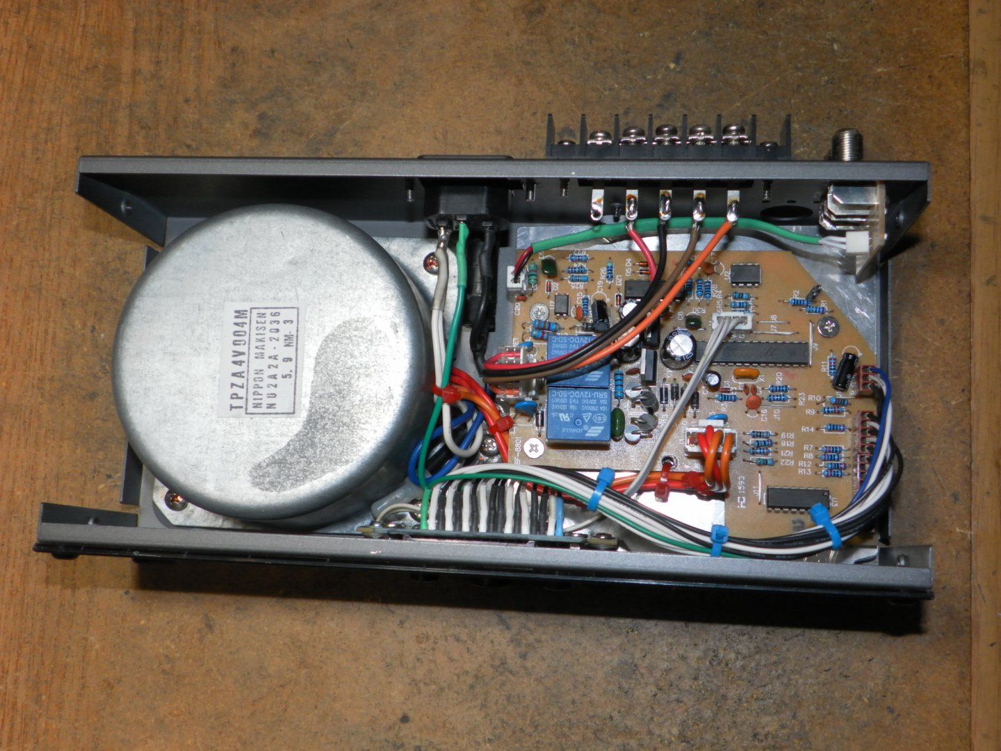

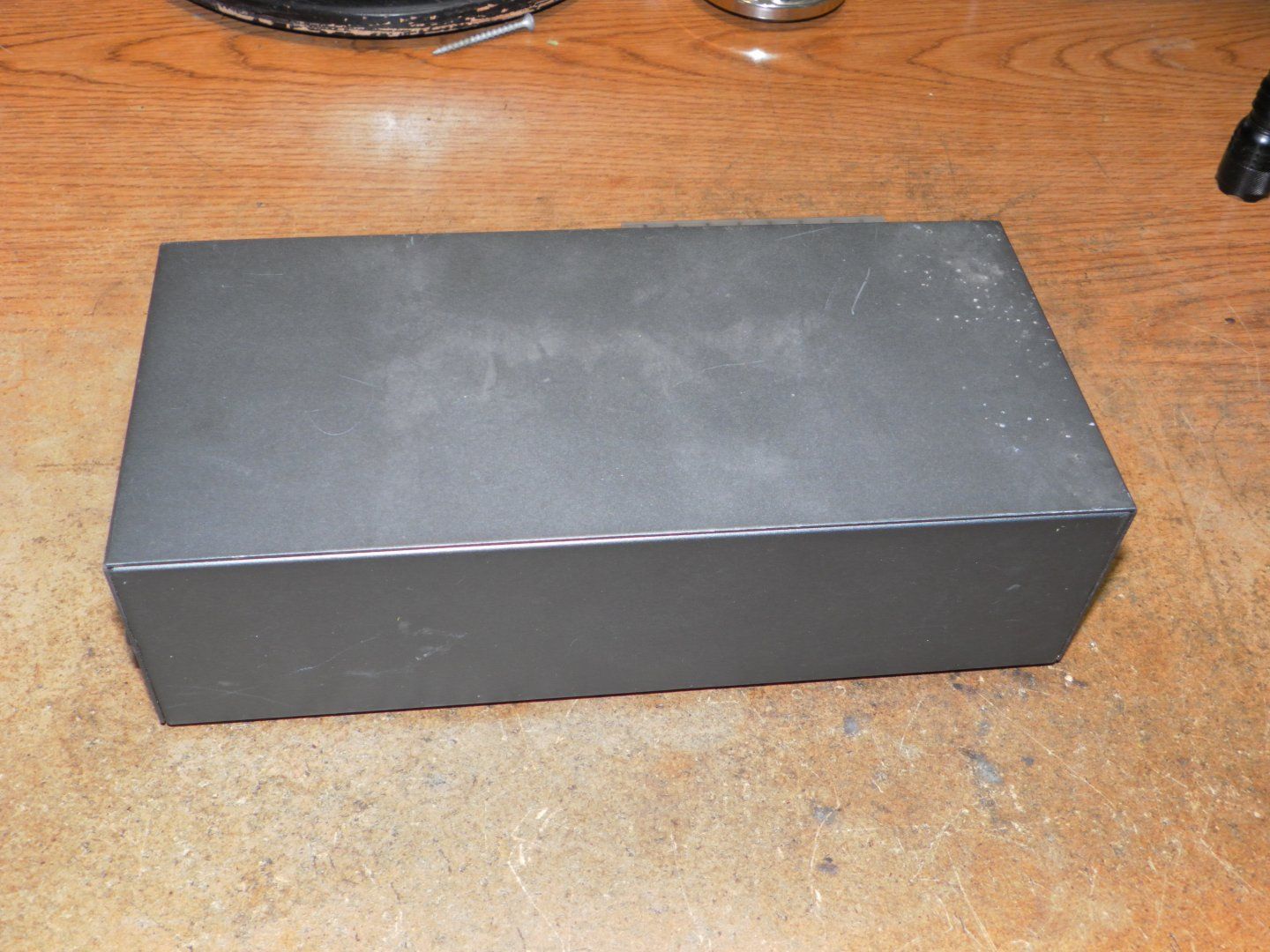

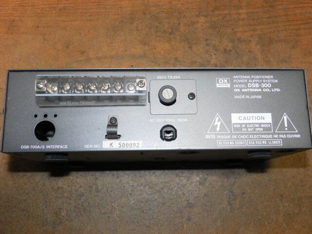

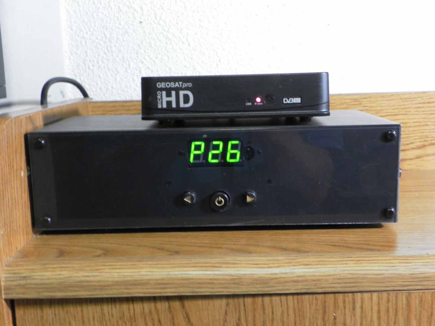

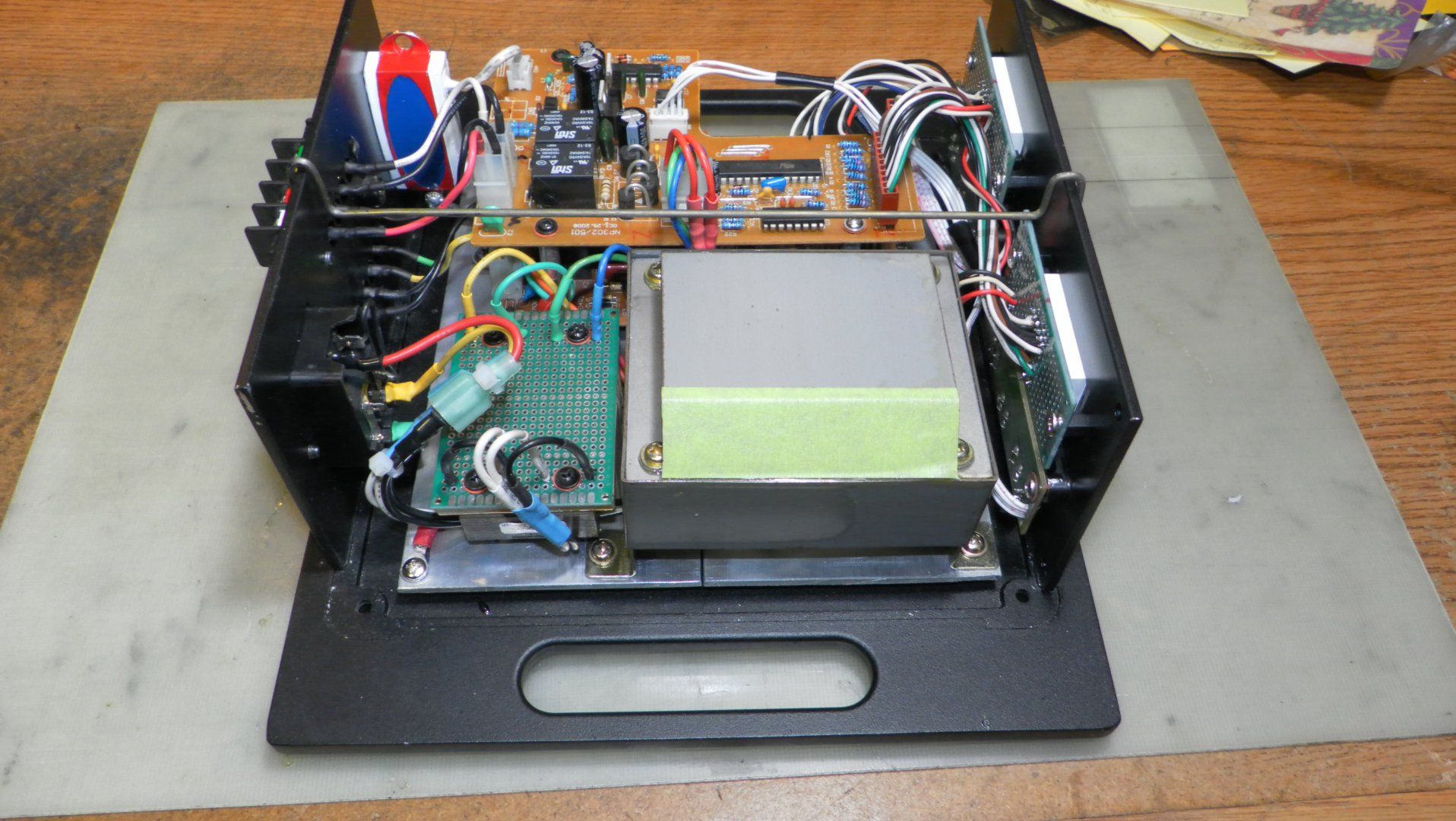

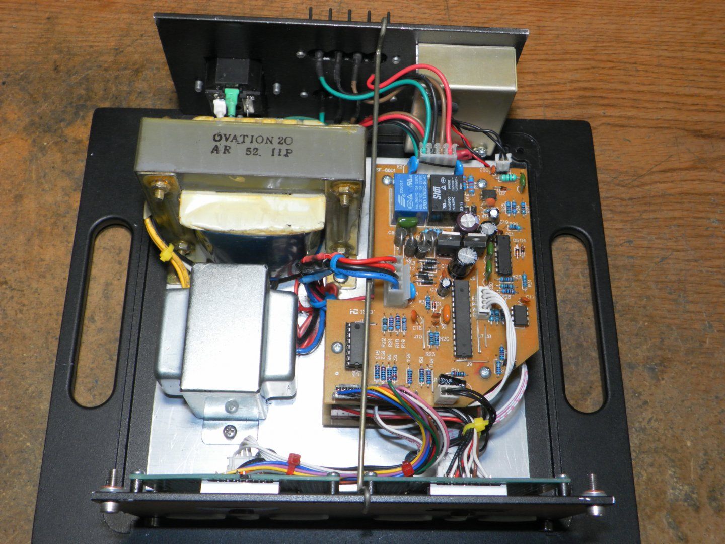

The old tech can still be made useful sometimes. I like to deconstruct and re-purpose the parts for my uses. The old DSR920s are full of useful components for my purposes. I have an old sidecar positioner (DSB300) That I gutted and kept the case and transformer. I dropped a VBox X board , display and buttons into it. It's now a way improved very powerful VBox :) I've used the transformers in the DSR units to power other VBoxes and an ASC1. :)
DSB300 003.JPG DSB300 001.JPG VBP2 012.JPG VBP2 019.JPG VBoxDuo3 001.JPG VBoxDuoB 009.JPG
View attachment 141729 View attachment 141730 View attachment 141731 View attachment 141732 View attachment 141733 View attachment 141734
Great project Magic Static! The sidecar that you used in your project looks exactly like the positioner sidecar for the Uniden UST-9900. I know that I have one of these somewhere, along with a few Drake.
Your project has really got me thinking. There must be many of these old positioner sidecars still out there collecting dust. As you know these old units are built substantially better than any V-Box on the market.
What we need is someone to design an interface, like the V-Box module that you used. Perhaps an Arduino could work. If I was smart enough I would do it. LOL
