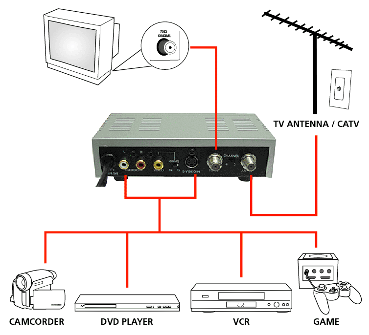

like DR.PEPPER mention, just get a regular RF modulator....
looks like this from behind:

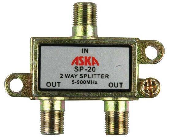

SPLITTER: looks like this...cable to home distribution and in of the splitter and 1 out to your tv1 and other out to your tv2

when you use a RF modulator you dont need to go into the dish menu....just plug the RCA/composite cables in to the video 1 port of the receiver and to the modulator and then coax cable from the modulator to the tv..
