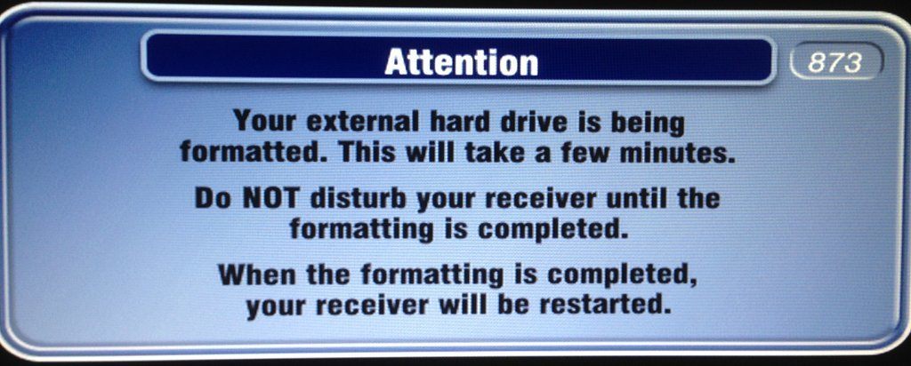

I found some old disks that have stuff on them from an old PC and popped them into the docks. The tuner popped up a box and said the disk wasn't formatted and asked me if I wanted to format it.
I said no and ejected the disks. So it sees other disks but the one with all my stuff on it, is dead.

I put a disk that I KNOW is bad, it was in my security camera PVR and it failed last month and I had to replace it so I know for 100% certain that it's bad. But the minute I popped it in the tuner saw it and asked me if I wanted to format it. I went ahead and told it yes. I figure it will flag a lot of it as bad and that's fine, I just need to be able to have a decent 10 day guide and pause, rewind ability until I can order a new replacement disk in a few weeks along with the PVR recorder gadget. It's a get by for now.
So it's painfully obvious that the tuner killed the other disk and I've lost ALL those recordings. I'm very unhappy about that.... :mad:
