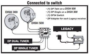

I rooting around the Dish website it appears that I need to run two cables to the dual tuner rather than using a single cable with a seperator. See attached JPG
I have a single Dish with 3 LNB's into a DP34 switch. I do not have dual dishes as shown in the picture however.

With the DP 34 switch you MUST run two cables from the switch to the 222.
Only with Dish Pro Plus (DPP34 or DPP44) can the switch band stack the signal and use one wire and the seperator.
That was the problem -
That was the problem and I am now a happy camper with fully functional VIP222K!
