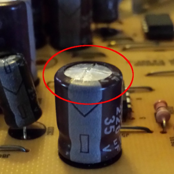

Disconnect the satellite and plug it in, let it sit for 30 min - hour. You should have full menu access. If it reboots over and over, you probably have bad capacitors. Open the cover and look for bulging caps.
