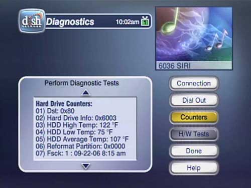

You can check the Hard drive's temperatures and that usually gives you an indication if the receiver is running hot.
Menu, 3, 1, Counters, Page Down 3 times.

"You can check the Hard drive's temperatures"
From the pic it seems as if it give high low and average.
What about the current temperature?
What should my temp be around?

That's correct, it won't give you the current temperature but it gives you an idea of how hot your receiver is running inside.
As far as average temperatures, check this thread and see what others are getting. Very long thread but you can get an idea of what others are getting.
