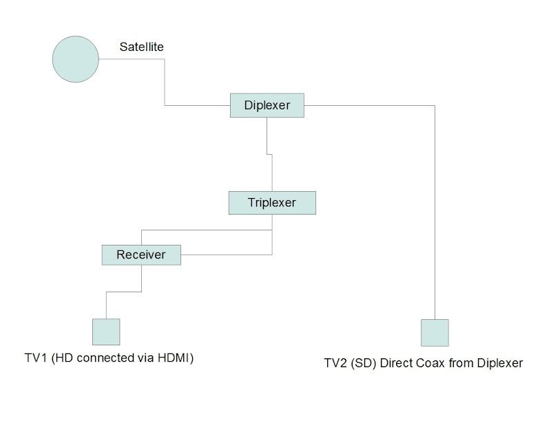

Below I've linked an image of the I/O wiring.
Top single coax is a dedicated line from my ISP for cable internet. Completely separate.
Bottom Splitter is wired as followed:
Left = Output to the ViP722k Receiver
Right Top = Input from Dish/Satellite
Right Bottom = Output to TV 2 (SD)
All cable is like new (1 year old max)
All splitters are new.

There is 1 Blue Diplexer that is at the beginning of the topology. (Photo 1)
Then right next to the receiver is a 4 port (1 IN\ 2 Sat Out \ 1 Antenna Out) **I'll get a picture of that too**
The 2 Sat Outs go to the receiver with a spare Antenna coax not connected to anything.
TV2 is 1 cable from the Diplexer to the TV. (Bottom right coax in the photo above)

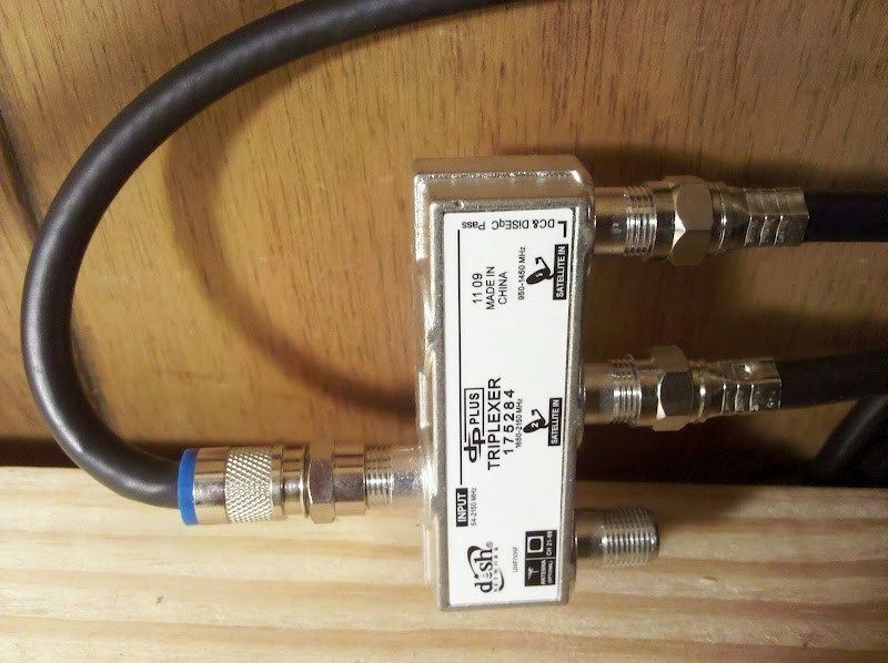

Ok here is the Triplexer:
This device is in a closet right next to the receiver.
1 input from the Dish \ 2 outputs to the receiver.
A simple drawing of the topology:
*There are no other splitters in the house, all coax to the bedrooms run directly to the cable entrance, all dedicated home runs.
**Nothing is connected to the Home Distribution Port.
well, sounds like its not hooked up right then. if the diplexer's uhf port outside does in fact lead to your tv2, then its not going to work unless you run a cable line from the uhf port on the triplexer behind receiver to the uhf (tv2) port on the receiver. i thought you had said tv2 was direct from the receiver. its one or the other, either it runs from the diplexer outside or from the receiver. so, hook up the triplexer correctly to the receibver using all ports and then follow my initial steps on my first comment and it should work.

I've tried my best to show that TV2 is plugged directly into the 1st Diplexer so if something was confusing I apologize.
So if I'm understanding this correctly I can leave the setup as is and simply (Hookup a coax from the UHF port of the Triplexer to UHF (tv2) port on the receiver" run the channel scan on TV2 and I should be functioning?
As harshness said, there is the issue. TV2 signal comes out of the Home Distribution port on the receiver. Connect the Home Distribution to the open connection on the triplexer, and you should be good to go.
Just wanted to followup with a 10-4 on TV2 functionality. Happy to report it was a simple plug and play as suggested.
