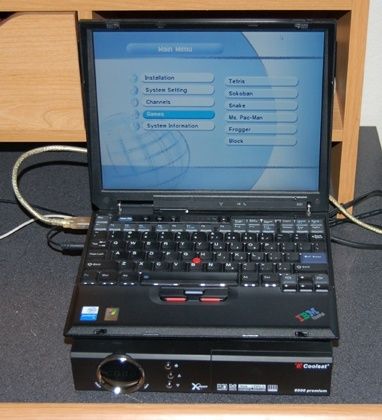

I use a laptop at the dish with a cheap USB TV tuner and the receiver out at the dish.
It works great :).
I also have a USB DVB box - these REALLY suck to aim a dish with.

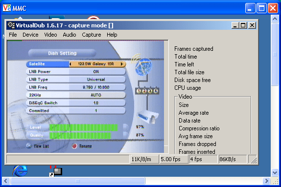

Success - proof of concept anyway
Here's what I did for anyone that is interested:
VirtualDub 1.6.17
File... Capture AVI...
Video... Preview mode...
Adjust settings for frame rate etc, 5 f/s does not seem too bad.
Once I get more than 100 feet from the house however the signal dies on me. That, however, is a separate issue.
