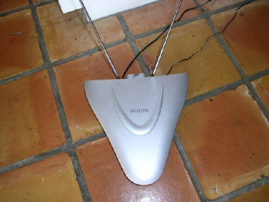

I just got this Phillips antenna for $35.00 at W-Mart. It does a great job. Blew the doors off my $3.00 rabbit ears. :cool:
