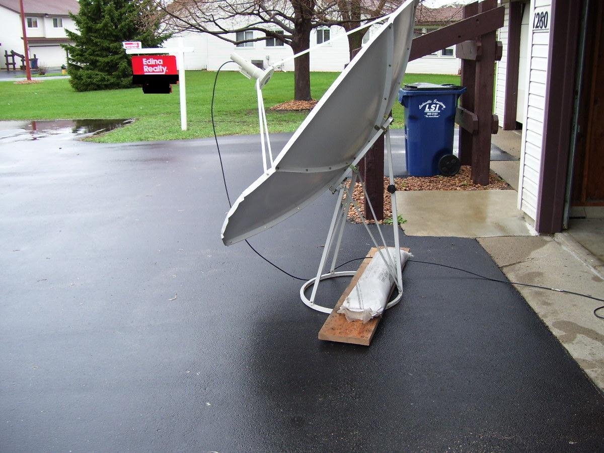

yes it will. I have 2 of these and one is fixed at 99W and the other I "ghetto move" to various satellites. I can get all the way over to 139W which for me in Minnesota is a 21 elevation and its a good 6 inches higher than the ground. My highest satellite elevation (due to my further north location) is only 38 degrees whereas 91W for you is around 45 so it will work fine
Here is a pic of the ghetto moved one at around 38 degrees elevation
