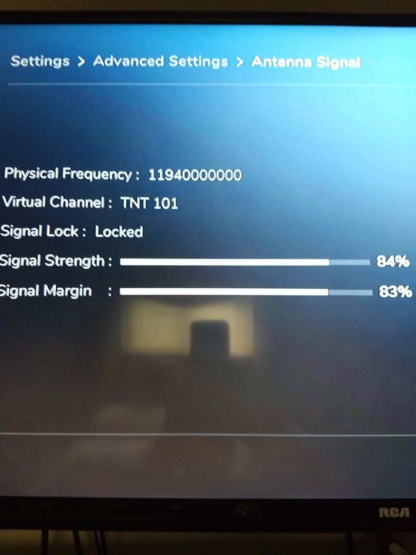

I've done 4 in central Ohio and all were around sq88 ss85... That's really strange..It just sounds like your a hair off..I even notice one I did wasn't very plum but still has great signal

I also, have done a few and the signal is very strong and pops in really easy.

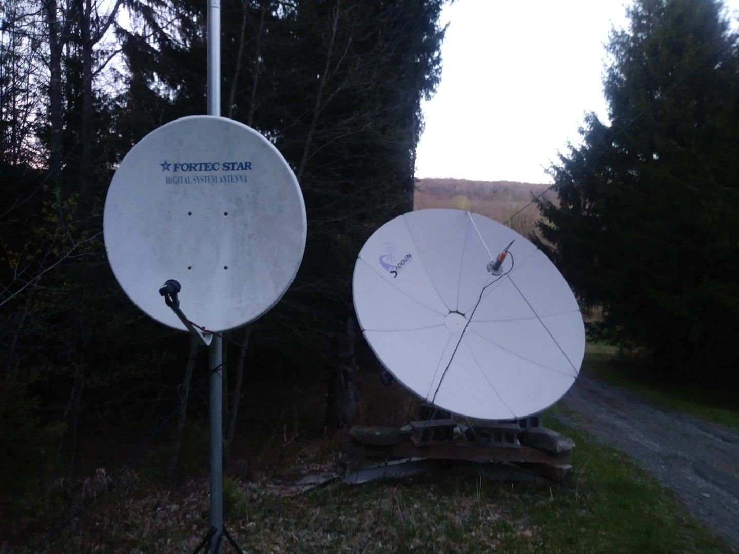

hello dozrdave im about 2hrs south east of you near hamden / walton area
i don't have a orby dish to test signals but using a old fortec 90cm ku band dish.these are my signals hope this somewhat helps.

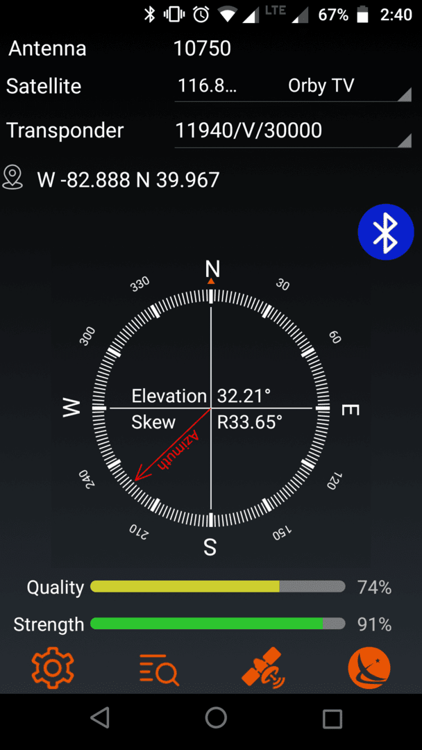

I just got back from replacing my mom's lnb on her Orby dish that a tree limb broke in storm.. replaced the LNB with extra I had...Realigned the dish and got a SQ 77 and SS 94 using BT meter with only 3ft coax at the dish.Checked the receiver and had SQ 89 SS 84.. about 75ft coax with the diplexer at dish..
Just for testing purposes I also played with the skew to see if it makes any changes.. Setting for the location is 33.7..I slowly moved it all the way to 0 and had no difference.. Checked both transponders and no change.
Thank you for the info. Unfortunately since you are not using the Orby supplied dish, it is difficult to relate your readings to mine. The fact that you are using a larger dish in itself may result in the better signal quality reading.

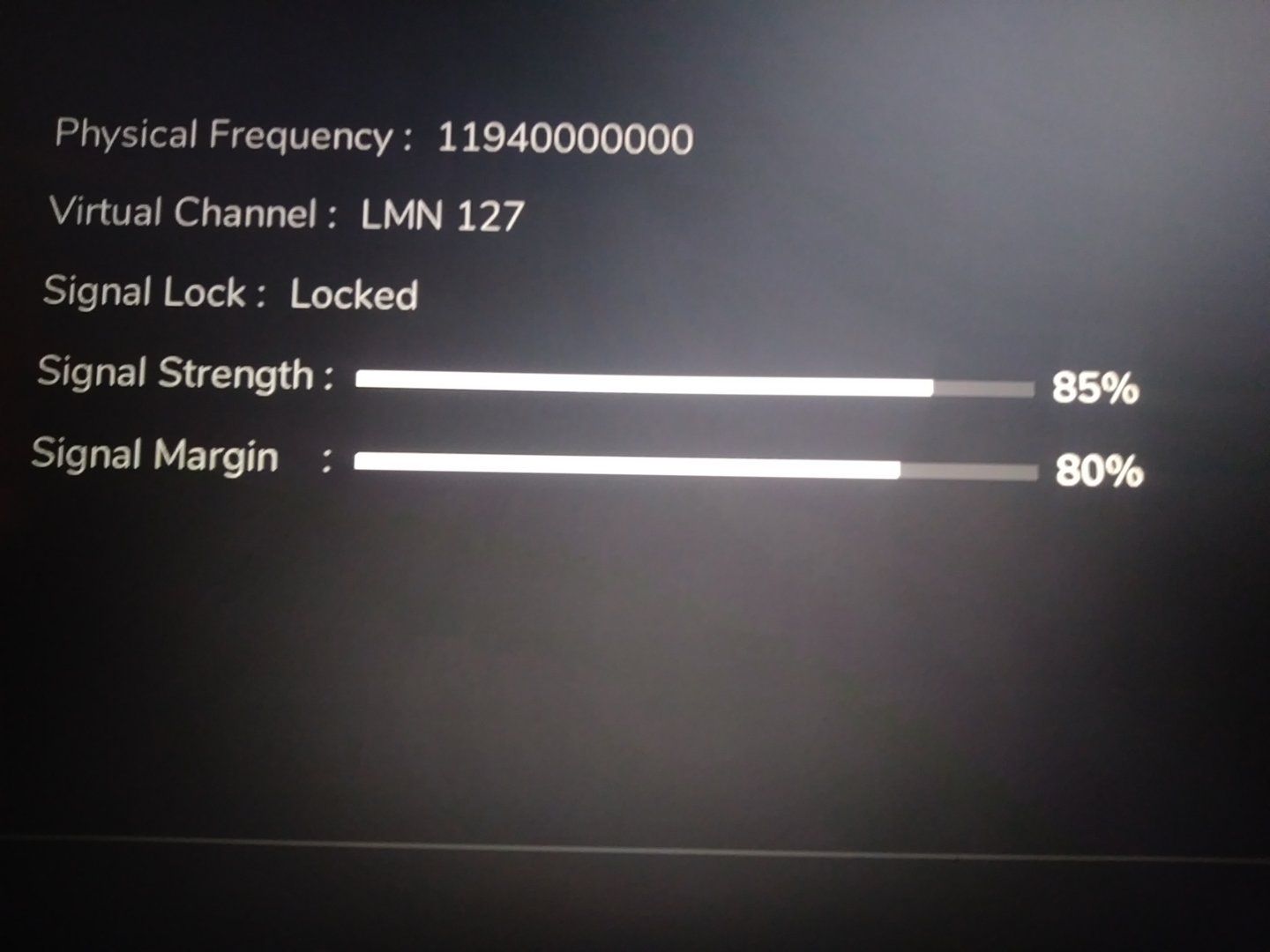

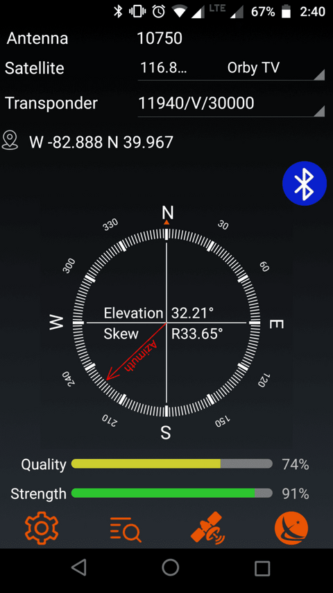

Here's readings using BT3 meter again..I posted earlier the difference at my mom's.This is at my house using Orby dish... Cloudy rainy day..The BT3 seems to be about 10 low on SQ on the 2 different systems I've checked.. which is just the opposite of what your getting
