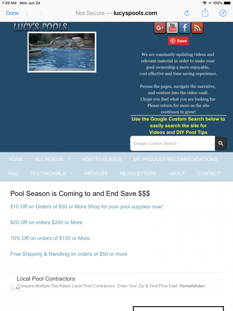

Still does not work in private mode. I will see if Spectrum Cable can fix issue before I try a public DNS. Attached is what I get.

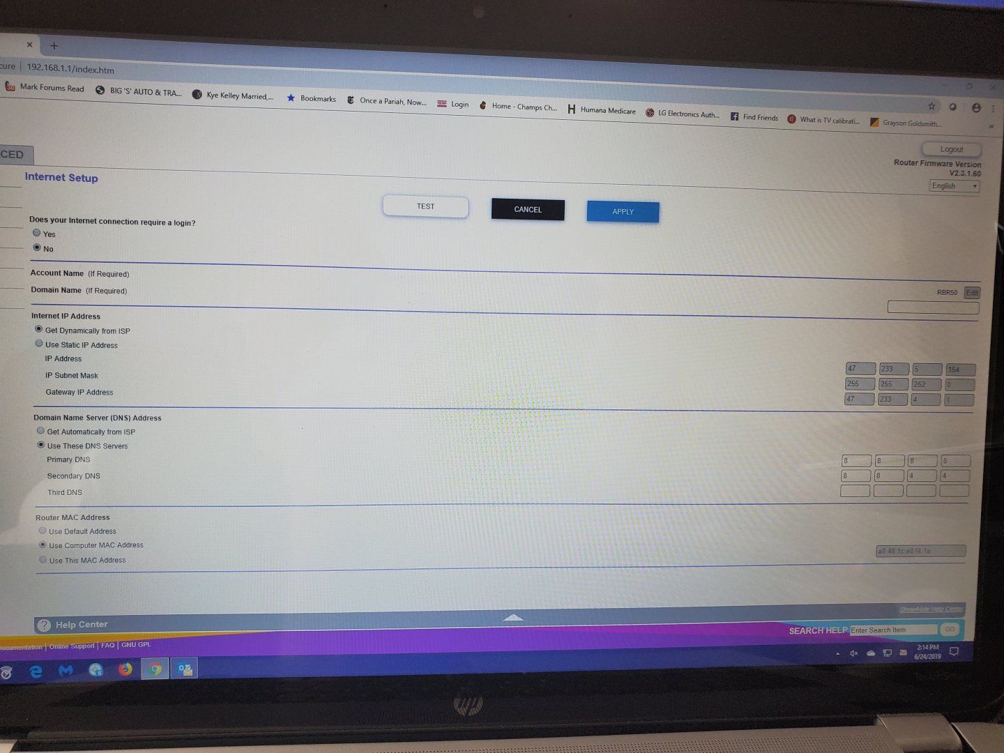

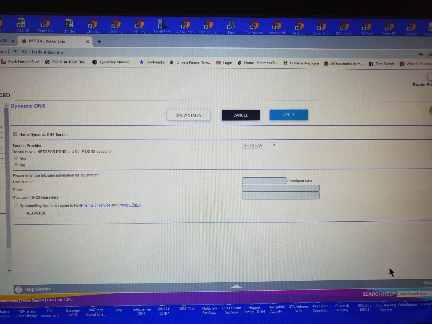

I don't fully understand setting up Google DNS. See pic. Do you really think this is a DNS issue? Do you think I should call Netgear? Router is still fairly new.
That's not the section. That is a very different input that allows you to contact your router wherever you are without knowing what the IP address is.

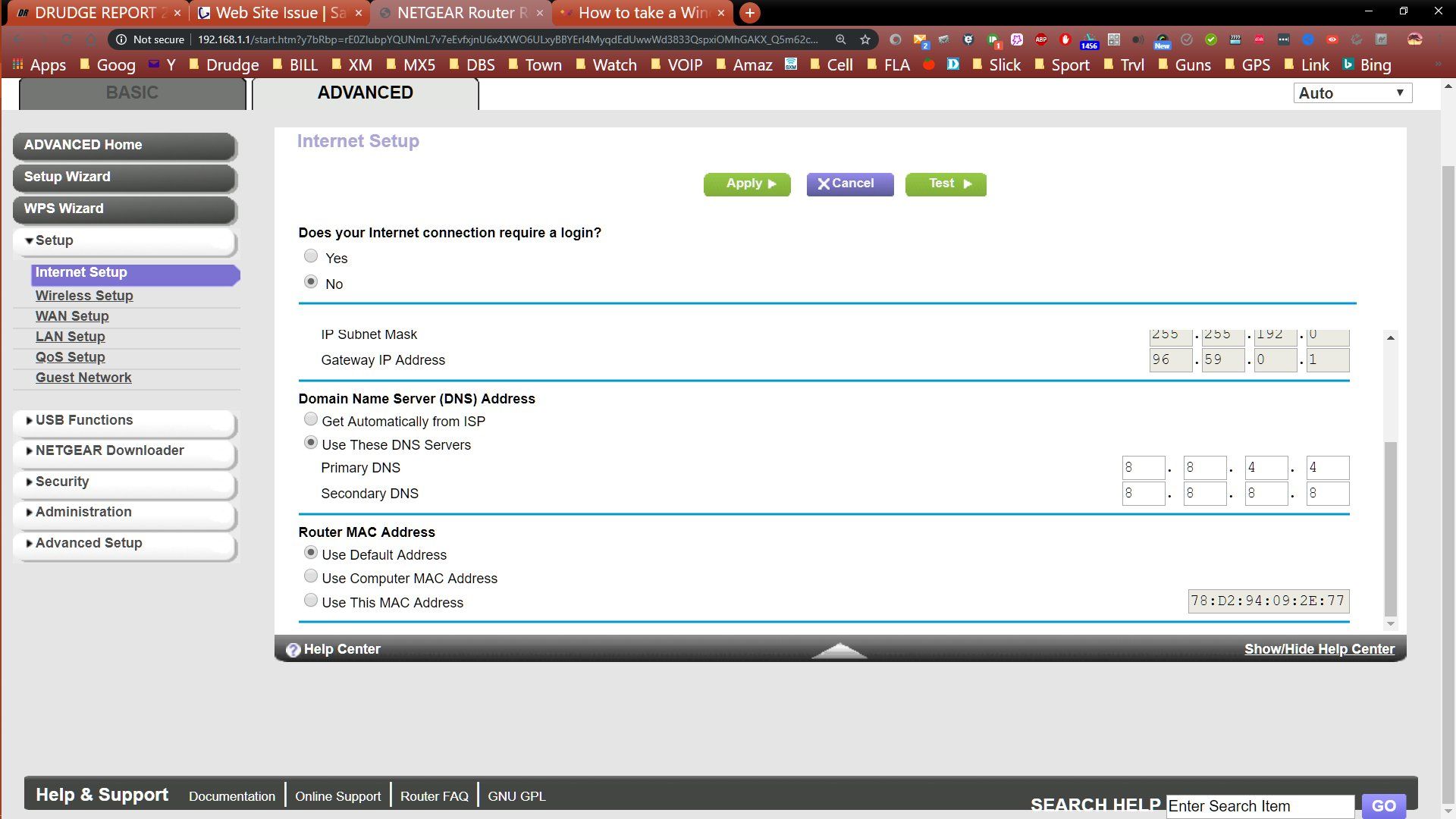

I don't know anything about them so I won't have much to help if that is indeed the problem. I will post a pic however what you should be looking for in the router to change if you want to try.
Doesn't matter which order all 8's or the 8 8 4 4 can go first. It's worth trying rather than resetting the whole system as the link says you may need to do, and then maybe it still won't fix it. In your case changing this setting may not work if it's the Orbi system that is the problem but won't hurt and you can go back easily by re-picking get it automatically from the ISP. Going back to that does not require inputting anything it will be filled in automatically so very easy to go back to it.
OK, thanks Tampa8. I just got off the phone with Netgear Orbi department. First we went in to the page you posted and changed the DNS addresses. Still had issue so she had me select Use Computer MAC address in the Router MAC Address section, rebooted modem and router and that fixed it. I didn't really understand what she said the issue was but it had something to do with cloning the MAC Address. See pic for what everything is set at now. So do you understand what this here cloning the MAC Address is all about? Thanks to everyone who tried to help me.
Hmm. That isn't usually what would be used it normally is default. It can often happen when there are too many "bridges" to the router with different MAC addresses which makes me think ORBI is to blame. By picking to use the Computer MAC it now sees only one. As long as it works no problem. If you find you can't reach sites again try going back to using the Default MAC.

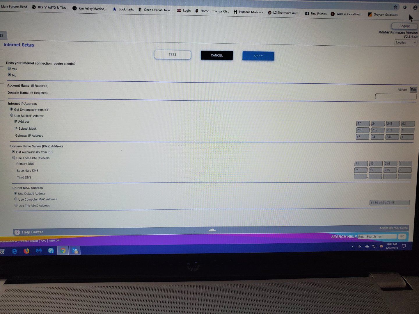

UPDATE: Yesterday I tried out my Ring security cameras on my TV thru Alexia and they didn't work. They use to work as of about two weeks ago. So I called Amazon Alexia help department and was on the phone with them for about a total of 1.5 hours. Nothing worked so he asked if I did any router setting changes lately. He had me reset the DNS Address from the Google settings to Get Automatically from ISP and the cameras still didn't work. So he has escalated the issue to higher tech folks and suppose to call me back within three business days.
I tried out the Lucys Pools — Swimming Pool Tips Las Vegas site and it still worked. So this morning I also changed back the Router MAC Address to Use Default Address, Lucys Pools — Swimming Pool Tips Las Vegas site still worked. Cameras still do not work. So I have kept all the settings in my router which are the same as before I started having the Lucys Pools — Swimming Pool Tips Las Vegas web site issue. Go figure.
